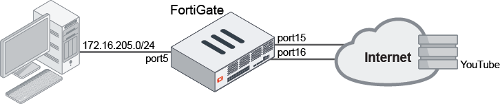

In this example, the FortiGate is configured to load-balance between two WAN interfaces, port15 and port16. A health check is configured in passive mode, and SLA thresholds are set. Passive WAN health measurement is enabled on the SD-WAN policy.
Measurements are taken from YouTube traffic generated by the PC. When latency is introduced to the traffic on port15, the passive health check trigger threshold is exceeded and traffic is rerouted to port16.

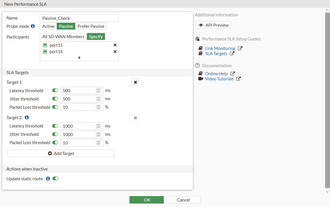

  3. Create a performance SLA:
    1. Go to Network > SD-WAN and select the Performance SLAs tab.
    2. Edit an existing health check, or create a new one.
    3. Set Probe mode to Passive.
    4. Set Participants to Specify and add port15 and port16.
    5. Configure two SLA targets. Note that the second SLA target must be configured in the CLI.
    6. Configure the remaining settings as needed.
    7. Click OK.
      The SLA list shows the probe mode in the Detect Server column, if the probe mode is passive or prefer passive.
      Tooltip
      Probe packets can only be disabled in the CLI and when the probe mode is not passive.
