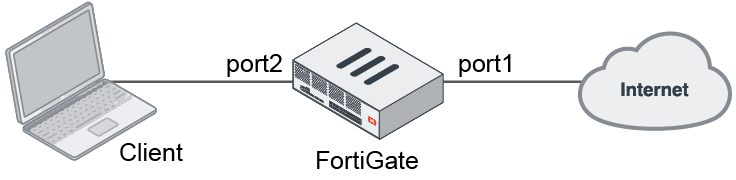

In the following example, a new video filter profile is created to block the Knowledge category.
In the firewall policy settings, the default application control profile is recommended because it blocks QUIC traffic. Many Google services use the QUIC protocol on UDP/443. By blocking QUIC, YouTube will use standard HTTPS TCP/443 connections. |

- Create the firewall policy:
- Enter the following:
Incoming Interface
port2
Outgoing Interface
port1
Source
All
Destination
All
Service
All
Inspection Mode
Proxy-based
NAT
Enable
Video Filter
Enable and select category_filter
Application Control
Enable and select default
SSL Inspection
deep-inspection
Log Allowed Traffic
All Sessions
- Configure the other settings as needed and click OK.
