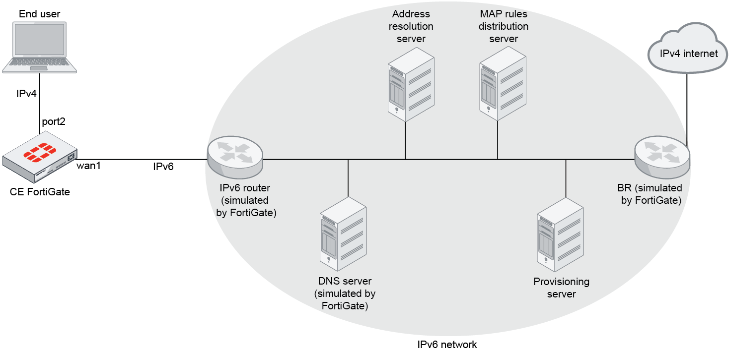

On a customer edge (CE) FortiGate, an IPv4-over-IPv6 (MAP-E) tunnel can be created between the FortiGate and the border relay (BR) operating in an IPv6 network. A tunnel interface is created between the FortiGate and BR, which can be applied to firewall policies and IPsec VPN.
To configure a MAP-E tunnel between the FortiGate and the BR:

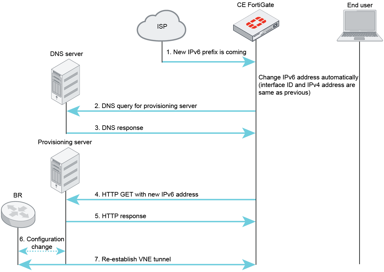

Initial sequence overview of VNE tunnel under fixed IP mode:
Once the IPv6 address of the FortiGate changes, the tunnel will be down because the BR does not know the FortiGate's new IPv6 address. The FortiGate uses
update-urlto update the new IPv6 address to the provisioning server. The provisioning server updates the FortiGate’s IPv6 address to the BR so the VNE tunnel can be re-established.Communication sequence overview of re-establishing VNE tunnel:

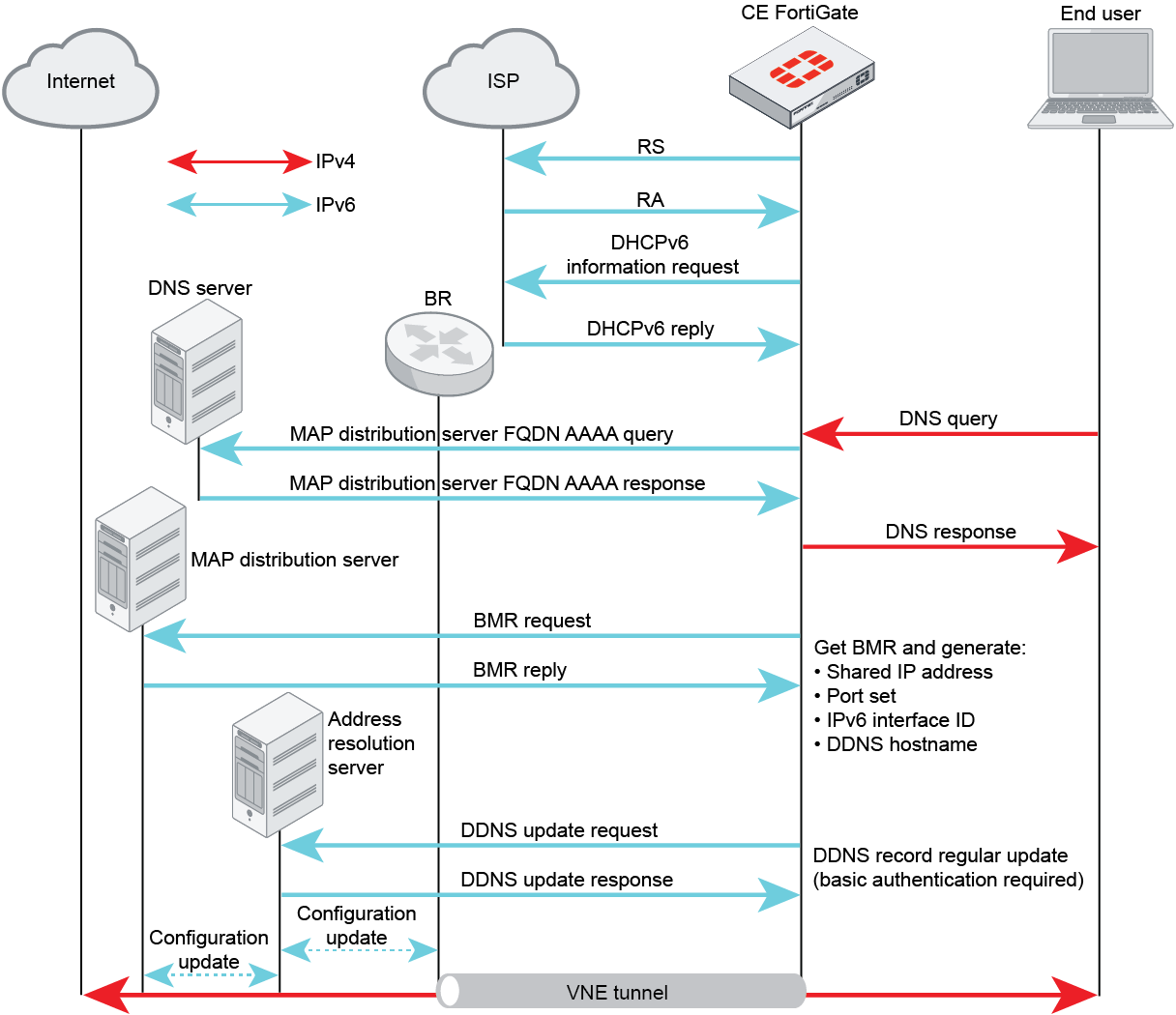

config system vne-tunnel set status enable set interface 'wan1' set ssl-certificate "Fortinet_Factory" set bmr-hostname ******** set auto-asic-offload enable set mode map-e endInitial sequence overview of VNE tunnel under MAP-E mode:
The FortiGate sends a MAP rule request to the MAP distribution server once the IPv6 address is configured on the FortiGate by RS/RA. Next, the FortiGate will send an AAAA query to get the IPv6 address of the MAP distribution server. After sending the BMR request to the MAP distribution server, the FortiGate will get the IPv4 address, port set, BR IPv6 address, and hostname of the address resolution server from the BMR reply. The VNE tunnel between the FortiGate and BR is now established.
The address resolution server is actually a dynamic DNS. The hostname is used for the FortiGate to maintain an IPv6 address when it changes.
The FortiGate updates the DDNS server with its IPv6 address whenever it updates, which in turn provides the update to the MAP distribution server and BR so they know how to resolve the FortiGate by hostname.
