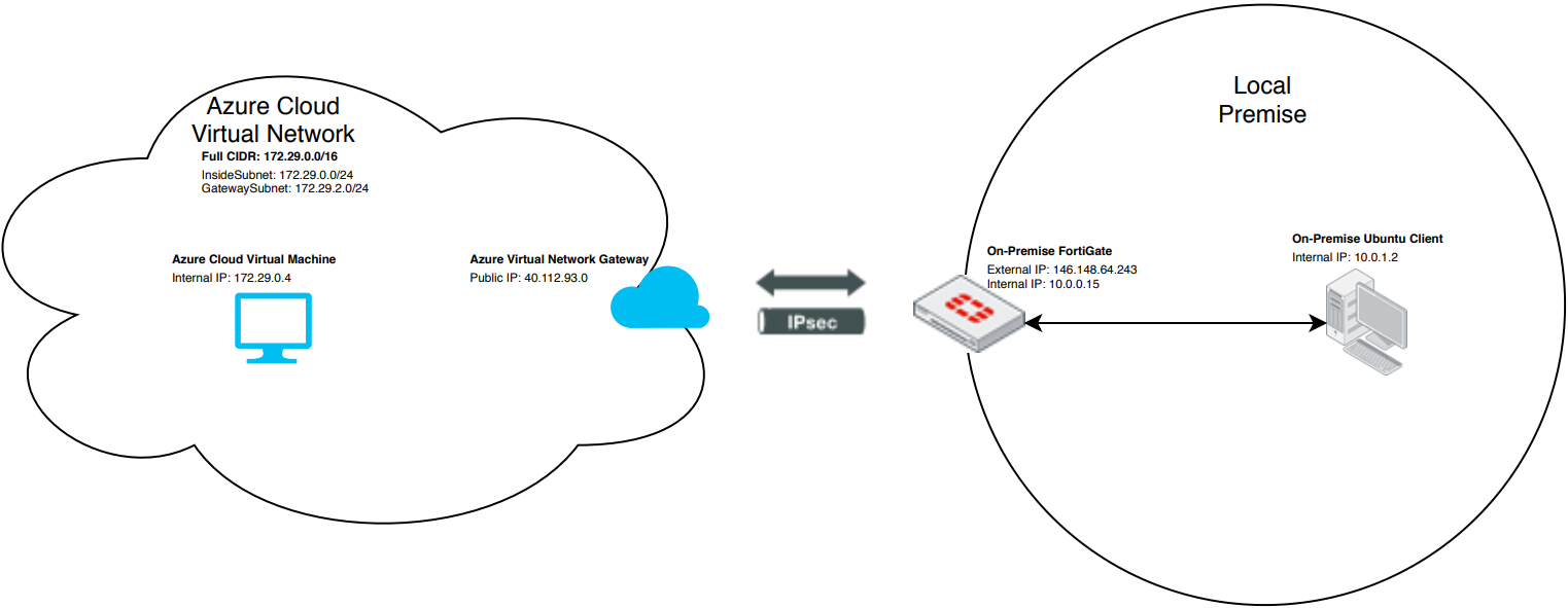

The following demonstrates the topology for this example:

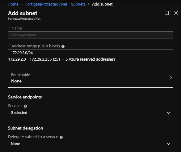

To create a gateway subnet:
A gateway subnet is a subnet in your VNet that contains the IP addresses for the Azure VNet gateway resources and services. Azure requires a gateway subnet for VNet gateways to function.
- In the Azure management console, go to your VNet, then Subnets > + Gateway subnet. You do not need to configure any fields on the Add subnet screen. You cannot change the name, as it must be GatewaySubnet for the VNet gateway to function. Azure should automatically populate the Address range (CIDR block) field with a subnet within your VNet. In this example, the VNet is 172.29.0.0/16, while the subnet is 172.29.2.0/24. You do not need to configure a route table or security group unless your environment needs special handling.

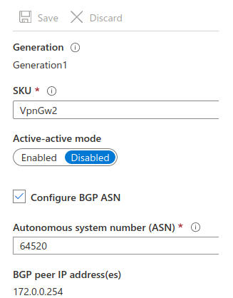

- For VPN type, select Policy-based.
- For SKU, at the time of publishing this guide, you can only select Basic for policy-based VPN.
- From the Virtual network dropdown list, select the desired VNet to connect to. Azure should automatically detect the gateway subnet created earlier.
- Under PUBLIC IP ADDRESS, create a new public IP address or select an existing public IP address for the VPN gateway.
- If desired, configure BGP. The BGP peer IP address is based on the VNet gateway's gateway subnet.

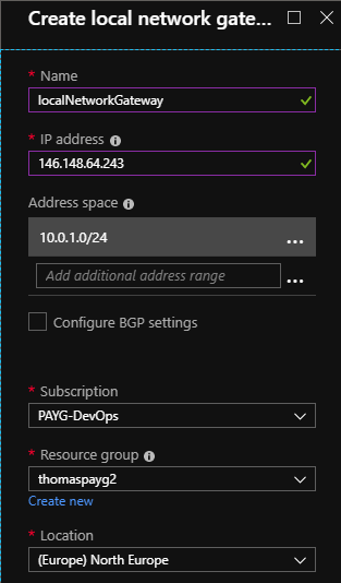

The local gateway refers to your local side of the VPN settings. You can configure a local network gateway to let Azure know your on-premise-side settings.
- Go to Create a resource. Search for Local network gateway. Click Create.
- On the Create local network gateway screen, configure the following:
- In the Name field, enter a name.
- In the IP address field, enter the on-premise FortiGate's external IP address.
- In the Address space field, enter the CIDR of the network behind the on-premise FortiGate that will access the Azure VNet.
- If desired, enable Configure BGP settings. You define the BGP peer IP address for the local network gateway, but there are restrictions. See About BGP with Azure VPN Gateway.
- From the Subscription dropdown list, select the correct subscription.
- From the Resource group dropdown list, select the resource group. This example uses the resource group that the other resources belong to.
- From the Location dropdown list, select the location. This example uses the location that the VNet resides in, but this is not a requirement.

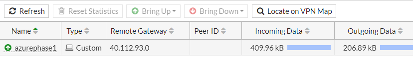

- In FortiOS, go to Monitor > IPsec Monitor to see if the tunnel is up. If it is not up, manually bring up the tunnel.
