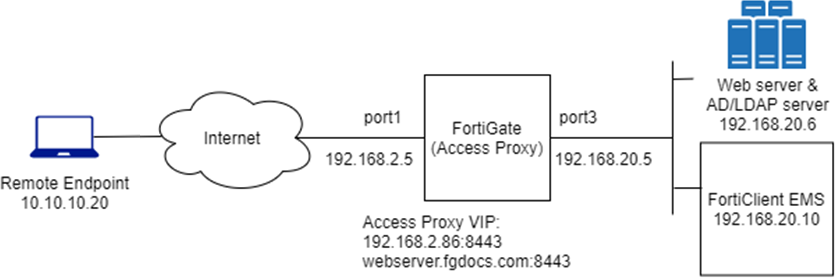

This example expands on the previous example (ZTNA HTTPS access proxy example), adding LDAP authentication to the ZTNA rule. Users are allowed based on passing the client certificate authentication check, user authentication, and security posture check.
Users that are in the AD security group ALLOWED-VPN are allowed access to the access proxy. Users that are not part of this security group are not allowed access.
This example assumes that the FortiGate EMS fabric connector is already successfully connected.

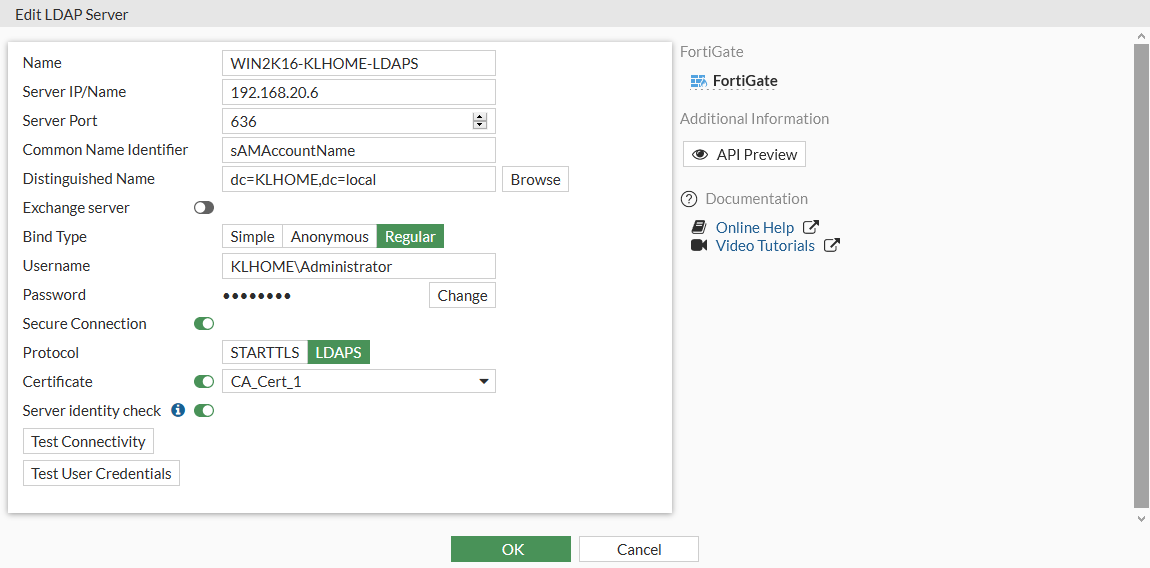

To configure a secure connection to the LDAP server in the GUI:
  1. Go to User & Authentication > LDAP Servers and click Create New.
  2. Configure the following settings:
    Name
    WIN2K16-KLHOME-LDAPS
    Server IP/Name
    192.168.20.6
    Server Port
    636
    Common Name Identifier
    sAMAccountName
    Distinguished Name
    dc=KLHOME,dc=local
    Exchange server
    Disabled
    Bind Type
    Regular
    Enter the Username and Password for LDAP binding and lookup.
    Secure Connection
    Enabled
    • Set Protocol to LDAPS
    • Enable Certificate and select the CA certificate to validate the server certificate.
    Server identity check
    Optionally, enable to verify the domain name or IP address against the server certificate.
  3. Click Test Connectivity to verify the connection to the server.
  4. Click OK.

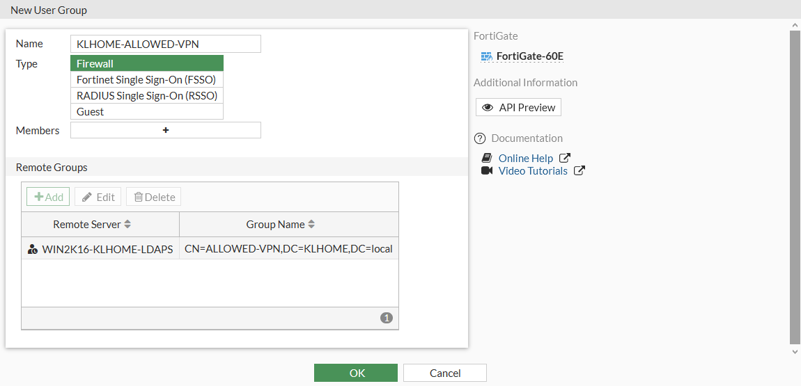

To configure a remote user group from the LDAP server in the GUI:
  1. Go to User & Authentication > User Groups and click Create New.
  2. Set the name to KLHOME-ALLOWED-VPN.
  3. Set Type to Firewall.
  4. In the Remote Groups table click Add:
    1. Set Remote Server to WIN2K16-KLHOME-LDAPS.
    2. Locate the ALLOWED-VPN group, right-click on it, and click Add Selected.
    3. Click OK.
  5. Click OK.
    Name
    Server IP/Name
    192.168.20.6
    Server Port
    636
    sAMAccountName
    Distinguished Name
    dc=KLHOME,dc=local
    Exchange server
    Disabled
    Bind Type
    Regular
    Secure Connection
    Enabled
  4. Click OK.
    3. Click OK.
  5. Click OK.
