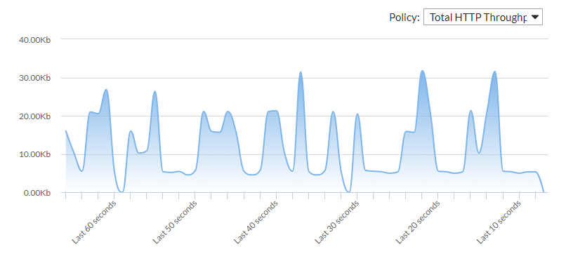

Throughput
The Throughput widget displays HTTP traffic volume throughput in real-time:
Mouse over the graph to see HTTP throughput for the displayed time period.
In the top-right corner of the widget, use the Policy drop-down menu to select either the total HTTP throughput or the HTTP throughput for a specific server policy.

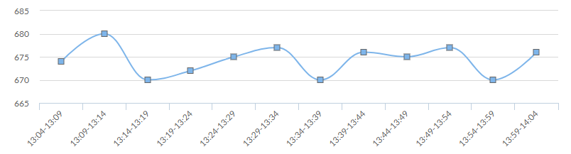

HTTP Transactions
The HTTP Transactions widget displays the total number of HTTP requests within the selected interval:
Mouse over the graph to see HTTP requests for the displayed time period.
Use the Time Interval drop-down menu to select among the following time periods to view HTTP requests:
  • 1 hour
  • 2 hours
  • 5 hours
Use the Policy drop-down menu to select among the current server policies or to view the total HTTP hit history.

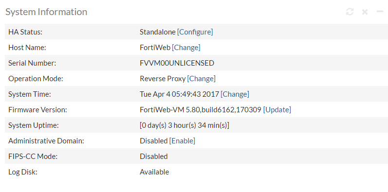

System Information
The System Information widget on the dashboard displays the serial number and the status of basic systems, such as the firmware version, system time, up time, and host name, and high availability (HA) status.
In addition to displaying system information, the System Information widget enables you to configure some basic attributes such as the host name, operation mode, and high availability (HA) mode, and to change the firmware.
FortiWeb administrators whose access profiles permit Write access to items in the System Configuration category, can change the system time, host name, firmware, and operation mode, and high availability (HA) mode.
HA Status
Displays the status of high availability (HA) for this appliance, either Standalone or Active-Passive. The default value is Standalone.
Click Configure to configure the HA status for this appliance. For details, see FortiWeb high availability (HA) .
Host Name
Displays the host name of the FortiWeb appliance.
Click Change to change the host name. For details, see Changing the FortiWeb appliance’s host name.
Serial Number
Displays the serial number of the FortiWeb appliance. Use this number when registering the hardware or virtual appliance with Fortinet Customer Service & Support:
https://support.fortinet.com
On hardware appliance models of FortiWeb, the serial number (e.g. FV-3KC3R11111111) is specific to the FortiWeb appliance’s hardware and does not change with firmware upgrades.
On virtual appliance models, the serial number indicates the maximum number of vCPUs that can be allocated according to the FortiWeb-VM software license, such as FVVM020000003619 (where “VM02” indicates a limit of 2 vCPUs). If it is FVVM00UNLICENSED, the FortiWeb-VM license has not been successfully validated, and FortiWeb is operating with a limited trial license.
Operation Mode
Displays the current operation mode of the FortiWeb appliance.
The default operation mode is Reverse Proxy. For details on the operation modes, see Setting the operation mode.
Click Change to switch the operation mode.
Caution: Back up the configuration before changing the operation mode. Changing modes deletes any policies not applicable to the new mode, static routes, V-zone IPs, and VLANs. For instructions on backing up the configuration, see Backup & restore.
System Time
Displays the current date and time according to the FortiWeb appliance’s internal clock.
Click Change to change the time or configure the FortiWeb appliance to get the time from an NTP server. For details, see Setting the system time & date.
Firmware Version
Displays the version of the firmware currently installed on the FortiWeb appliance.
Click Update to install a new version of firmware. For details, see Updating the firmware.
Note: Starting with the 6.0 release, FortiWeb supports Google Cloud Platform and Oracle VM VirtualBox.
System Uptime Displays the time in days, hours, and minutes since the FortiWeb appliance last started.
Administrative Domain
To delete existing appliance-wide policies and settings then enable ADOMs, click Enable. See also Administrative domains (ADOMs).
To disable ADOMs, first delete ADOM-specific settings and policies, then click Disable.

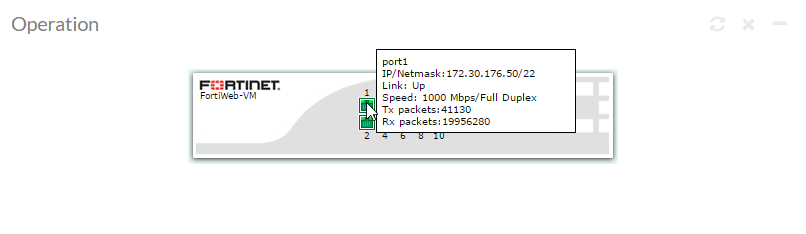

Operation
The Operation widget on the dashboard displays:
  • “Up” (cable plugged in, indicated by green) or
  • “Down” (cable unplugged, indicated by grey)
link status of each physical network interface (or, for FortiWeb-VM, virtual adapter).
The detected physical link status indicator does not indicate whether you have administratively enabled or disabled the network interface. To bring up or bring down a network interface, see To configure a network interface or bridge.
Hover over a link icon to display the following additional information:
  • Name (e.g. port1)
  • Link speed (e.g. 1000 Mbps/Full Duplex)
  • The IP address and subnet mask
  • Packets sent (Tx) and received (Rx)
Operation widget

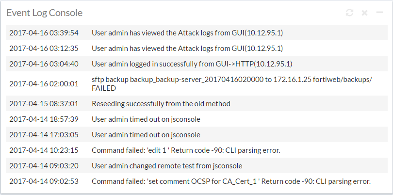

Event Log Console
The Event Log Console widget on the dashboard displays log-based messages.
Event logs help you track system events on your FortiWeb appliance such as firmware changes, and network events such as changes to policies. Each message shows the date and time that the event occurred. For details, see Viewing log messages.
Event log messages can also be delivered by email, Syslog, FortiAnalyzer, or SNMP. For details, see Enabling log types, packet payload retention, & resource shortage alerts, Configuring log destinations, and SNMP traps & queries.

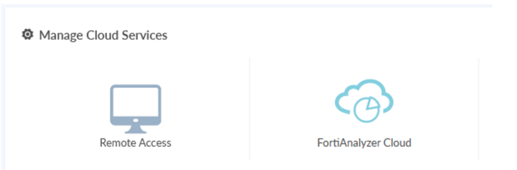

FortiCloud Management
This widget displays whether the FortiCloud account management service is activated. Once activated, it enables remote access to FortiWeb via the FortiCloud Account, as shown in the screenshot.
Refer to this article for how to navigate to Remote Access in FortiCloud Account management service.
Please note that the license for FortiCloud account management should include Remote Access service, otherwise you will only have the read-only permission when remotely accessing FortiWeb.

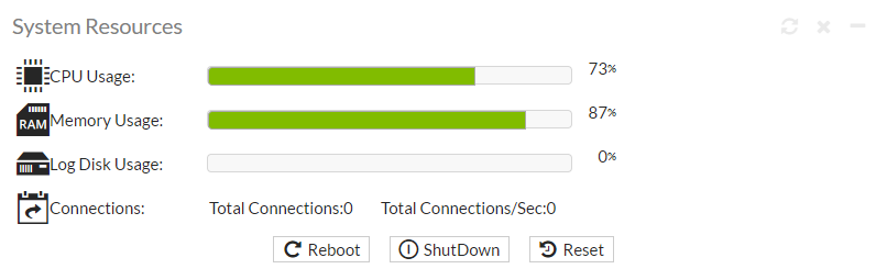

System Resources
The System Resources widget on the dashboard displays information such as CPU and memory usage.
The widget displays CPU and memory usage as an animated bar and as a percentage of the usage for core processes only. CPU and memory usage for management processes (for example, for HTTPS connections to the web UI) is excluded.
Normal idle load varies by hardware platform, firmware, and configured features. To determine your specific baseline for idle, configure your system completely, reboot, then view the system load. After at least 1 week of uptime with typical traffic volume, view the system load again to determine the normal non-idle baseline.
To determine your available disk space, you can alternatively connect to the CLI and enter the command:
diagnose system mount list
Reboot Click to halt and restart the operating system of the FortiWeb appliance.
ShutDown Click to halt the operating system of the FortiWeb appliance, preparing its hardware to be powered off.
Reset
Click to revert the configuration of the FortiWeb appliance to the default values for its currently installed firmware version.
Caution: Back up the configuration before selecting Reset. This operation cannot be undone. Configuration changes made since the last backup will be lost. For instructions on backing up the configuration, see Restoring a previous configuration.

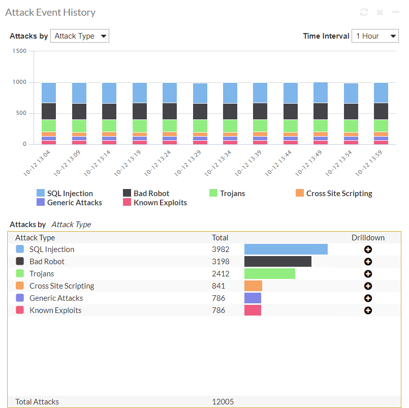

Attack Event History
The Attack Event History widget displays information about attacks that are detected and prevented. You can view information by Attack Type or Threat Level using the Attacks by drop-down menu.
Use the Time Interval drop-down menu to view the Attack Event History within the following time periods:
  • 1 hour
  • 12 hours
  • 48 hours
  • 1 week
Attack Type
Click elements in the legend of the graph to show/hide those elements in the graph.
In the Attacks by Attack Type window under the graph, select the + icon under the Drilldown column to view the following information about each attack type:
  • Server Policy
  • Client
  • Time
Threat Level
In the Attacks by Threat Level window under the graph, select the + icon under the Drilldown column to view the following information about each attack type:
  • Server Policy
  • Client
  • Time

Throughput

HTTP Transactions
  • 1 hour
  • 2 hours
  • 5 hours
System Information
HA Status
Host Name
Serial Number
Operation Mode
System Time
Firmware Version
FIPS-CC Mode Displays whether Federal Information Processing Standards (FIPS) and Common Criteria (CC) compliant mode is enabled. You use a CLI command to enable this mode.

Operation
  • Name (e.g. port1)
Operation widget

Event Log Console
System Resources
Reset

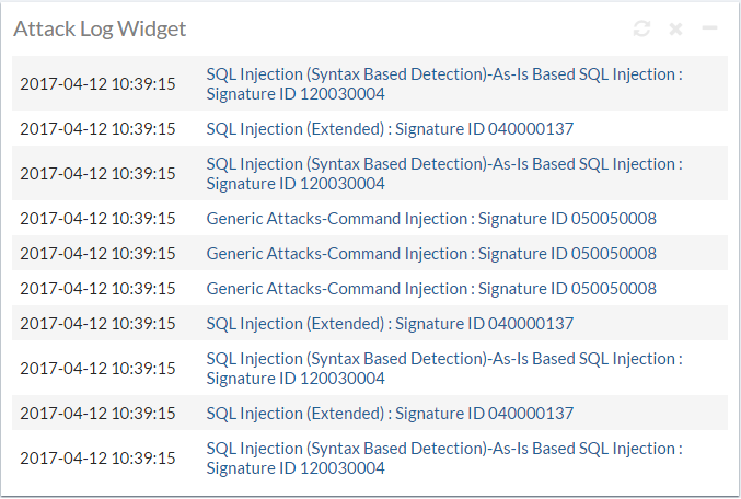

Attack Log
The Attack Log widget displays the latest attack logs. Attack logs are recorded when there is an attack or intrusion attempt against the web servers protected by the FortiWeb appliance.
Attack logs help you track policy violations. Each message shows the date and time that the attack attempt occurred. For details, see Viewing log messages.
Attack log messages can also be delivered by email, Syslog, FortiAnalyzer, or SNMP. For details, see Enabling log types, packet payload retention, & resource shortage alerts, Configuring logging, and SNMP traps & queries.
Attack Log widget

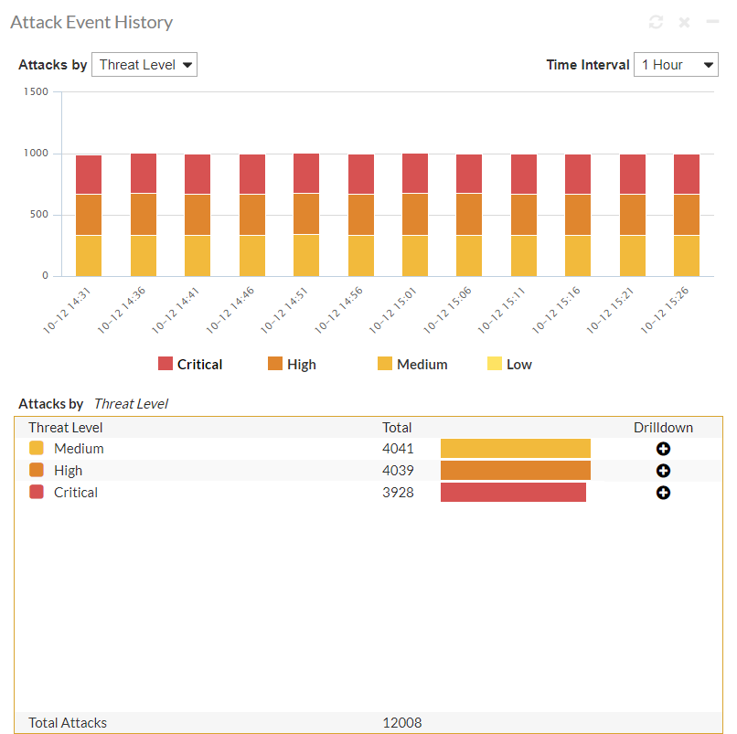

  • 1 hour
  • 12 hours
  • 48 hours
  • 1 week
Attack Type
  • Server Policy
  • Client
  • Time
Threat Level
  • Server Policy
  • Client
  • Time
