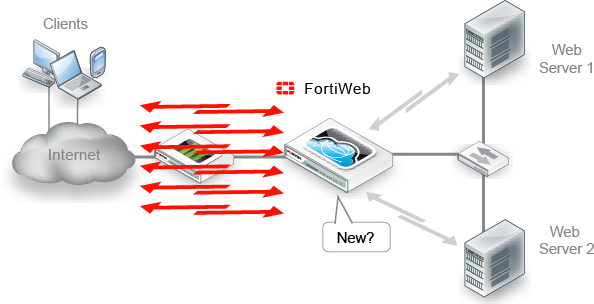

To improve performance of your back-end network and servers by reducing their traffic and processing load, you can configure FortiWeb to cache responses from your servers.
Normally, FortiWeb forwards all allowed requests to your servers. This results in a 1:1 ratio of client-side to server-side traffic. When content caching is enabled, however, FortiWeb will forward only requests for content that:
- Does not exist in its cache, and
- Is cacheable (see What can be cached?)
When many requests are for cached content, the ratio of traffic changes to n:1.
