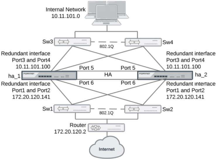

Configuring redundant interfaces in HA
You can create an HA group with redundant interfaces that eliminate potential single points of failure. Redundant interfaces consist of at least two physical interfaces. At any given time, only one of the physical interfaces has traffic going through it; the other interfaces act as backups in the event that the active interface fails.
This is an example of an HA group with redundant interfaces:
For details, see Configuring redundant interfaces.

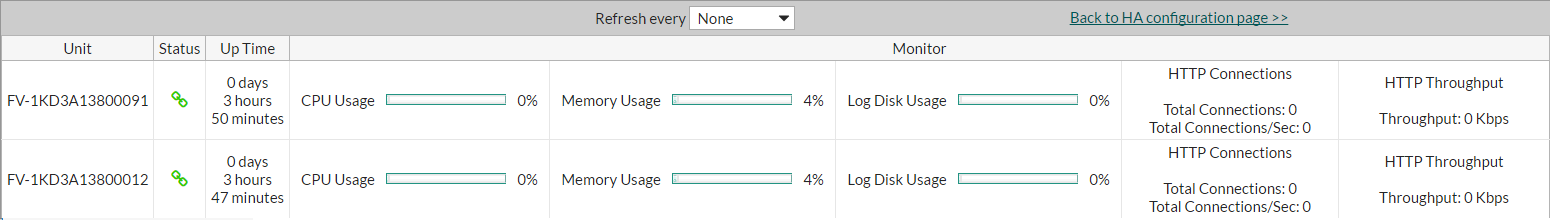

Checking your HA topology information and statistics
After completing your HA deployment, you can manage the HA topology and view information and statistics for each HA unit.
Go to System > High Availability > HA Topology. From here, you can select the primary unit or secondary appliances in the group, and a pop-up window will appear with the option to disconnect them. If you select a secondary in the group, the pop-up will also provide options to view its attack logs, event logs, and traffic logs. On the log page, you can click the Download button to download the logs of the secondary appliances. To view logs for the primary unit in the group, go to Log&Report > Log Access and select the log(s) you want to view.
From System > High Availability > HA Topology, click View HA Statistics in the top right corner of the window. The following information about each unit in the group is displayed:
For best fault tolerance, make sure that your topology is fully redundant, with no single points of failure. For example, in the above image, the switch, firewall, and Internet connection are all single points of failure. If any should fail, websites would be unavailable despite the HA group. To prevent this, you would add a dual ISP connection to separate service providers, preferably with their own redundant pathways upstream. You would also add a standby firewall, and a standby switch. For details, see Configuring redundant interfaces. |
