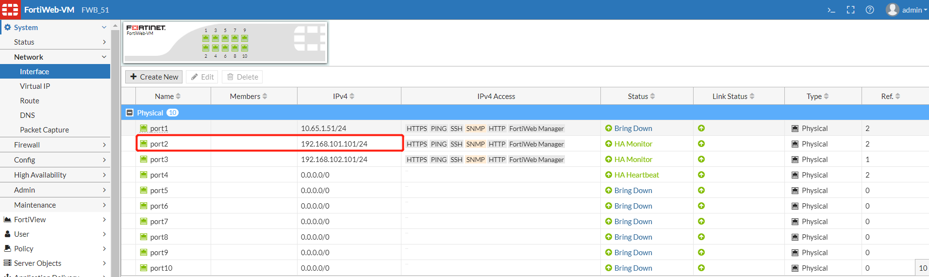

  • Ensure that the physical interfaces that FortiWeb monitors to check the status of appliances in the cluster (Port Monitor in HA configuration) are in the same subnet.
  • Ensure that the HA heartbeat link ports are connected through crossover cables. Although the feature works if you use switches to make the connection, Fortinet recommends a direct connection.

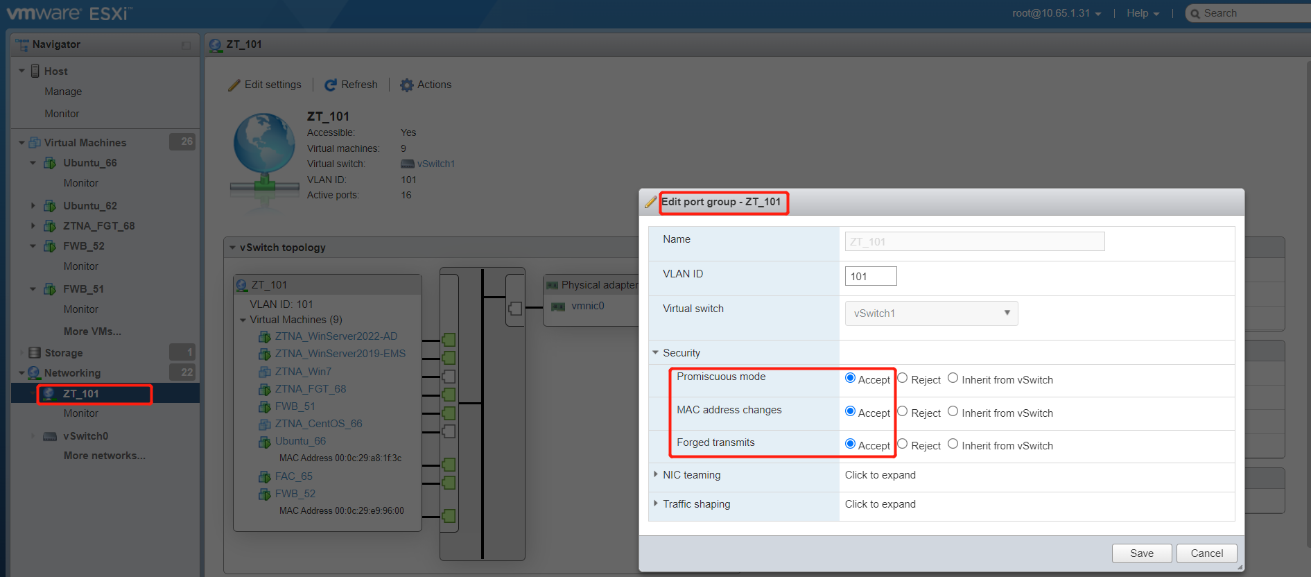

Troubleshooting HA issues when FortiWeb nodes are deployed on Hypervisors - Extra configuration on ESXi for HA deployment
In most cases, traffic ports except the heartbeat and reserved-mgmt ones on FortiWeb will use a virtual MAC address, so in VM ESXi environment such as VMWare ESXi, if you want to visit the IP address or VIP, you’ll need to enable the promiscuous mode on the traffic port. Actually you need to enable all three options for ESXi > Networking > Port-Groups > Edit settings > Security > Promiscuous mode, MAC address changes and Forged transmits.
The specific configuration is based on different HA modes:
  • Active-Passive mode: IP addresses on all traffic ports and VIPs on the primary node will use a virtual mac address formatted like “00:09:0F:A0:CC:02” to reply to a visit, so promiscuous needs to be enabled on all traffic ports.
    The secondary nodes will still use the real-mac until it switches to be the primary node.
  • Active-Active-Standard mode: the same as Active-Passive mode.
  • Active-Active-High-Volume mode: IP addresses on the physical ports will still use the original mac address, while VIPs will use virtual mac address, so if just the Interface IP is used as the Virtual Server in Server Policy, promiscuous can be disabled; but if VIPs are created and bound to Server Policy, promiscuous needs to be enabled on the traffic ports.
    E.g. HA AS mode in ESXi platform:
    By default, port2 (Network Adapter 2) only processes the original MAC address assigned by ESXi: 00:0c:29:e9:0f:9a:
    But as HA-AAHV mode is enabled, IPs including the VIP on port2 uses a virtual MAC: 00:09:0f:a0:cc:02.

2. Verify that heartbeat interfaces are configured correctly and properly.
Please refer to above section HA Key Settings > Heartbeat part for more details.
4. Test the cables and/or switches in the heartbeat link to verify that the link is functional.
5. Verify that the ports on Monitor Interface are linked up.

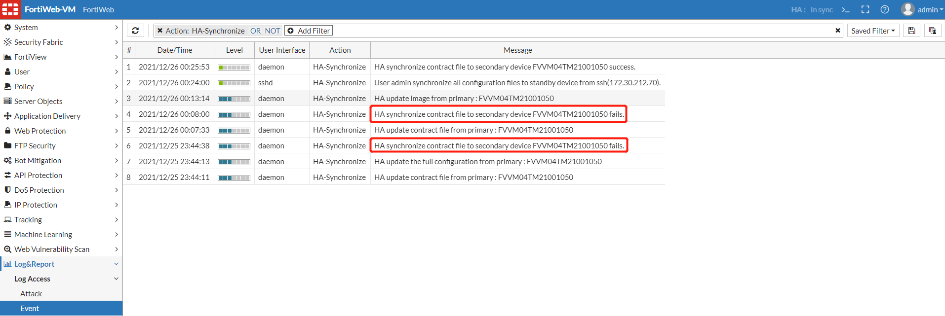

4. Check HA event logs to find the timeline and causes for HA failover:
Sometimes you may be not sure about the events and causes but just observed an unexpected HA failover, then you can check the HA failover events in these ways/logs.
  • Check the Event logs, which include the reasons for HA status changes and can be filtered with “Action: HA-Switch” or other options as below:
    Log & Report > Log Access > Event > Action: HA-Switch, HA-Synchronize, HA-member-left, HA-member-join, HA-monitor-port.
    E.g. Below logs show different HA switch events caused by priority changes, monitor ports status changes and uptime comparison.

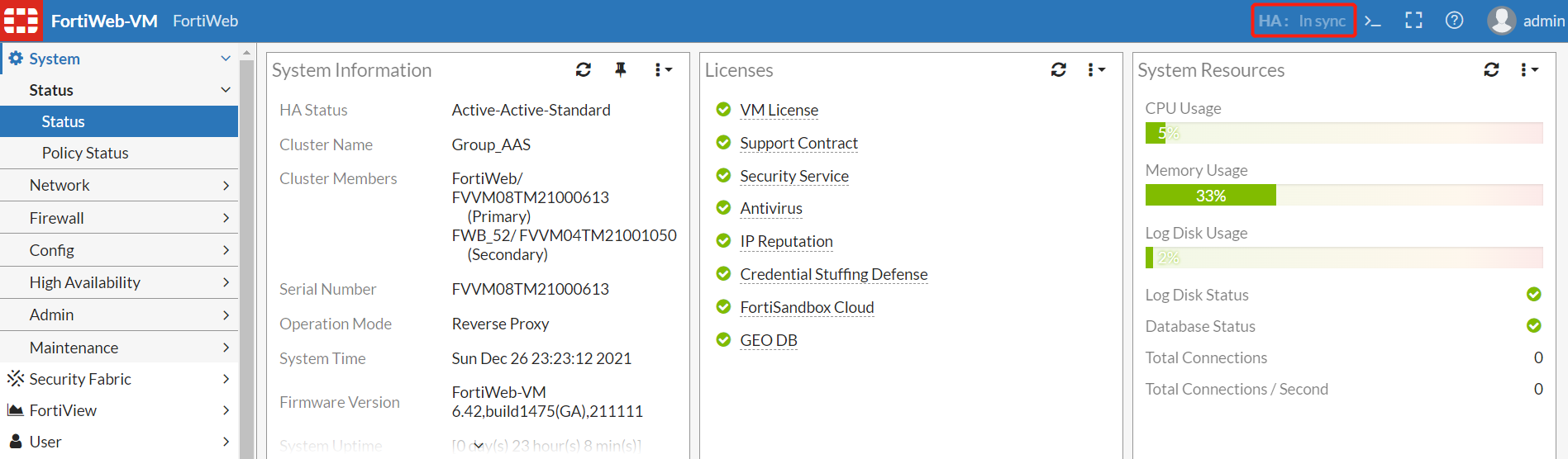

2. Verify that the configuration has been synchronized completely
  • Verify that the md5 for SYS & CLI on the primary & secondary nodes via “execute ha md5sum” or “diagnose sys ha confd_status” on the primary node to see if the configuration are identical
    FortiWeb # execute ha md5sum
    FVVM04TM21001050<Primary>
    SYS: D075A17ADDD372423263F4B31ACB8C7F
    CLI: 2D1DE97C0C1F1968FB4BFCE530E52A1B
    FVVM08TM21000613<Secondary>
  • Verify that the Sync status on GUI top menu is “In Sync” (after 6.4 builds)

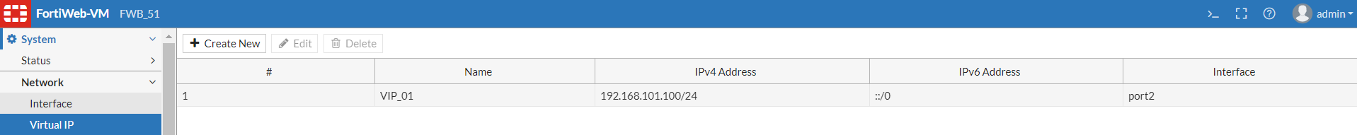

5. Check if the VIP address is bound to the corresponding interface on the primary FortiWeb node
~# ip addr show port2
6: port2: <BROADCAST,MULTICAST,UP,LOWER_UP> mtu 1500 qdisc mq qlen 1000
link/ether 00:09:0f:a0:2c:02 brd ff:ff:ff:ff:ff:ff
inet 192.168.101.101/24 brd 192.168.101.255 scope global port2
valid_lft forever preferred_lft forever
inet 192.168.101.100/24 brd 192.168.101.255 scope global secondary port2
inet6 fe80::20c:29ff:fee9:9600/64 scope link
FortiWeb_52 # show system interface port2
config system interface
edit "port2"
set type physical
set ip 192.168.101.101/24
set allowaccess ping ssh snmp HTTP HTTPs FortiWeb-manager
config secondaryip
config classless_static_route
FortiWeb_52 # show system vip
config system vip
edit "VIP_01"
set vip 192.168.101.100/24
set interface port2
set index 1
6. Verify that after switch over, the upstream router has its ARP table (or the switch refreshed its MAC table) refreshed via gratuitous ARP sent out by the new primary FortiWeb node.

2. Use the HA Diff Toolbar to check the HA status and configuration Diff on GUI.
On 6.4.1 and later releases, FortiWeb adds a new toolbar to show the HA sync status in the toolbar. If the HA devices are not synchronized, the menu will be clickable. After you click the ‘Not sync’ menu, it will prompt one slide page on the right and show the HA differences between the Primary and first different Secondary device. In other words, if you have more than one Secondary devices which are all not synchronized with the Primary device, this new tool will only show the first Secondary difference. After you fix the first Secondary difference, it will show the next difference.
Please note that this HA Diff Tool is only effective on the Primary device.

In sync
All the HA devices are in sync status
No

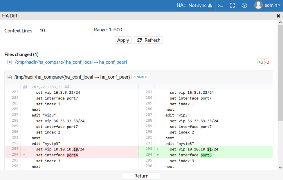

Examples 1: Configurations not sync
In the figure below, the Virtual IP configurations are different between the two HA devices. You can modify or remove the differences in the Primary device. Otherwise, you need to backup the entire configurations respectively and contact us.

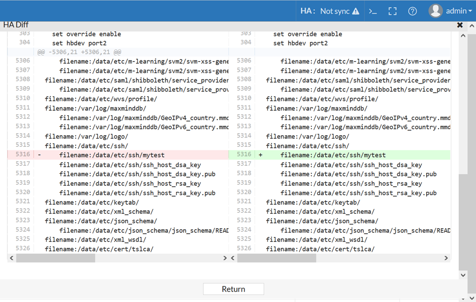

Examples 2: System files not sync
In the figure below, the files ‘/data/etc/ssh/mytest’ are different between the two HA devices

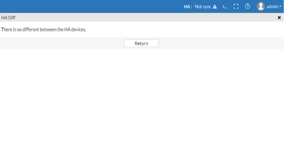

Examples 3: Configurations not sync
In the figure below, although the menu show “Not sync”, when you click it the HA diff page shows “There is no difference between the HA devices.”
This is because when the Primary device gets the Secondary device not sync status, the Primary device will synchronize the full configurations and some system files to the Secondary, then the Secondary node will receive these files and apply them. This process will also take some time. After the full synchronization, the HA devices are in sync status. Wait a minute, the HA difference menu will show ‘In sync’ status.
If there are lots of differences between the two HA devices, it could take long time to show the differences. Please wait patiently. If you always fail to get the difference for the not sync status or some errors happen when using the HA difference tool, you have other options to check the HA differences.
3. Check the Event log to confirm that HA synchronization failure events and the cause.
Log & Report > Log Access > Event > Action: HA-Synchronize.
E.g. Logs will show synchronization fails as below:

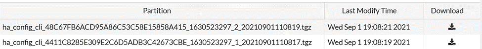

5. Use “diagnose system ha backup-config” to check the synchronized configuration
Use this command to export the configuration file of the HA nodes. It only backs up the configurations synchronized between HA nodes. You can use this command to compare the configuration files between the HA nodes and check which part of the configuration is not synchronized as expected.
FortiWeb # diagnose system ha backup-config
<id> please input peer box index.
<1> Subsidary unit FVVM08TM21000613
<2> Subsidary unit FVVM04TM21001050
FortiWeb # diagnose system ha backup-config 1
Config file /var/log/gui_upload/ha_config_1_20211227002455.tgz has been backed up.
Please download it from System->Maintenance->Backup&Restore by GUI.
FortiWeb # diagnose system ha backup-config 2
FortiWeb #
Then you can check the System > Maintenance > Backup & Restore page, and you will see the GUI file Download/Upload part. Please download the files as the below, it will be very helpful for locating the issue.

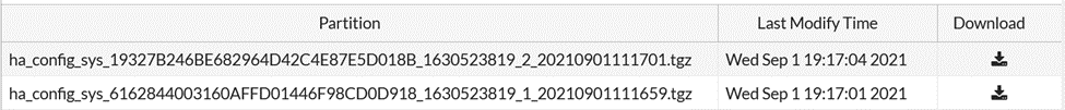

6. Download the backup configuration files and compare them manually.
When configuration not sync occurs, the primary system will archive the current configuration files & the md5 for each domain. You can check and compare them for details.
Depending on the cause of difference (SYS files or CLI configuration), the archive files will be named as “ha_config_cli_xxx” or “ha_config_sys_xxx”.

  • System Event log: Log&Report > Log Access > Event
  • /var/log/gui_upload/ha_event_log #Download from System > Maintenance > Backup & Restore > GUI File Download/Upload (will be archived in the debug log in future builds)
config system vip
edit "VIP_01"
set interface port2
set index 1

8. If it’s VM FortiWebs running in virtual environment, please check the extra configuration on hypervisors according to above section "HA Key Settings > Extra configuration on hypervisors in VM environment"
HA Sync Status on GUI:
Status
Clickable
Standalone
No HA mode enabled and Standalone mode now
No
Wait to sync
Found the Secondary device, not sure about the sync status, please wait some minutes to check the sync status
No
In sync
No
Not sync
At least one or more Secondary devices are not sync with the Primary node. You can click this menu and show the differences between Primary device and first different Secondary device
Yes
Secondary
Current HA device is a secondary node
No
INIT
Available on the secondary device when the device just joins HA group and during synchronizing configuration from the primary node
No
Note: When the Secondary device joins a HA cluster for the first time, HA status may show as ‘Not sync’. You may not get a difference report when clicking ‘Not sync’ at this time because the secondary device is converting the configuration received from the primary node.
Depending on the size of configuration files, it’ll take several minutes to complete converting the configuration.
