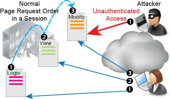

However, sessions alone are not enough to ensure that a client’s requested operations make sense. The client’s next page request in the session could break the web application’s logic unless requests are restricted to valid ones.
For example, a web application session may remember that a client has authenticated to it. But unless the web application also knows what pages a client is authorized to use, there might be nothing to prevent a client from accessing unauthorized content.
If a web application doesn't enforce valid state transitions and guard session IDs and cookies from fraud (including side-jacking attacks made famous by Firesheep) or cookie poisoning, web applications become vulnerable to state transition-based attacks—attacks in whichpages are requested out of the expected order, by a different client, or where inputs used for the next page are not as expected. While many web applications reflect business logic in order to function, not all applications validate state transitions to enforce application logic. Other web applications do attempt to enforce the software’s logic, but do not do so effectively. In other cases, the state enforcement itself has bugs. These are all common causes of security vulnerabilities.

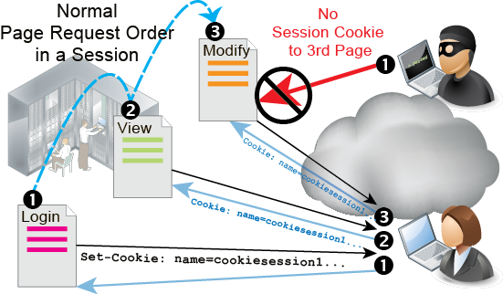

For example, to reinforce authentication logic, you might want to require that a client’s first HTTP request always be a login page. All other web pages should be inaccessible until a client has authenticated, because out-of-order requests could be an attempt to bypass the web application’s authentication mechanism.
How can FortiWeb know if a request is the client’s first HTTP request? If FortiWeb were to treat each request independently, without knowledge of anything previous, it would not be able to remember the authentication request, and therefore could not enforce page order.
To fill this need for context, enable Session Management. When enabled:
- For the first HTTP/HTTPS request from a client, FortiWeb embeds a cookie in the response’s
Set-Cookie:field in the HTTP header. It is namedcookiesession1. (FortiWeb does not use source IP addresses and timestamps alone for sessions: NAT can cloak multiple clients; clocks can be altered.)If you have configured rules such as start page rules that are enforced when a page request is the first in a session, FortiWeb can enforce them at the specified point. For details, see Specifying URLs allowed to initiate sessions.
- Later requests from the same client must include this same cookie in the
Cookie:field to be regarded as part of the same session. Otherwise, the request will be regarded as session-initiating, and return to the first step.
Once a request’s session is identified by the session ID in this cookie (e.g.
K8BXT3TNYUM710UEGWC8IQBTPX9PRWHB), FortiWeb can perform any configured tracking or enforcement actions that are based upon the requests that it remembers for that session ID, such as rate limiting per session ID per URL (see Limiting the total HTTP request rate from an IP), or based upon the order of page requests in a session, such as page order rules (see Enforcing page order that follows application logic). Violating traffic may be dropped or blocked, depending on your configuration. - After some time, if the FortiWeb has not received any more requests, the session will time out.
The next request from that client, even if it contains the old session cookie, will restart the process at step For the first HTTP/HTTPS request from a client, FortiWeb embeds a cookie in the response’s Set-Cookie: field in the HTTP header. It is named cookiesession1. (FortiWeb does not use source IP addresses and timestamps alone for sessions: NAT can cloak multiple clients; clocks can be altered.)
If you have configured rules such as start page rules that are enforced when a page request is the first in a session, FortiWeb can enforce them at the specified point. For details, see Specifying URLs allowed to initiate sessions..

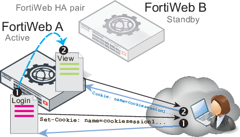

Example: Magento & FortiWeb sessions during failover
A client might connect through a FortiWeb HA pair to an e-commerce site. The site runs Magento, which sets cookies in a server pool. To prevent session stealing and other session-based attacks, Magento can track its own cookies and validate session information in $_SESSION using server-side memory.

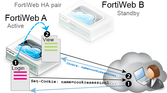

In the FortiWeb HA pair that protects the server pool, you have enabled Session Management so that the active appliance (FortiWeb A) also adds its own cookie to the HTTP response from Magento. The HTTP response therefore contains 2 cookies:
- Magento’s session cookie
- FortiWeb’s session cookie
The next request from the client echoes both cookies. It is for an authorized URL, so FortiWeb A permits the website to respond.

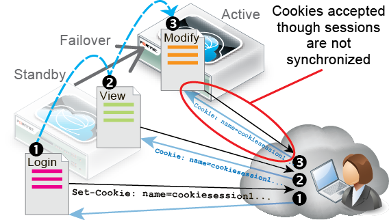

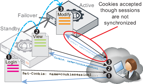

Let’s say you then update FortiWeb A’s firmware. During the update, the standby appliance (FortiWeb B) briefly assumes the role of the active appliance while FortiWeb A is applying the update and rebooting (e.g., a failover occurs).
After the failover, FortiWeb B would receive the next HTTP request in the session. Because it was previously the standby when the client initiated the session, and FortiWeb session tables are not synchronized, FortiWeb B has no knowledge of the FortiWeb session cookie in this request.
As a result, it cannot enforce sequence-specific features such as page order, since it does not know the session history. However, a FortiWeb session cookie is present. Therefore FortiWeb B would permit the new request (assuming that it has no policy violations).
Since web application sessions are not the same as FortiWeb sessions, Magento sessions continue and are unaffected by the failover. |
If the client deletes their FortiWeb session cookie or it times out, FortiWeb B regards the next request as a new FortiWeb session, adding a new FortiWeb session cookie to Magento’s response and creating an entry in FortiWeb B’s session table, enabling it to enforce page order and start page rules again.
