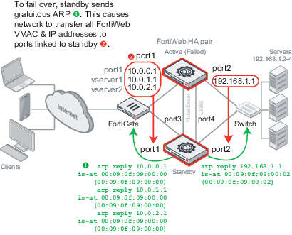

This is an example of an active-passive HA topology and failover in which there is an IP address transfer to the new active appliance:
In this example, the primary heartbeat link is formed by a crossover cable between the two port3 physical network ports; the secondary heartbeat link is formed between the two port4 physical network ports.
For best fault tolerance, make sure that your topology is fully redundant, with no single points of failure. For example, in the above image, the switch, firewall, and Internet connection are all single points of failure. If any should fail, websites would be unavailable despite the HA cluster. To prevent this, you would add a dual ISP connection to separate service providers, preferably with their own redundant pathways upstream. You would also add a standby firewall, and a standby switch. For details, see Configuring redundant interfaces. |
The style of FortiWeb HA is active-passive: one appliance is elected to be the active appliance (also called the primary, main, or master), applying the policies for all connections. The other is a passive standby (also called the secondary, or slave), which assumes the role of the active appliance and begins processing connections only if the active appliance fails.
The active and standby appliances detect failures by communicating through a heartbeat link that connects the two appliances in the HA pair. Failure is assumed when the active appliance is unresponsive to the heartbeat from the standby appliance for a configured amount of time:
Heartbeat timeout = Detection Interval x Heartbeat Lost Threshold
If the active appliance fails, a failover occurs and the standby appliance becomes active. To do this, the standby takes all IPv4 addresses of the unresponsive appliance and notifies the network via the Address Resolution Protocol (ARP) to redirect traffic for that virtual MAC address (VMAC) to its own network interfaces; in transparent modes, this includes the management IP. In an IPv6 environment, the network is notified via Neighbor Solicitation (NS).
Additionally, at Layer 2, switches are notified that the VMAC is now connected to a different physical port. So even though in these modes the interfaces usually are transparent bridges without IPs, ARP/NS traffic will still occur due to failover.
Time required for traffic to be redirected to the new active appliance varies by your network’s responsiveness to changeover notification and by your configuration:
Total failover time = ARP/NS Packet Numbers x ARP/NS Packet Interval(sec) + Network responsiveness + Heartbeat timeout

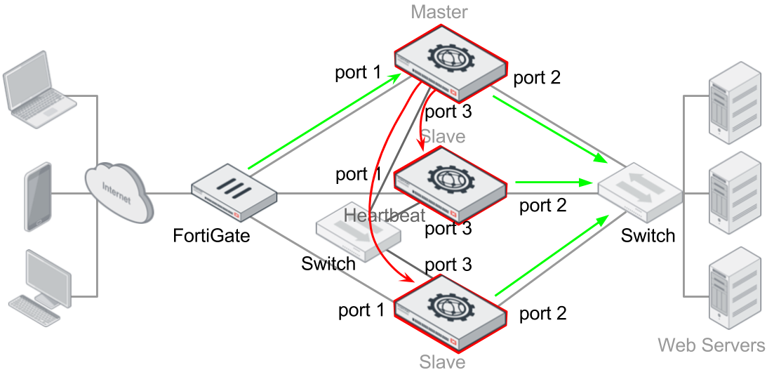

This is an example of an active-active HA cluster:
An active-active HA cluster created in Reverse Proxy and True Transparent Proxy modes can consist of up to eight FortiWebs. One of the member appliances will be selected as the master appliance, while the others are slaves.
The master appliance in an active-active HA cluster plays the role as the central controller to receive traffic from clients and back web servers, and distribute the traffic to all the cluster members (including itself) according to the specified load-balancing algorithm so that each FortiWeb appliance performs the security services to protect the traffic.
Similar to the active-passive HA deployment, the operation of active-active HA cluster requires heartbeat detection, configuration and session synchronization between the cluster members. If the master appliance fails, one of the slaves will take it over. The heartbeat interfaces of all the HA appliances must be connected directly with crossover cables or through switches to carry the heartbeat and synchronization traffic between the HA cluster members.

Load-balancing in active-active HA
There are three load-balancing algorithms available for master appliance to distribute received traffic over the available cluster members:
- By source IP: consistently distribute the traffic coming from a source to the same cluster member (the default algorithm).
- By connections: dynamically distribute traffic to a cluster member who has the fewest connections processing.
- Round-Robin: distribute traffic among the available members in a circular order.
All the cluster members, including the master appliance, are the candidates for the algorithms, unless failure is detected on any of them. Traffic distribution is based on TCP/UDP sessions, which means once the first packet of a TCP/UDP session is assigned to a cluster member, the subsequent packets of the session will be consistently distributed to the same appliance during a time period. For more details, see Configuring HA.
Although algorithm By source IP distribute the subsequent traffic coming from the same source IP address to a fix cluster member, it performs weighted round-robin to determine the cluster member for the first packet coming from the IP address. You can configure the weights between the cluster members through the CLI command |
Fail-over in active-active HA
An active-active HA cluster performs the same heartbeat detection and configuration synchronization mechanisms as an active-passive HA pair. If a slave failure is detected, the slave appliance will be ignored by the master for its traffic distribution. If the master fails, one of the slave appliances will take it over as a master immediately (see How HA chooses the active appliance). After the original master recovers from failure, it becomes the slave unit. Note that all the sessions distributed to a cluster appliance will be lost if the appliance fails.

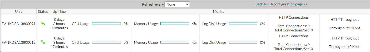

Check your HA topology information and statistics
After completing your HA deployment, you can manage the HA topology and view information and statistics for each HA unit.
Go to System > Status > HA Topology. From here, you can select the master unit or slaves in the cluster, and a pop-up window will appear with the option to disconnect them. If you select a slave in the cluster, the pop-up will also provide options to view its attack logs, event logs, and traffic logs. To view logs for the master unit in the cluster, go to Log&Report > Log Access and select the log(s) you want to view.
From System > Status > HA Topology, click View HA Statistics in the top right corner of the window. The following information about each unit in the cluster is displayed:
