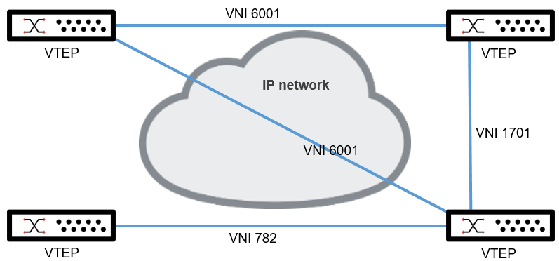

In the following configuration example, three VNIs connect four FortiSwitch units (VTEPs).
The FortiSwitch units learn remote MAC addresses by flooding broadcast, unicast, and multicast packets to each remote-ip address to find out the MAC address associated with the tunnel source.

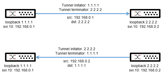

For example, if you want to create the following two VXLAN tunnels:
To configure loopback 1.1.1.1:
config system vxlan
edit "vni.4094"
set vni 4094
set vlanid 4094
set ip-version ipv4-unicast
set remote-ip "2.2.2.2"
set interface "loopback"
config system interface
edit "svi.10"
set ip 192.168.0.1
edit "loopback"
set ip 1.1.1.1/32
To configure loopback 2.2.2.2:
config system vxlan
edit "vni.4094"
set vni 4094
set vlanid 4094
set remote-ip "1.1.1.1"
edit "svi.10"
set ip 192.168.0.2
edit "loopback"
set ip 2.2.2.2/32

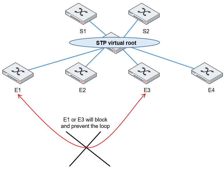

Starting in FortiSwitchOS 7.2.1, you can prevent layer-2 loops between VTEPs. When the STP virtual root feature is enabled on all VTEPs in a VXLAN tunnel, the FortiSwitch units act as a single STP root so that no loops can form between any of the switches.

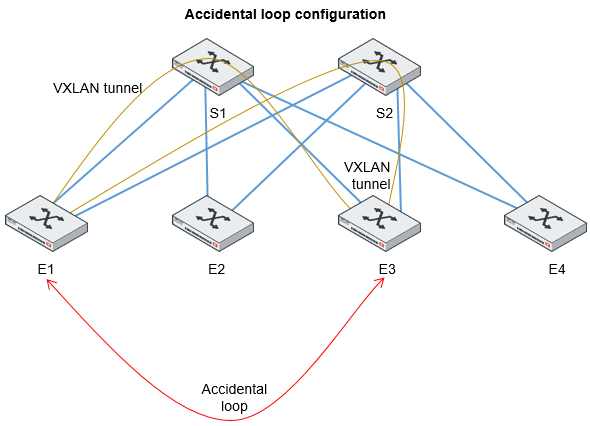

For example, in the following topology, the user has accidentally configured a loop between switch E1 and switch E3:
Using the STP virtual root feature, the loop between switch E1 and switch E3 is prevented:
tooltip icon For the STP virtual root feature to work correctly, the core of the network must be a routed layer-3 network that is not participating in the Spanning Tree Protocol. Commonly, the network is using routed interfaces instead that terminate the layer-2 network.
By default, the STP virtual root feature is disabled. After you enable this feature, the MAC address for the virtual STP root is set to 08:5B:0E:00:00:00 by default, and the STP instance priority is set to 0. If you want to use a different MAC address for the virtual STP root, you can configure any unicast MAC address, but the same MAC address must be configured on all VTEPs in the VXLAN tunnel. If there are different MAC addresses configured on the VTEPs, there will be an “ERROR: virtual-root enable, not root!” listed on the Switch > STP > Instances page.

To create the STP virtual root, configure the following commands on all VTEPs in a VXLAN tunnel:
config switch global
set vxlan-stp-virtual-root enable
set vxlan-stp-virtual-mac <MAC_address>
