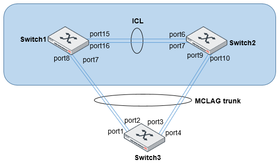

Example configuration
The following is an example CLI configurations for a MCLAG:
- Create a LAG by configuring the ports for Switch1:
config switch trunk
edit "MCLAG-ICL-trunk"
set mode lacp-active
set mclag-icl enable
set members "port15" "port16"
- Set up the MCLAG for Switch1:
config switch trunk
edit "first-mclag"
set mclag enable
set members "port7" "port8"
- Create a LAG by configuring the ports for Switch2:
config switch trunk
set members "port6" "port7"
- Set up the MCLAG for Switch2:
config switch trunk
edit "first-mclag"
set mclag enable
set members "port9" "port10"
- Set up the dual-home trunk for Switch3:
config switch trunk
edit "dht"
set members "port1" "port2" "port3" "port4"
