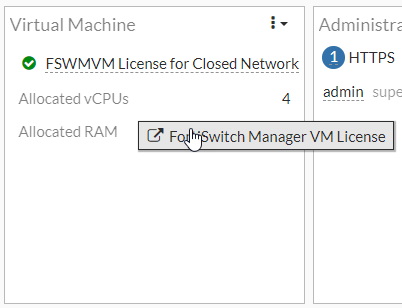

To upload the license file using the GUI:
  1. Go to Dashboard > Status.
  2. Click in the Virtual Machine widget.
  3. Click FortiSwitch Manager VM License.
  4. Click Upload.
  5. After you upload the license file, click OK.

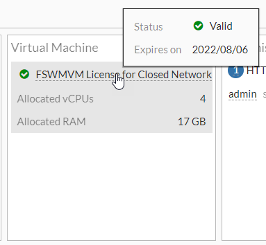

To check that the license is valid using the GUI:
Go to Dashboard > Status and hover over the license link in the Virtual Machine widget.
To check that the license status is valid using the CLI:
get system status

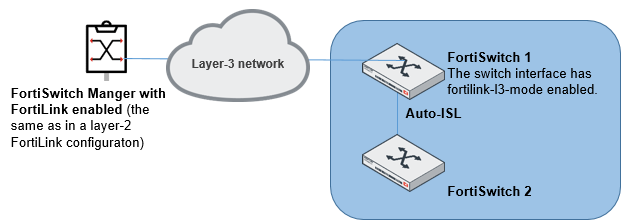

Connecting additional FortiSwitch units to the first FortiSwitch unit
In this scenario, the default FortiLink-enabled port of FortiSwitch 2 is connected to FortiSwitch 1, and the two switches then form an auto-ISL. You only need to configure the discovery settings (see Step 3) for additional switches (FortiSwitch 2 in the following diagram). You do not need to enable fortilink-l3-mode on the uplink port. Check that each FortiSwitch unit can reach FortiSwitch Manager.

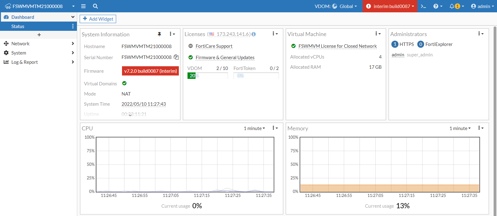

Go to Dashboard > Status to see the current values for the following:
  • System information
  • Licenses
  • Allocated vCPUs and RAM
  • Administrators
  • CPU
  • Memory

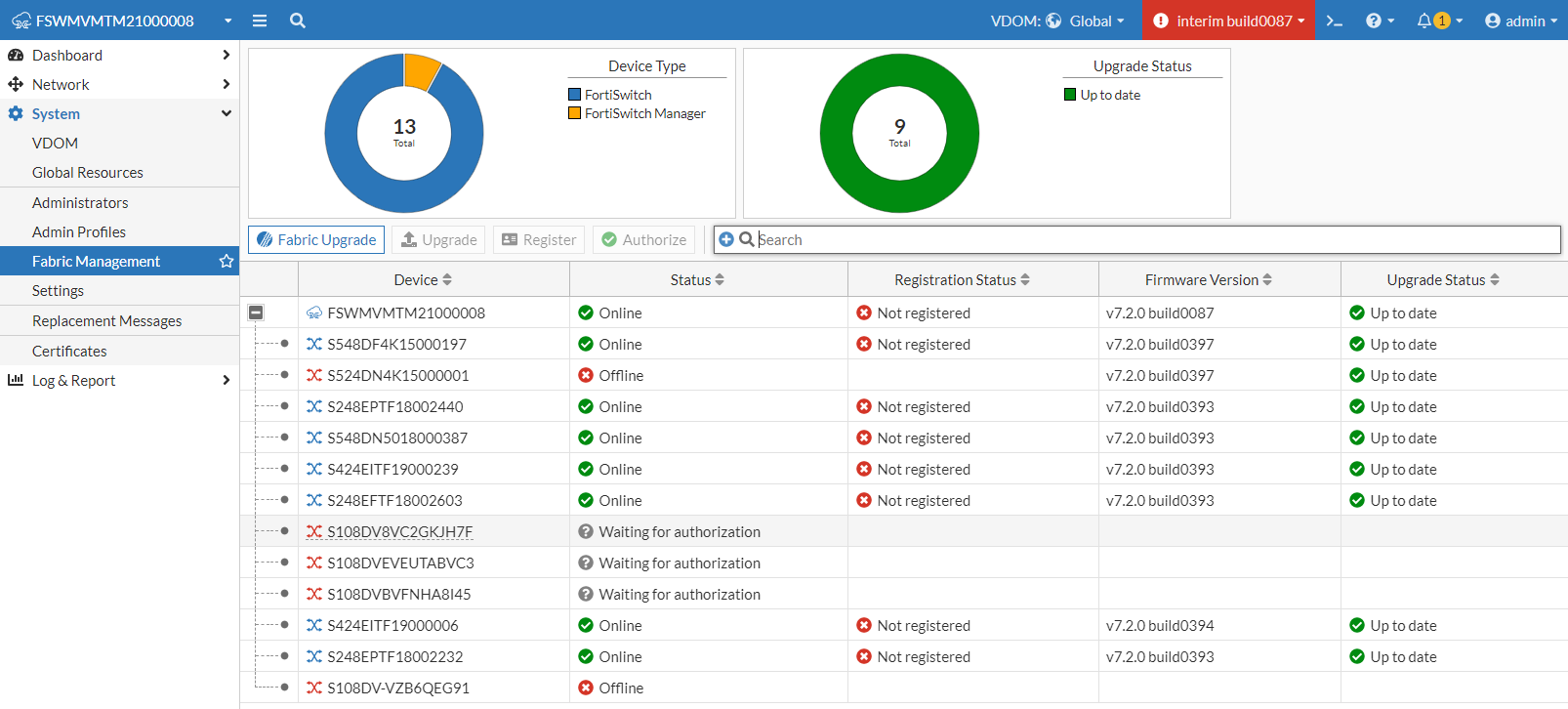

Go to System > Fabric Management to see a list of managed FortiSwitch units, as well as the status, registration status, firmware version, and upgrade status for each.
How to authorize a FortiSwitch unit
Using the GUI:
  1. Go to System > Fabric Management.
  2. Select an unauthorized FortiSwitch unit.
  3. Click Authorize.
  4. Click Upload.
To upload the license file:
execute restore vmlicense {ftp | tftp} <file-name> <FTP-server>[:FTP-port]
For example:
execute restore vmlicense tftp license.lic 10.0.1.2
get system status

To configure a FortiSwitch unit to operate in a layer-3 network (in-band management):
NOTE: You must enter these commands in the indicated order for this feature to work.
  1. Reset the FortiSwitch to factory default settings with the execute factoryreset command.
  2. Manually set the FortiSwitch unit to FortiLink mode if you are using FortiSwitchOS 7.0.0 or earlier:
    config system global
    set switch-mgmt-mode fortilink
  3. Configure the discovery setting for the FortiSwitch unit. You can either use DHCP discovery or static discovery to find the IP address of the FortiSwitch Manager. The default ac-dhcp-option-code is 138.
    To use DHCP discovery:
    config switch-controller global
    set ac-discovery-type dhcp
    set ac-dhcp-option-code <integer>
    To use static discovery:
    set ac-discovery-type static
    config ac-list
    edit <id>
    set ipv4-address <IPv4-address>
  4. Configure only one physical port or LAG interface of the FortiSwitch unit as an uplink port. When the FortiSwitch unit is in FortiLink mode, VLAN 4094 is configured on an internal port, which can provide a path to the layer-3 network. NOTE: The uplink port cannot be assigned any VLANs.
    config switch interface
    edit <port-number>
    set fortilink-l3-mode enable
    The fortilink-l3-mode command is only visible after you configure DHCP or static discovery.
  5. If you are going to configure another FortiSwitch unit that is connected to the FortiSwitch unit configured in steps 1-4, you only need to configure the discovery settings. You do not need to enable fortilink-l3-mode on the uplink port.
    config ac-list
    edit <id>
  • Licenses
  • Administrators
  • CPU
  • Memory
Using the GUI:
  3. Click Authorize.
Using the CLI:
config switch-controller managed-switch
edit <FortiSwitch-serial-number>
set fsw-wan1-admin enable
