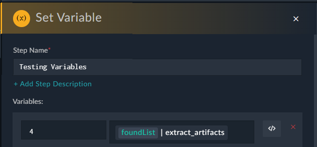

  • Var 4 - {{vars.foundList | extract_artifacts}}
    Simplified Expressions - Custom variable on which function is run
    In this example, vars.foundList is a custom variable on which want to run the extract_artifacts function.

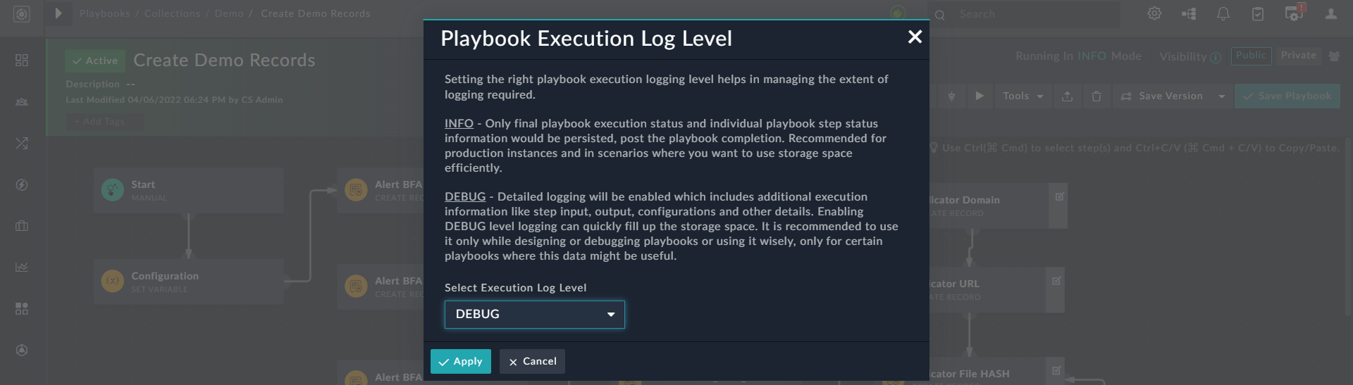

Setting the logging levels for playbooks
You can choose to set the logging levels for individual playbooks to either INFO (default) or DEBUG. From release 7.4.0 onwards, the default logging level for failed playbooks is set to DEBUG so that users do not need to rerun the playbook to view the exact reason for playbook failures.
Your administrator sets the global playbook logging levels; however, an administrator can also enable a setting that allows users to change the logging level for individual playbooks, which in turn overrides the global playbook logging levels. Set the playbook level logging to INFO for production instances and in scenarios where you want to use storage space efficiently; whereas use the DEBUG option only while designing or debugging playbooks since this option can quickly fill up the storage space.
To set the logging levels of a playbook, open the playbook in the playbook designer, and then click INFO or DEBUG (depending on the logging level set), which is present at the top of the Playbook Designer, as shown in the following image:
Playbook Designer: Top bar - Logging Level Mode
Clicking INFO or DEBUG displays the Playbook Execution Log Level dialog:
Playbook Execution Log Level Dialog
From the Select Execution Log Level field, select the logging level that you want to set for this playbook and click Apply. For example, if you select DEBUG, you will see that text at the top of the Playbook Designer changes to Running in DEBUG mode. Click Save Playbook to apply this change to the playbook.
For more information on playbook execution logs, see the Debugging and Optimizing Playbooks chapter.

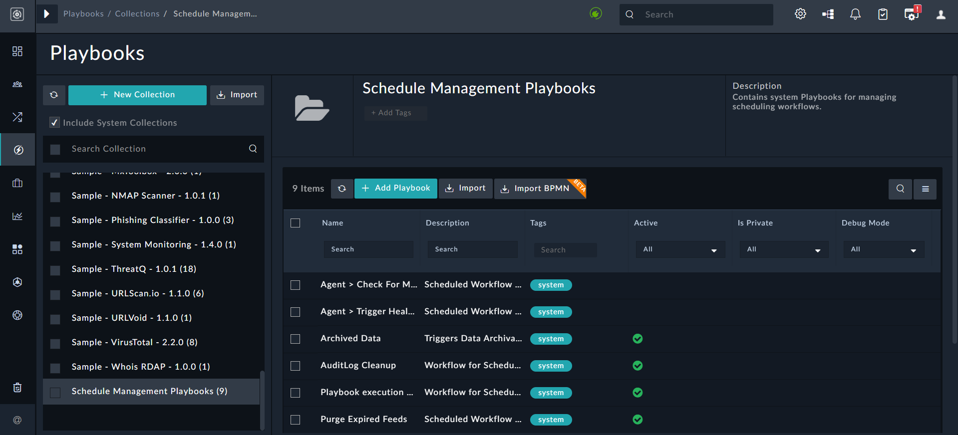

  1. Click Automation > Playbooks in the left navigation bar.
  2. On the Playbook Collections page, click New Collection to define a new playbook collection in which to save the playbook you want to create, or, click an existing playbook collection and add the new playbook in that collection.
    Note: You cannot add a playbook directly on the Playbook Collections page, you require to add playbooks to a playbook collection.
  3. In the Add New Playbook Collection dialog, add the name of the collection in the Name field and optionally in the Description field, add the description for the playbook collection.
    You can optionally change the icon that represents the playbook collection, by clicking Change Image and dragging and dropping your icon to the Upload an Image dialog, or browsing to the icon on your system, selecting the icon and then clicking Save Image.
    You can optionally also add keywords in the Tags field that you can use to reference the playbook collection and making it easier to search and filter playbook collections and playbooks. You can add special characters and spaces in tags; however, the following special characters are not supported in tags: ', , , ", #, ?, and /.
    Click Create to create the new playbook collection.
  4. To add a playbook, click the collection in which you want to create the new playbook, and then click Add Playbook, which displays the Add New Playbook dialog:

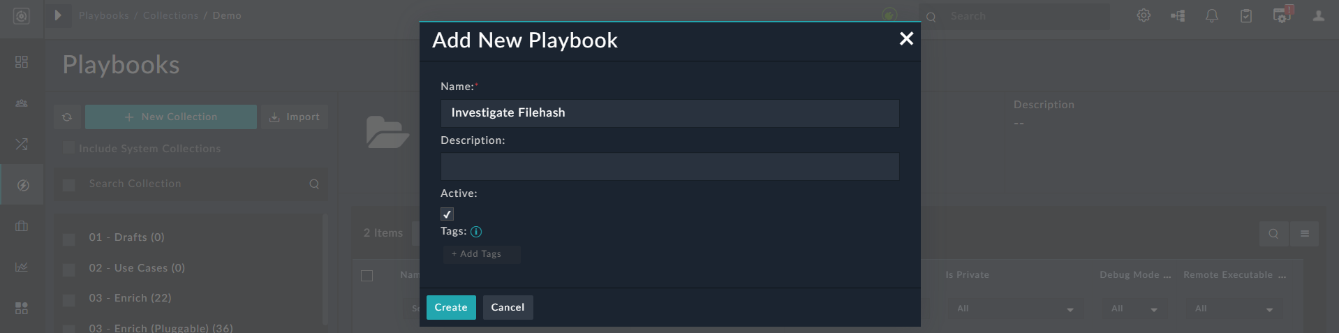

  5. In the Add New Playbook dialog, add the name of the playbook in the Name field and optionally in the Tags field, add keywords that you can use to reference the playbook, making it easier to search and filter playbooks. You can optionally in the Description field, add the description for the playbook.
    Important: Playbook names must be unique within a collection.
    The Active checkbox sets the state of the playbook as Active, or Inactive. By default, the Active checkbox is selected, i.e., new playbooks are created in the Active state.
    Click Create to add the new playbook.

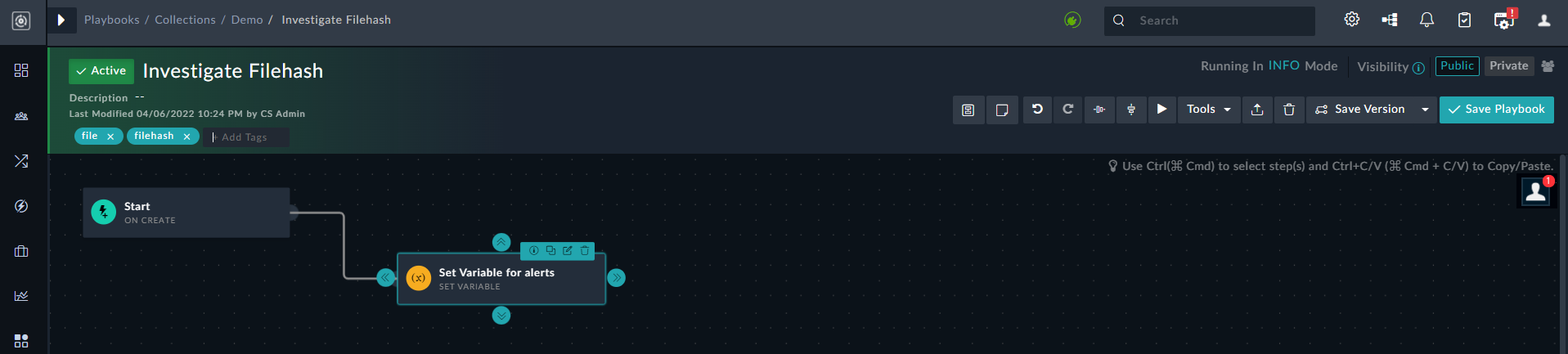

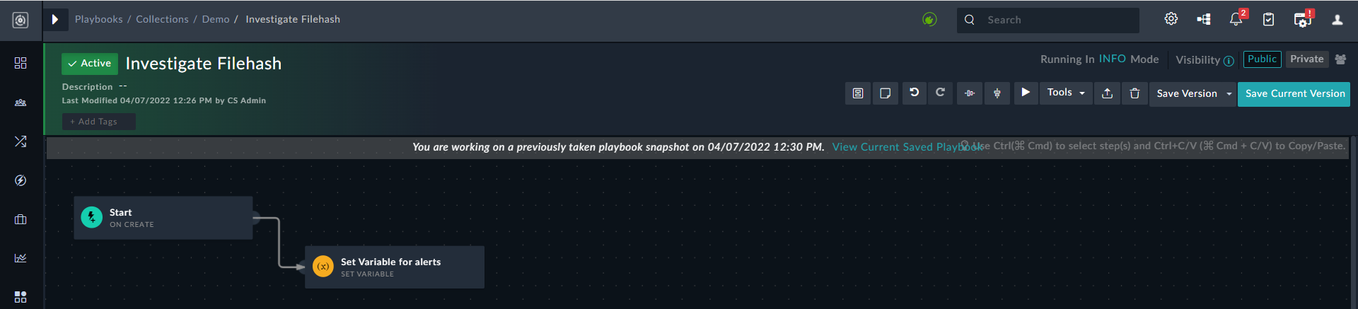

  6. FortiSOAR displays the Playbook Designer for the newly added Playbook, with a placeholder trigger step and the name you have specified being displayed in the Name field at the top of the Designer. Now, you must select a playbook trigger from the Triggers section and enter the necessary variables for the selected trigger, and then click Save.
    Playbook Designer - First step
    For information on the various triggers, see the Triggers & Steps chapter .
    Note: Specific conditions that the playbook should meet before continuing can be called out by creating a Decision Step immediately after the trigger. While the playbook will still execute, the decision step (s) determines if the playbook continues through the following steps or is considered finished.

    Once you've selected a trigger, FortiSOAR displays the trigger step in the Playbook Designer with highlighted connector points as shown in the following image:

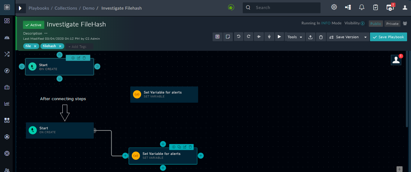

    Connecting a step to the trigger step
    Drag-and-drop a connector point to connect to another playbook step. FortiSOAR adds a placeholder step on the playbook designer page and opens the Steps tab which displays all the available playbook steps, select the playbook step that you need next, add the Step Name and the required variables and click Save.
    Adding steps
    Similarly, you can add further steps and create the desired flow for the playbook. A playbook ends when there are no additional steps to run. For more information on steps, see the Triggers & Steps chapter.
  8. Connect playbook steps or remove a connection between steps.
    It is straightforward to connect playbook steps as well as to remove the connection between playbook steps.
    To connect a playbook step, use the connection points that appear when you hover on a Playbook step. Select a connection point and drag and drop the arrow connector on the step you want to connect.
    Connecting Playbook steps
    To remove a connection between playbook steps, hover on the arrow connector between the steps, which then displays a cross (X) red color. Clicking X displays a Confirm dialog, click OK to remove the link between the playbook steps.
    Removing connection between playbook steps

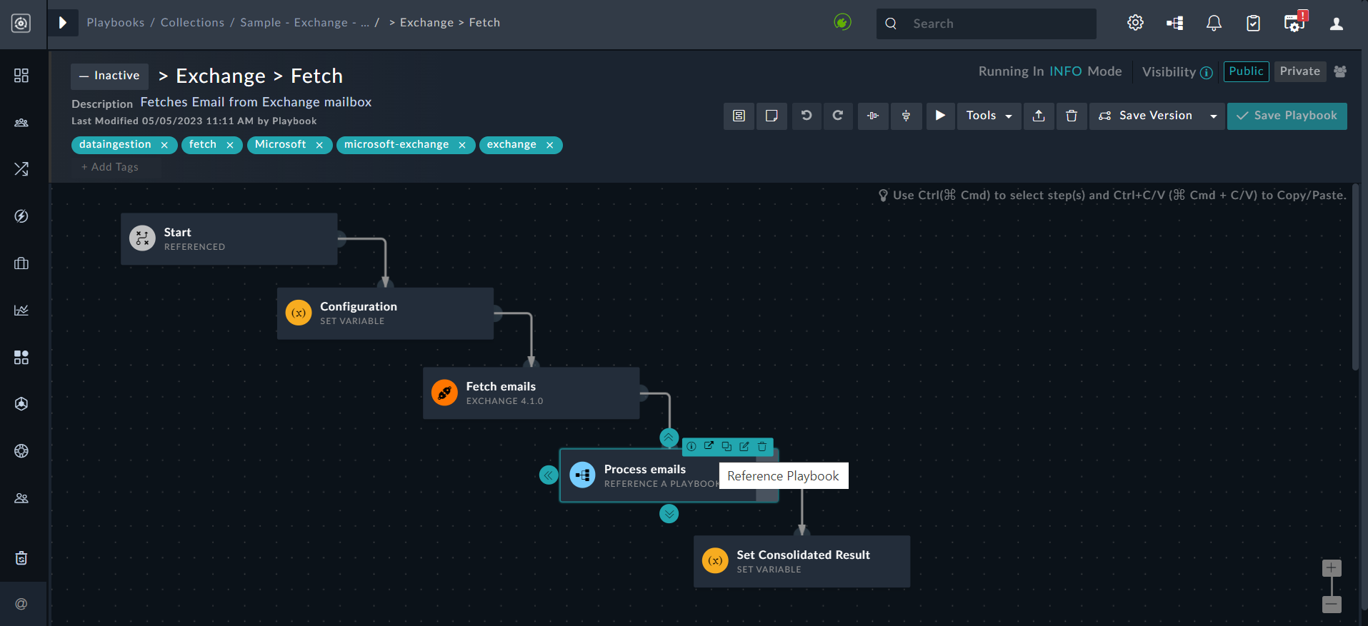

    Clicking the Reference Playbook icon (applicable only to the Reference A Playbook step) opens a referenced playbook in a new window. By allowing users the option to view the contents of the referenced playbook in a new window while viewing the referencing playbook's whole flow on the same canvas in the playbook designer, improves the user experience when creating playbooks. However, note that the Reference Playbook will open in a new window only when users select the reference playbook from the Playbook Reference drop-down list in the 'Reference A Playbook' step and not when user refer to a playbook using Dynamic Values (jinja).
    Refernce Playbook icon

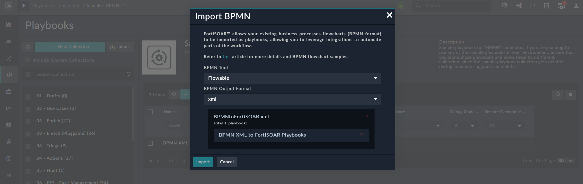

  2. To import the BPMN workflows into FortiSOAR:
    Note: FortiSOAR supports importing only a single BPMN workflow, i.e., you cannot import a collection of BPMN workflows.
    1. Log into FortiSOAR and click Automation > Playbooks in the left navigation bar.
    2. Click Import BPMN, which opens the Import BPMN dialog.
      Note: We are providing a "BETA" Version of this feature so that users can get a preview of this feature.
    3. In the Import BPMN dialog, do the following:
      1. From the BPMN Tool drop-down list, select the tool in which you have created your BPMN workflows.
        Note: FortiSOAR supports Flowable, Camunda, or Signavio.
      2. From the BPMN Output Format drop-down list, select the output format in which you want to convert your BPMN workflow.
        Note: FortiSOAR supports only XML as an output format.
      3. Drag and drop the BPMN XML file, or click the Import icon and browse to the XML file to import the BPMN XML file into FortiSOAR.
        If the XML of the BPMN workflow does contain errors, then a warning will be displayed in the Import BPMN dialog, which will contain the reason why the XML cannot be imported into FortiSOAR.
        If the XML of the BPMN workflow does not contain any mismatched elements or any other errors, then you will be able to import the workflow as a playbook in FortiSOAR.
        Import BPMN dialog
      4. To import the BPMN workflow file, click Import.
        This imports the workflow as a playbook in FortiSOAR with the same name as the workflow.
        Note: The name of the playbook must be unique, i.e., if you have two workflows with the same name that you want to import, you must either change the name of the playbook or click the Replace existing playbook checkbox to replace the existing playbook.
  2. On the Playbooks page, you can view playbook collections and their associated playbooks.
    Users with a minimum of Update permissions on the Security module can view all system playbook collections by clicking the Include System Collections check box. Clicking the Include System Collections checkbox displays the hidden playbook collections, both system fixtures as well as collections that contain data ingestion playbooks created by the data ingestion wizard, allowing you to view all the hidden playbook collections at once. For example, the Schedule Management playbook collection in the following image is a system playbook collection:
    Show System Playbooks Collections checkboxIf you are a user without Security Update permissions, the Include System Collections checkbox will not be visible:
    Playbook Listing page
  3. For all playbook collections, you can perform the following actions without having to select any playbook collection:

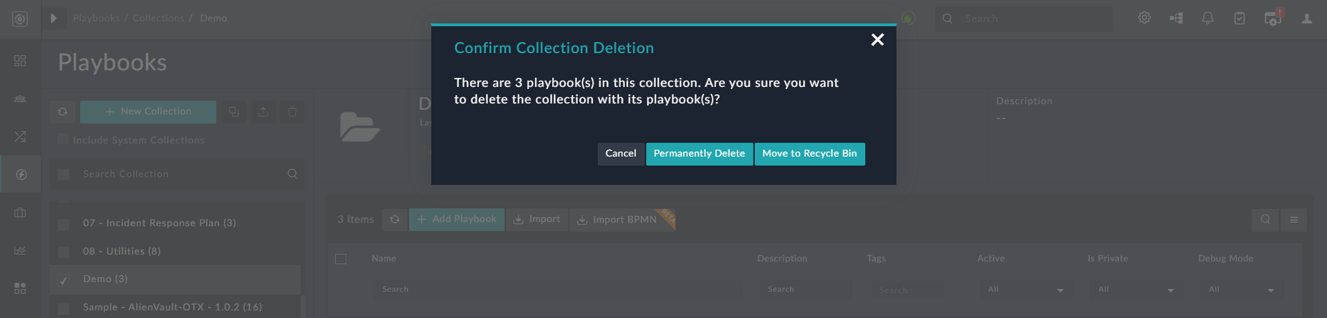

    • Delete: To delete a playbook collection, select the playbook collection and click Delete. Users with Delete permissions on the Playbooks module can delete playbook collections. You can choose to permanently delete the playbook collection or move the playbook collection to the Recycle Bin (soft deletion). Once you click Delete, FortiSOAR displays the following confirmation dialog:
      Confirm Collection Deletion dialog
      On the confirmation dialog, select your deletion preference based on which the playbook collection is either permanently deleted or moved to the recycle bin. Clicking Move to Recycle Bin moves all the playbooks in that collection to the recycle bin. Similarly, when you restore any playbook from a playbook collection, the collection containing those playbooks is also restored. For example, if you have a 'Demo' collection containing 3 playbooks, A, B, and C that you move to the recycle bin, and then restore B from the recycle bin, the Demo collection containing the B playbook gets restored. For more information on the Recycle Bin, see the "Administration Guide."
  5. On the <Playbooks Listing> page, you can perform the following operations without selecting a particular playbook:
    • Add Playbook: To add a new playbook to the collection, click Add Playbook, which opens the Add New Playbook dialog. In the Add New Playbook dialog, enter the required details that are mentioned in the Creating Playbooks topic.
    • Import - To import a playbook, click Import Playbook. The playbook must be in an appropriate JSON format. Any tags associated with the playbook are upserted into the system when you import a playbook.
    • Import BPMN - To import BPMN Shareable Workflows and convert them to FortiSOAR playbooks, click Import BPMN. For details, see the Importing the BPMN Shareable Workflows as FortiSOAR Playbooks topic.
    • Search: Click the Search icon to search for playbooks in the collection.

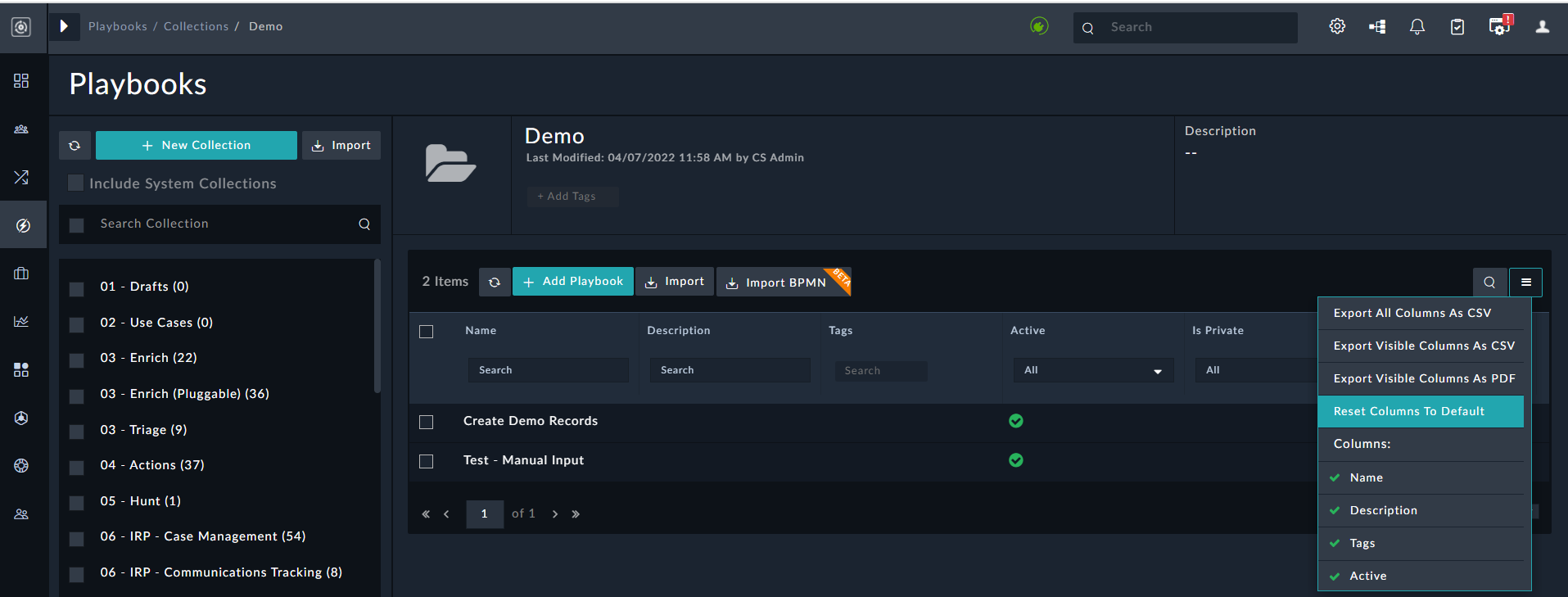

    • Other Actions: Click the More Options icon (More Options icon) to export records from the playbooks listing view in the csv or pdf format.
      Playbook - More Options Menu
      You can also reset the playbook record fields to the default fields specified for the playbook module, click the Reset Columns To Default option. You can include the Created By, Created On, Modified On, and Modified By fields in a playbook record for tracking purposes.

      • If you have cloned a playbook that contains a reference to other playbooks, either within the same collection or in different collections, then the references do not get automatically updated.
        However, if you have simultaneously clone playbooks in the same collection where either one references the other or they both reference each other, then the references get automatically updated. For example, consider a playbook named 'Escalate Alert and Create Incident' playbook that references the 'Update Alert Severity' playbook. Now, if you simultaneously clone both the 'Escalate Alert and Create Incident' and 'Update Alert Severity' playbooks to create the 'Escalate Alert and Create Incident (1)' and 'Update Alert Severity (1)' playbooks, all references in the 'Escalate Alert and Create Incident (1)' playbook are updated to 'Update Alert Severity (1)' playbook.

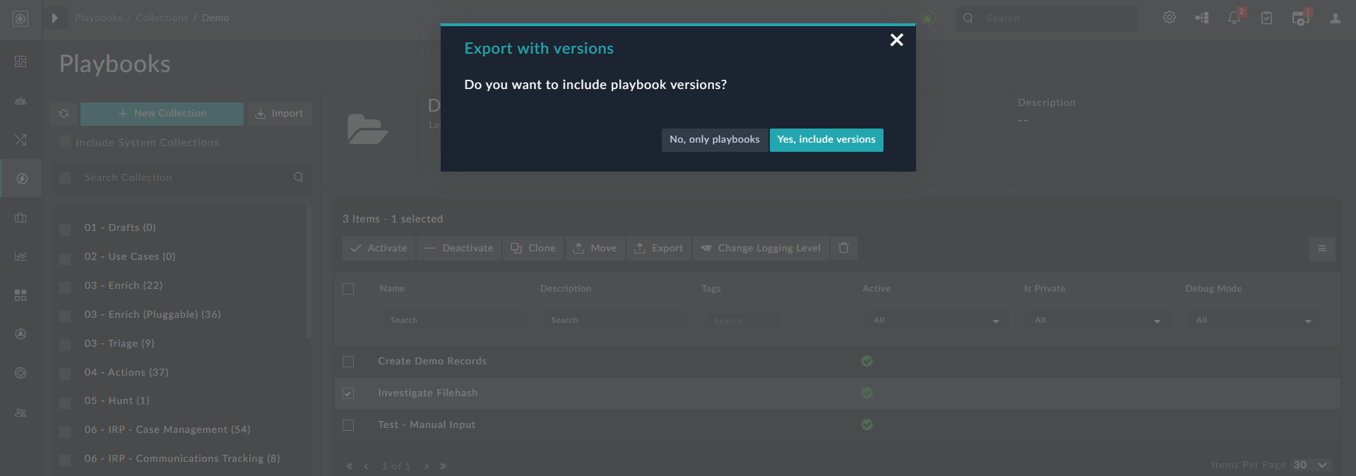

    • Export: To export playbooks, select playbooks on the <Playbooks Listing> page and click Export. FortiSOAR exports playbooks in JSON format. Any tags associated with playbooks are exported when you export a playbook.
    • Change Logging Levels: To change the logging level for playbooks, select playbooks on the <Playbooks Listing> page and click Change Logging Levels, which displays the Playbook Execution Log Level dialog. From the Select Execution Log Level field, select DEBUG or INFO as the logging levels for the playbooks, and click Apply. For more information on playbook logging levels, see the Setting the logging levels for playbooks topic.

  7. To edit a playbook, on the <Playbooks Listing> page, click the playbook that you want to edit.
    In the Playbook Designer, you can configure the following for the playbook:
    • Change the State of the playbook by clicking the Active box, for example, change the state of the playbook from Active to Inactive.
    • Change the Name of the playbook, by clicking the name box and updating the name.
    • Add or update the Description of the playbook, by clicking the description box and updating the same.
    • Add Tags to the playbook using the Add Tag box, or remove tags from the playbook.
    • Modify the trigger for the playbook, change or add steps or actions to the playbook. For information on the triggers and steps of a playbook, see the Triggers & Steps chapter.

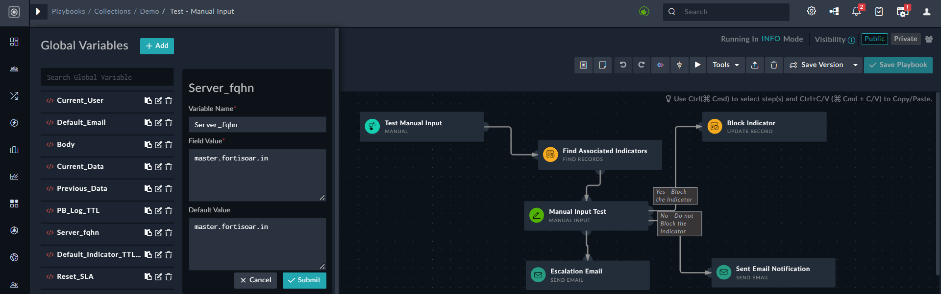

      • To add or delete global variables, use the Global Variables option.
        Note: To delete a global variable (or reference block) you must be assigned Read, Update, and Delete permissions on the Playbooks module. Users with only the Delete permission are unable to delete global variables (or reference blocks) since they cannot view the reference blocks or global variables.

    • Use the Auto-Align - Vertical and Auto-Align - Horizontal buttons to align the playbook vertically or horizontally.
    • The Undo and Redo buttons are very useful while building a playbook when there is a lot of trial and back and forth to be done. Use the Undo button or use Ctrl+z(Windows)/Cmd+z (Mac) to reverse changes made in a playbook, and use the Redo button or use Ctrl+y(Windows)/Cmd+shift+z(Mac) to reverse the steps that you have undone; therefore, you can use the Redo operation only after you have performed the Undo operation in a playbook. The playbook designer displays messages about the effect of the Undo/Redo operation in the bottom-right corner. When you perform bulk operations such as moving, cloning, or deleting a number of steps in one go, clicking Undo reverts the step modification. Similarly, if you have modified a step and saved it, clicking Undo, reverts the step modifications. Note that when editing inputs in the step argument form, the browser’s default change tracking is in effect; therefore, the Undo/Redo operations are applicable only after you save the step. Also, note that if you have made multiple changes in a small time period (around a second), then all these small changes are considered a single operation.
    • To add a block to a playbook, click the Create Block button, and to add a note for the playbook, click the Add Note button. For more information, see the Adding blocks and notes in the playbook designer topic.

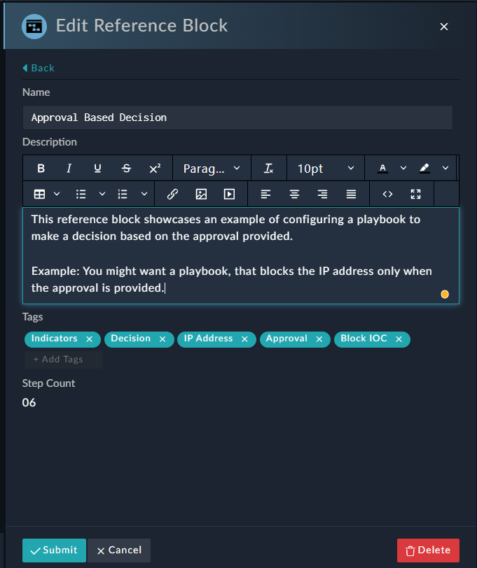

Viewing and editing existing Reference Blocks
FortiSOAR release 7.4.0 introduces 'Reference Blocks', which provide a useful set of references for users to make the process of building playbooks easier. Using reference blocks, users can get contextual aid while building playbooks, including relevant samples and help references.
Reference blocks contain reference or sample steps or steps that can be added to your playbook to help you build your playbook. FortiSOAR provides some ready-made samples for widely used steps, including trigger steps in playbooks.
The SOAR Framework solution pack contains several sample reference blocks to provide you with all the help you need while building your playbook. For detailed information about the SOAR Framework Solution Pack (SP), see the SOAR Framework SP documentation in the Content Hub.
To view all the ready-made reference blocks, i.e., both trigger blocks and non-trigger blocks, click Tools > Reference Blocks in your playbook designer:
Tools - Reference Blocks
Use the Search Reference Blocks field to search for reference blocks using tags (exact match supported), the name of the block, or its description.
Click > or click anywhere in the block row to expand a particular block and get information about the block; information includes the description, tags, and number of steps in that particular block:
Editing a reference block
To edit a particular block, expand the block and update the name, description, or tags of that block, then click Submit, or if you want to delete this block, click Delete and then click Confirm:
Editing an reference block and saving the block
If you add a reference block to a playbook and then make changes to any step or steps that form a block, then these changes are applicable only to the current playbook, and they are not reflected in the steps that form the reference (original) block.
You can export and import playbook blocks from one FortiSOAR environment to another using the Export Wizard and Import Wizard. For more information, see the Application Editor chapter in the "Administration Guide". Reference Blocks can also be included in Solution Packs, see the Solution Packs chapter in the "User Guide" for more information.

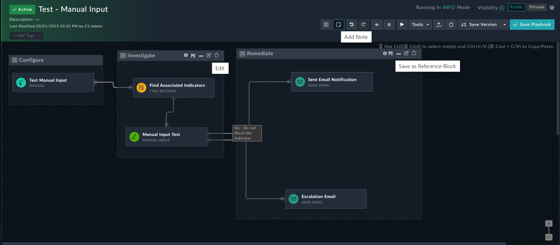

Adding Blocks
You can add blocks containing multiple playbook steps that achieve a logical group context in a logical workflow diagram. For example, the start or trigger step can form a trigger group, i.e., the 'Configure' group of the playbook; similarly, finding indicators associated with the record, getting the reputation of those indicators using a threat intelligence tool, and then presenting that reputation to users for a decision can form the 'Investigate' group of the playbook, and then performing appropriate actions based on the user's decision can form the 'Remediate' group of the playbook.
To add a block, open a playbook in the playbook designer, click the Create Block button, and then draw the box of the preferred size in the designer; that will create the block of that size and release the selection. Playbook steps placed by dragging and dropping the steps within the drawn box are added, by default, to the block. You can also drag and drop the block over the playbook steps that should be part of the block and then release the selection. When you release the selection, the Add Block dialog is displayed. In the Add Block dialog, enter the title of the block and, optionally, a description of the block, and click Add.
To associate a playbook step with a block, drag and drop the playbook step completely into the block. To remove a playbook step from a block, drag and drop the playbook step completely out of the block.
A block can be resized as per your requirement; however, when you are resizing the block, it is possible that you might add additional playbook steps to the block or remove steps from the block. Therefore, you must appropriately resize the block to ensure that playbook steps (appear with dotted lines) that are part of the block are completely within the block.
Steps that are part of a block appear with a dotted-line border, whereas steps that are not part of any block appear with a solid-line border:
You cannot have nested blocks, i.e., you cannot place one block within another block, and also a note cannot be part of a block. Playbook steps can be part of only a single block and not multiple blocks.
You can select the complete block and copy-paste the complete block, or you can select individual steps within the block and copy-paste them to your required destination playbook.
A block contains the following options:
  • Info: Displays additional information about the block, i.e., the description that you have added for the block.
  • Save as Reference Block: Saves the block as a 'Reference Block'. For more information, see the Saving a Block as a Reference Block topic.
  • Minimize/Maximize: Reduces or increases the size of the block.
  • Edit: Opens the Edit Block dialog, in which you can edit the name and/or description of the block.
  • Delete: Opens the Delete Block dialog using which you can delete the reference block. To delete a reference block (or global variable) you must be assigned Read, Update, and Delete permissions on the Playbooks module. Users with only the Delete permission are unable to delete reference blocks (or global variable) since they cannot view the reference blocks or global variables.
    Note that the 'Delete' operation deletes both the block and the playbook steps that are part of that block, once you click Confirm on the Delete Block dialog:
    Delete Block dialog
    However, if you want to only delete the block and not the steps within the block, you must move the steps out of the block, save the playbook, and then delete the block.
The following image is an example of Executed Playbook Logs containing blocks:
Executed Playbook Logs containing Blocks
In the Executed Playbook Logs, you can minimize/maximize the blocks and also hover on the information icon to get information about the block. If the description is added in the Add Block dialog, then that description is visible when you hover over the information icon. Each block also displays metrics such as the total execution time for each block. For example, the Investigate block in the above image displays 4 seconds 900 ms. The total execution time displayed is the aggregation of the time taken by each step within the block to complete its execution. The time taken for each step, whose status is 'finished', within the block is also displayed in the execution_time field of the respective step output. For example, in the following image, the 'Find Associated Indicators' step has taken 137 ms to complete:
Playbook step execution_time field
To enable the usage of blocks in other playbooks, you can choose to save a block as a 'Reference Block'. From the Block options, click the Save as Reference Block icon to display the Save as Reference Blocks dialog. The Save as Reference Blocks dialog displays the name and description that you specified while adding the block in the Name and Description fields, respectively. The name and description of the Reference Block can be distinct from the block's name and description, and therefore, you can choose to update both the name and description of the block in the Save as Reference Blocks dialog.
The name specified for Reference Blocks must be unique, with a minimum of 3 characters and a maximum of 140 characters.
Additionally, you can add tags associated with the reference block in the Tags field. Click Save to save the block as a Reference Block and add the same to the Reference Blocks list (Tools > Reference Blocks):
Saving a block as a reference block
If, in the future, there is a need to edit a Reference Block, it must be edited using Tools > Reference Blocks. For more information, see the Viewing and Editing Reference Blocks topic.
Adding Notes
You can also add a note in the playbook designer to provide more information about the playbook or to explain the playbook steps in greater detail. To add a note, click the Add Note button. In the Add Note dialog, enter the title for the note in the Name field and add the note information in the Description field. If you do not want to display the notes that are added to the playbooks in the 'Executed Playbooks Log', select the Hide Note in Executed Playbook Log option and click Add. If you want to display the notes that are added to the playbooks in the 'Executed Playbook Logs', then clear the Hide Note in Executed Playbook Log option. The following image is an example of an 'Executed Playbook Logs' containing a note:

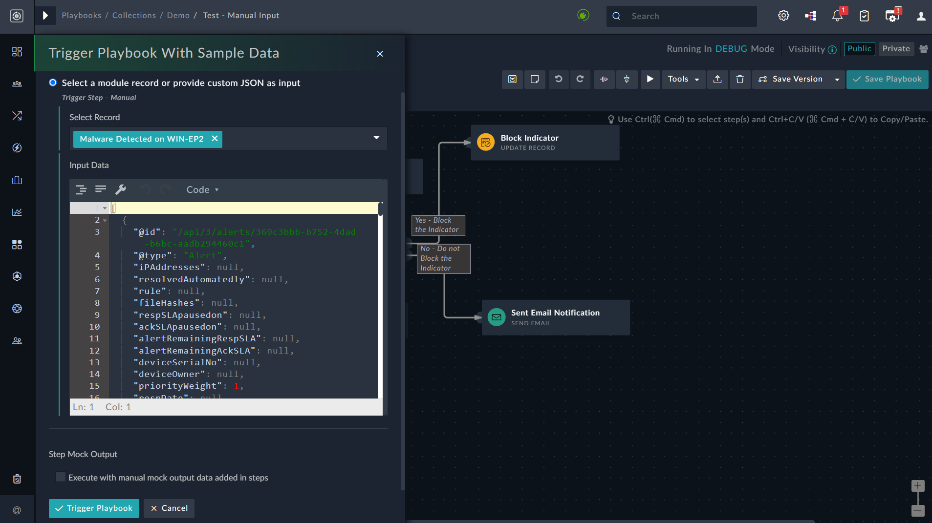

Playbook Debugging - Triggering and testing playbooks from the Designer

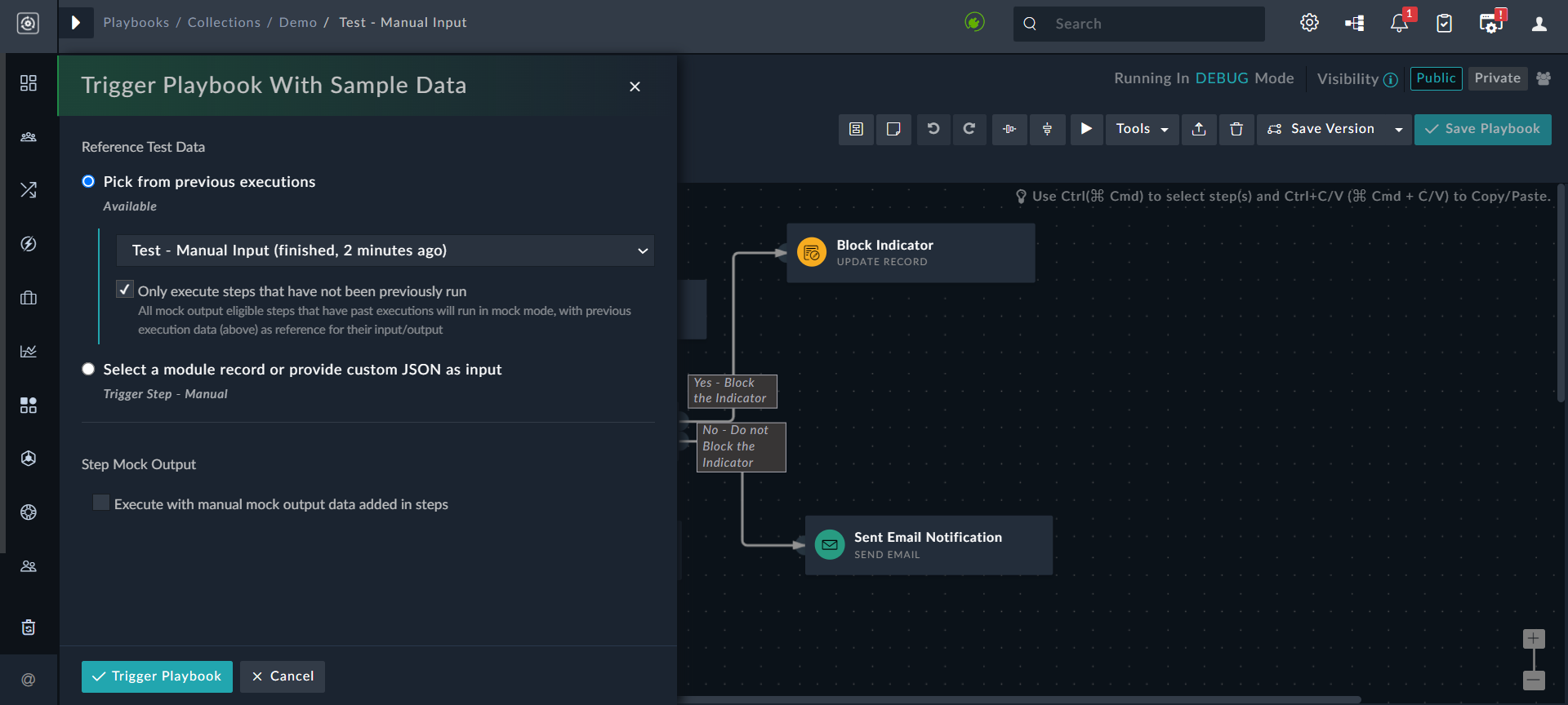

You can trigger playbooks directly from the playbook designer, making it easier for playbook developers to test and debug playbooks while building them. Playbook developers can now edit and run the playbook directly from playbook designer rather than having to navigate to the module, choose the record, select the playbook, trigger the playbook, and then return to the playbook designer to make any required changes to the playbook.
Caution
Triggering a playbook from the designer starts the execution of the playbook, which can cause changes to your data, leading to unintentional changes or loss of data. Therefore, it is important to review the playbook before it is triggered.
In release 7.4.2, the user experience of using mock output is streamlined, where the mock outputs can optionally be ingested from the most recent successful playbook execution, saving users the time of having to manually provide mock outputs on a step-by-step basis.This ensures users can test playbooks in development environments without needing to re-execute previously successful steps to obtain live results.
If you want subsequent playbooks to be run in the mock mode using the data from the previous execution, the playbook must be executed in the 'DEBUG' mode. To know more about playbook modes, see the Setting the logging levels for playbooks topic.
Only steps where 'Mock Output' can be enabled at the step level (see the Mock Output topic in the Triggers & Steps chapter) are supported for enabling mock output at the playbook level. Examples of steps that support mock output include create record, ingest bulk feed, reference playbook, and so on. Steps like manual task, wait, approval, and so forth do not support mock output.
To trigger a playbook from the playbook designer with mock output, do the following:
  1. Open the playbook in the playbook designer and click the Trigger Playbook with Sample Data button.
    Trigger Playbook with sample data button
  2. If you have run the playbook earlier in the 'Debug' mode, you can choose the Pick from previous executions option. Then, from the drop-down list, select the playbook execution with whose environment you want to trigger the playbook.
    When running steps that support "Mock Output" and have already been run, select the Only Execute Steps that have been previously run option to run the eligible steps in the 'Mock' mode to use the data from the prior executions as a reference for their input/output. Selecting this option displays steps that are run using mock data with a 'Mock' label in the 'Execution History'.
    OR
    You can choose the Select a module record or provide custom JSON as input option, where you can either select a module record or provide custom JSON input to trigger the playbook.
    If you have a playbook with a 'Manual' trigger step, then from the Select Record drop-down list, choose the record(s) using whose data, i.e., fields and values, you want to use to trigger the playbook.
    NOTE: Only the 30 most recent records are shown in the Select Record drop-down list.
    Trigger playbook with mock output using an existing record
    ELSE,
    Enter custom JSON in the Input Data field to trigger the playbook using custom JSON.
  3. Select the Execute with manual mock output data added in steps option to execute the playbook with the mock output data that has been added in the steps. Selecting this option displays steps that are run using mock output with a 'Mock' label in the 'Execution History':
  4. Click Trigger Playbook to trigger the playbook using the selected options.
The playbook can also use the "Mock Output" defined in the steps while running the playbook if you choose to Enable mock output.

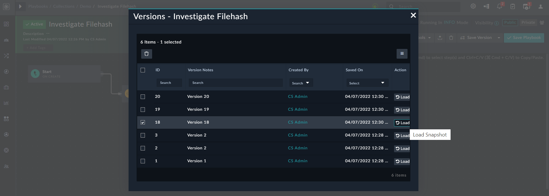

You can save versions of a playbook that you are creating or updating. Using versioning, you can save multiple versions of the same playbook. You can also revert your current playbook to a particular version, making working in playbooks more effective.
The maximum number of versions that can be taken, across all users working on a playbook is 20. If you or other users try to take more than 20 snapshots, a confirm dialog is displayed that prompts you to delete a version so that you can free space and save a new version, as shown in the following image:
Confirm dialog for deleting a snapshot
When you click Confirm, the Versions - <Name of Playbook> dialog is displayed. You can now choose the version(s) that you want to delete, click the Delete icon, and then click Confirm on the confirmation dialog and close the Versions - <Name of Playbook> dialog. This frees up space and you can now save a new version.
Versions Dialog
Using the Versions - <Name of Playbook> dialog, you can search for versions based on the notes you have added, and also filter versions by the Created By (user who has created the version), Saved On (time the version was saved) and action performed.

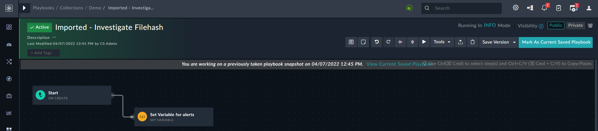

To take a snapshot and revert the playbook to a particular snapshot do the following:
  1. In the playbook in which you are working in the playbook designer, click Save Version.
  2. In the Save Version dialog, add a note that you want to associate with the version and click Save Version.
    It is recommended that you add meaningful notes for versions as these names will help you in identifying the snapshots when you want to revert to a particular version.
  3. To revert a version, click Save Version and then either click Revert to Last Saved or click View Saved Versions. Clicking Revert to Last Saved reverts the playbook to the last saved version of the playbook
    Clicking View Saved Versions displays the Versions - <Name of Playbook> dialog that allows you to choose the version of the playbook to which you want revert:
    Versions dialog
    In the Versions - <Name of Playbook> dialog, in the version row to which you want to revert, click Load.
    Once you click Load, that snapshot is loaded in the playbook designer, with a message: "You are working on a previously taken playbook snapshot...." as shown in the following image:
    Loading of a version in the playbook designer
  4. You can choose to view the playbook that is currently saved, by clicking the View Current Saved Playbook link, or you can click Save Current Version to make this version the current saved version of the playbook and continue to work on the playbook.
Exporting versions of your playbook
You can choose to export playbook collections or playbooks with saved versions of the playbooks. This is extremely useful while developing playbooks, especially if you erroneously delete a step in the playbook or you want to go back to the previous state of the playbook. Retaining the versions of playbooks while exporting playbooks enables you to load a snapshot of a previously saved version of the playbook into an imported playbook
You can choose to export playbook collections or playbooks with saved versions of the playbooks as shown in the following image:
Exporting a playbook with versions
Clicking Yes, include versions on the above dialog will export playbooks or playbook collections with the saved versions of the playbook.
You can then import the playbook and then open that playbook in the playbook designer, you can see the previously saved versions of the playbook by clicking Save Version > View Saved Versions. This opens the Versions dialog as shown in the following image:
Save Version - View Saved Versions
You can load a snapshot of a previously saved version of playbook in the Versions dialog by selecting the snapshot that you want to load in the playbook designer and clicking Load. This will display a message such as "You are working.....playbook snapshot...." as shown in the following image:
Viewing a previous snapshot of a playbook
You can save this version of the playbook and continue to work on it or you can click View Current Saved Playbook to revert back to the state of the playbook when it was last saved.

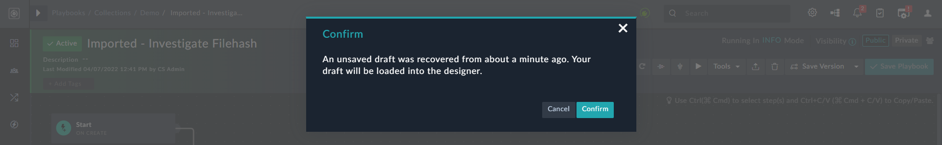

Playbook recovery
FortiSOAR autosaves playbooks so that you can recover playbook drafts in cases where you accidentally close your browser or face any issues while working on a playbook. These unsaved (autosaved) drafts do not replace the current saved version of the playbook and only ensure that you do not lose any of your work done in the playbook, by providing you the ability to recover the drafts.
Playbook recovery in FortiSOAR is user-based, which ensures that users see their own unsaved drafts of the playbook. Since it is browser-based, it comes into effect as long as the same browser instance is used by the user. Also, playbook drafts might not be saved if you are working in the "Incognito" mode.
By default, FortiSOAR saves playbook drafts 15 seconds after the last change. However, you can ask your administrator to change this time across all playbooks by modifying the time, in seconds, on the Application Configuration tab in the System Configuration page. The minimum time that your administrator can set for saving playbook drafts is 5 seconds after the last change. You can also choose to disable (and later enable) playbooks recovery for all playbooks. For more information, see the System Configuration chapter in the "Administration Guide."
If the browser data is cleared, then the autosaved drafts will get deleted.
To recover an unsaved draft of the playbook, reopen that playbook in the playbook designer you will be prompted to confirm whether you want to recover the draft of the playbook as shown in the following image:
Confirm recovery of autosaved version of Playbook
Once you click Confirm on the Confirm dialog, the autosaved version of the playbook is loaded in the playbook designer, and you can then choose to save this playbook using Save Playbook and make it the current working copy.

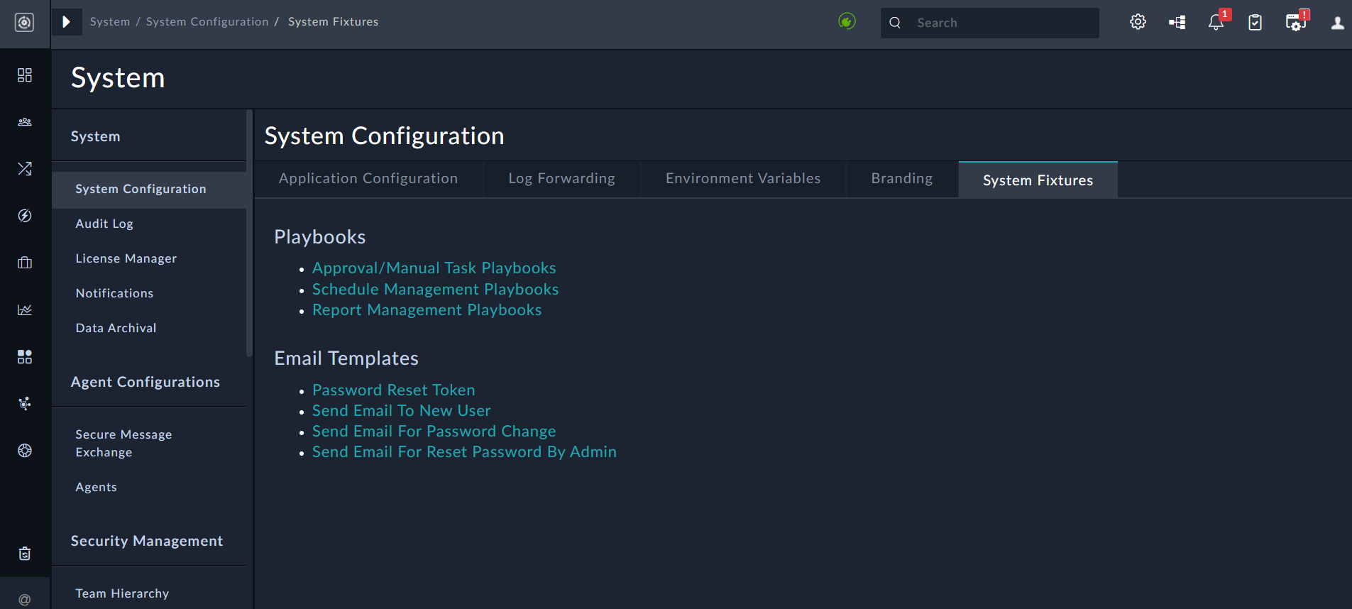

System Playbooks
FortiSOAR includes some system playbook collections that are used to automate tasks, such as the Schedule Management Playbooks collection can be used to schedule various tasks such as cleaning up playbook execution history, purging integration logs, etc. Or, you can use the Report Management Playbooks collection to manage generation of reports. For example, the Generate Report By Scheduler playbook generates reports based on schedules that you have specified. You can also reference system playbook from other playbooks.
The FortiSOAR UI includes links on the System Configuration page to the various playbook collections and templates, which are included by default when you install your FortiSOAR instance. Administrators can click the Settings (Setting icon) icon to open the System Configuration page and click the System Fixtures tab to access the system playbooks or fixtures. The System Fixtures page contains links to the system playbook collections and templates. Administrators can click these links to easily access all the system fixtures to understand their workings and make changes in them if required. For example, to access Schedule Management Playbooks, click the Schedule Management Playbooks link.
System Fixtures tab
Caution
You can modify system playbooks as per your requirements. However, incorrectly modifying any system playbook can affect FortiSOAR functionality.
For example, if you want to modify the default email signature, which is currently Regards, FortiSOAR Admin, for a system playbook, open the playbook and double-click on its Send Email step. In the Send Email step, in the Content field, modify the signature as per your requirements and click Save.
Tooltip
In the system playbook (or any playbook) that is sending an email, ensure that you have used the Server_fqhn global variable in the Send Email step.
When you are using a system playbook that sends an email, for example, when an alert is escalated to an incident, and an Incident Lead is assigned, then the system playbook sends an email to the Incident Lead specified. The email that is sent to the Incident Lead contains the link to the incident using the default hostname, which is the hostname that you had specified or that was present when you installed FortiSOAR. To ensure that the correct hostname is displayed in the email, you must update the appropriate hostname as per your FortiSOAR instance, in the playbook, using the Playbook Designer as follows:
  1. Open the Playbook Designer.
  2. Click Tools > Global Variables to display a list of global variables.
  3. In the Global Variables pane, search for the Server_fqhn global variable, then click the Edit icon in the Server_fqhn global variable, and in the Field Value field add the appropriate hostname value.
    Editing global variables in the Send Email steps
    You can optionally specify a default hostname value in the Default Value field.
  4. Click Submit.
    This adds the updated hostname for your incident and then when a system playbook sends an email the link contains the correct hostname.
Note Playbooks that contain a reference to the approvalHost global variable fail with the 'approvalHost variable undefined' error, since the approvalHost global variable is removed from release 7.2.0 onwards. To resolve this error, replace the approvalHost global variable in the playbook with the Server_fqhn global variable.
For information about all the system playbook collections and templates, which are included by default when you install your FortiSOAR instance, see the System Configuration topic in the "Administration Guide."
  7. Add playbook steps.
    Adding steps
FortiSOAR provides you with the ability to convert a BPMN Shareable Workflows to FortiSOAR playbooks. Business Process Model and Notation (BPMN) is a tool using which you can create flowcharts, and these flowcharts tend to be specific towards cybersecurity workflows. Therefore, this feature provides you with the advantage of importing your BPMN workflows and directly converting them into FortiSOAR playbooks, without the need to again create the same workflow in FortiSOAR.
The feature is introduced as a "BETA" feature with more enhancements being planned to be added in the subsequent releases to make the BPMN import more robust.
Import the BPMN Shareable Workflows into FortiSOAR as follows:
  1. Export your BPMN Shareable Workflows from your tool, such as Flowable, Camunda, or Signavio.
    BPMN workflows are exported in the XML format.
        Import BPMN dialog
        Import BPMN with Replace existing playbook option
        FortiSOAR displays the imported workflow in the Playbook Designer as shown in the following image:
        Imported BPMN workflow in Playbook Designer
        Now you can edit the playbook as required in the playbook in FortiSOAR and easily create the automated workflow.

  4. For playbook collections, you can perform the following operations on selected playbook collections:
    • Clone: To clone playbook collections, select the playbook collections and click Clone. While using sample playbooks from connectors and solution packs, it is recommended that you clone the playbooks before editing them as per your requirements, since the sample playbook collections get overwritten while upgrading the connector or solution pack. Cloning the playbook collection clones all the playbooks within that collection. within the playbook. You can select more than one playbook collection to clone at a time. FortiSOAR clones the playbook collection and saves it with the name %Playbook Name% copy-1(No of playbooks in collection). Note the following for playbook references within playbook collections:
      • If you have cloned a playbook collection that contains playbooks that reference where either one references the other or they reference each other, then the references get automatically updated. For example, consider a playbook collection named 'Demo (5)' containing playbooks named 'Enrich Indicators' and 'Update Alert Severity' where the 'Update Alert Severity' playbook references the 'Enrich Indicators' playbook. Now, if you clone the 'Demo (5)' playbook collection to create the 'Demo copy-1 (5)' collection, any references to the 'Enrich Indicators' playbook in the 'Update Alert Severity' playbook are updated to reference the 'Enrich Indicators' playbook in the 'Demo copy-1 (5)' collection.
      • If you have cloned a playbook collection that contains playbooks that reference playbooks in a different collection, then the references do not get automatically updated.
        However, if you simultaneously clone playbook collections containing playbooks where either one references the other or they reference each other, then the references get automatically updated. For example, consider a playbook collection named 'Demo (5)' containing the 'Escalate Alert and Create Incident' playbook that references the 'Update Alert Severity' playbook in the 'Incident Management (3)' playbook collection. Now, if you simultaneously clone both the 'Demo (5)' and 'Incident Management (3)' playbook collections to create the 'Demo copy-1 (5)' and 'Incident Management copy-1 (3)' collections, any references to the 'Update Alert Severity' playbook in the 'Escalate Alert and Create Incident' playbook are updated to reference the 'Update Alert Severity' playbook in the 'Incident Management copy-1 (3)' collection.
    • Export: To export a particular playbook collection, select the playbook collection and click Export. Any tags associated with a playbook collection are exported when you export a playbook collection. FortiSOAR exports the playbook collection in JSON format.
    • Use the Tools menu to enhance your playbook:
      Playbook Designer: Tools Menu
      • To add parameters, use the Edit Parameters option.
      • To view or edit existing reference blocks, use the Reference Blocks options. For more information, see the Viewing and Editing Reference Blocks topic.
      • To view the execution history of the playbook, use the Execution History option. For more information, see the Debugging and Optimizing Playbooks chapter.
      • To change the execution priority for a playbook, use the Execution Priority option. For more details, see the Changing the prioritization of playbook execution topic.
      • To apply a Jinja template to a JSON input and then render the output, use the Jinja Editor option. You can thereby check the validity of the jinja and the output before you add the jinja to the playbook. For more information, see the Dynamic Values chapter.
  8. (Optional) Other actions that you can perform in the playbook designer are:
    • Use the Export button to export the playbook in JSON format.
    • Use the Delete button to delete the playbook.
    • Use the Trigger Playbook With Sample Data button to trigger the playbook from the playbook designer. For more details, see the Playbook Debugging - Triggering and testing playbooks from the Designer topic.
  9. Once you have completed updating the playbook, click Save Playbook.

  • You can use the Auto-Align - Vertical and Auto-Align - Horizontal buttons to align the playbook vertically or horizontally. You can use these buttons to make your playbook look neat and organized, which is especially useful for very large playbooks where playbook readability might be an issue.

Adding Blocks
    Delete Block dialog
Caution
    OR
    ELSE,

  • Low priority tasks do not get executed if there are high priority tasks.
To set a priority for playbook prioritization, open that playbook in the playbook designer. Click Tools > Execution Priority. In the Execution Priority dialog, you can set the playbook execution prioritization to High, Medium, or Low:
Setting the playbook execution priority
To list the number of messages (workflow count) in the 'celery' queue, use the following command:
rabbitmqctl list_queues -p fsr-cluster --no-table-headers --silent | grep -E "^\s*celery\s+" | awk '{print $2}'
When there is no queue, it will display 0 (default), and when the queue builds up, it will display the queue count number such as 10, 25, etc.
Notes:
  • All 'sync' reference playbooks automatically inherit the priority of their parent playbooks, thereby ignoring any preset priority.
  • If you update the execution priority of a scheduled playbook, then you require to edit and resave the schedules associated with that playbook.
  • If you want to schedule a data ingestion playbook, then you must set the priority of the data ingestion playbook before scheduling the same.
FortiSOAR also integrates with a GUI-based celery monitoring tool called Flower, using which you can monitor and administer celery cluster and playbook execution queues. You can start a Flower web server using the following process:
cd /opt/cyops-workflow/sealab
../.env/bin/flower -A sealab --port=5555
Note: Ensure that port that you are specifying in the URL, 5555 in the above sample, is opened in your firewall and can be accessed.
Live User implementation in Playbook Designer
The playbook designer implements Live Users, which means that the playbook designer displays users who are also currently working on the same playbook. Therefore, when you open a playbook and if there are other users who are working on the same playbook apart from you, then the playbook designer will display the users working on the playbook, as well as the number of sessions that are active for each user. Live Users also notifies users that are working on the same playbook, if any other user or session has saved modifications to the playbook, so that the user can refresh the playbook before working on the same, thereby ensuring that users work on the latest version of the playbook. Users can also save versions of their current modified state of the playbook, thereby providing users with the ability to merge their changes.
Live Users - Playbook Designer
Live Users has the following benefits:
  • Users are notified of other users or sessions that are active on the same playbook.
  • Users work on the latest version of the playbook, and they do not lose their updates made to the playbook.
Saving versions of your playbook
Versions Dialog
    Versions dialog
Playbook recovery
System Playbooks
System Fixtures tab
Caution
Tooltip
  4. Click Submit.
