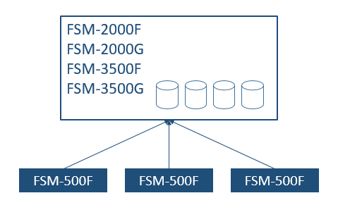

Hardware Appliance EPS Test with FortiSIEM Event Database
The test beds is shown below. Scripts generated events on FSM-500F Collectors, which parsed those events and sent them to the appliances.
The results are shown below:
Event Sender
FortiSIEM HW ApplianceHardware Spec
Collector Model
CountEPS/CollectorSustained EPS without Loss
FSM-2000F2000F - 12vCPU (1x6C2T), 32GB RAM, 12x3TB SATA (3 RAID Groups)FSM-500F35K15K
FSM-2000G2000G - 40vCPU(2x10C2T), 128GB RAM, 4x1TB SSD (RAID5), 8x4TB SAS (2 RAID50 Groups) FSM-500F36K20K
FSM-3500G
3500G,48vCPU(2x12C2T),128GB RAM,24x4TBSATA (3 RAID50 groups)FSM-500F
6
8K
40K
Hardware Appliance EPS Test with ClickHouse
The test bed is shown below. Scripts generated events on FSM-500F Collectors, which parsed those events and sent to the appliances.
Event Sender
FortiSIEM HW Appliance Hardware Spec
Collector Model
Count EPS/Collector Sustained EPS without Loss
FSM-2000F 2000F - 12vCPU (1x6C2T), 32GB RAM, 12x3TB SATA (3 RAID Groups)
FSM-500F
3 5K 15K
FSM-2000G 2000G - 40vCPU(2x10C2T), 128GB RAM, 4x1TB SSD (RAID5), 8x4TB SAS (2 RAID50 Groups)
FSM-500F
6 6K 40K
FSM-3500G
FSM-500F
6
8K
40K
Notes:
  1. For FSM-2000G, event ingestion speed increased two fold with ClickHouse compared to FortiSIEM EventDB. ClickHouse event database made better utilization of the vCPUs in the system.
  2. Since FSM-2000F has fewer vCPU compared to FSM-2000G, the performance of both FortiSIEM EventDB and ClickHouse are identical. The appliance is CPU bound.
  3. For FortiSIEM 3500G, the insert performance of FortiSIEM EventDB and ClickHouse are identical as FortiSIEM EventDB could also use disk striping for better I/O.

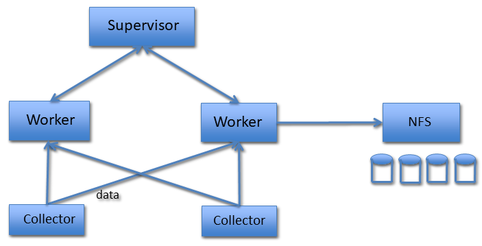

Virtual Appliance EPS Test with FortiSIEM Event Database
All tests were done in AWS. The following hardware was used.
Type AWS Instance Type Hardware Spec
Collector c4.xlarge 4vCPU, 7 GB RAM
Worker c4.2xlarge 8vCPU, 15 GB RAM
Super m4.4xlarge 16vCPU, 64 GB RAM, CMDB Disk 10K IOPS
NFS Server c4.2xlarge 8vCPU, 16 GB RAM, 10K IOPS
The test bed is as follows:
The following result shows 10K EPS sustained per Worker with over 20K CMDB Devices.
Event Sender Event Handler
Collector Count EPS/Collector Monitored Device/Collector Super Workers Orgs CMDB Device Sustained EPS without Loss
150 200 150 1 3 150 22,500 30K

Sizing Online Deployments
EventDB based deployment, Elasticsearch, and ClickHouse based deployments are available.
EventDB Based Deployment
Processing Requirement
Requirement Recommendation
EPS Deployment HW Model SW Configuration
Nodes HW Per Node (vCPU, RAM) NFS IOPS
Up to 5K Hardware FSM-2000F
Up to 5K Software All-in-one 16, 24GB
5K – 10K Hardware FSM-2000F
5K – 10K Software Supervisor 16, 24GB
1 Worker 8, 16GB 2000
10K – 15K Hardware FSM-3500F
10K – 15K Software Supervisor 16, 24GB
2 Workers 8, 16GB 3000
15K – 25K Hardware FSM-3500F
15K – 25K Software Supervisor 16, 24GB
3 Workers 16,16GB 5000
25K – 35K Software Supervisor 16, 24GB
4 Workers 16, 16GB 7000
Add 10K EPS Software Add 1 Worker 16, 16GB Add 2000 IOPS
10K – 15K Hardware FSM-3500G
15K – 25K Hardware FSM-3500G
3 Workers 16, 16GB 5000
Event Sender
Collector Model
FSM-3500G
6
8K
40K
