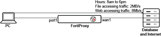

This example shows how to apply interface-based traffic shaping to web and file accessing traffic according to a schedule:
  • The link speed of the wan1 interface is 10 Mb/s.
  • File access can use up to 2 Mb/s from 8:00 AM to 6:00 PM.
  • Web access can use 8 Mb/s from 8:00 AM to 6:00 PM.

Defining the available bandwidth on an interface
In this example, the link speed of the wan1 interface is 10 Mb/s.

      set day sunday monday tuesday wednesday thursday friday saturday
  2. Create the traffic class IDs:
    config firewall traffic-class
        edit 3
            set class-name "Web Access"
        edit 4
            set class-name "File Access"
  3. Create the web and file accessing traffic shaping policies:
    config firewall shaping-policy
            set name "web_access_day_hours"
            set comment "Limit web accessing traffic to 8Mb/s in day time"
            set service "HTTP" "HTTPS"
            set schedule "Day_Hours"
            set dstintf "wan1"
            set class-id 3
            set srcaddr "all"
            set dstaddr "all"
        edit 3
            set name "file_access_day_hours"
            set comment "Limit file accessing traffic to 2Mb/s during the day"
            set service "AFS3" "FTP" "FTP_GET" "FTP_PUT" "NFS" "SAMBA" "SMB" "TFTP"
            set dstintf "wan1"
            set class-id 4
            set srcaddr "all"
            set dstaddr "all"
Allocating bandwidth to the shaping classes
A traffic shaping profile defines the guaranteed and maximum bandwidths each class receives. In this example, file access can use up to 2 Mb/s and web access can use 8 Mb/s.
To create a traffic shaping profile using the GUI:
  1. Go to Policy & Objects > Traffic Shaping, select the Traffic Shaping Profiles tab, and click Create New.
  2. Enter a name for the profile, such as Day_Hours_Profile.
  3. Configure a default traffic shaping class:
    This class has a high priority, meaning that when the other classes have reached their guaranteed bandwidths, this default class will use the rest of the available bandwidth.
    1. Enter the class ID you specified in the Putting the traffic into shaping classes section.
    2. Configure the following settings, then click OK:
      Guaranteed bandwidth
      30
      Maximum bandwidth
      100
      Priority
      High
  4. Configure a web accessing traffic shaping class:
    When other types of traffic are competing for bandwidth, this class is guaranteed to 6 Mb/s, or 60% of the bandwidth.
    1. In the Traffic Shaping Classes table click Create New.
      Traffic shaping class ID
      Web Access
      60
      Maximum bandwidth
      80
      Priority
      Medium
  5. Configure a file accessing traffic shaping class:
    When other types of traffic are competing for bandwidth, this group is guaranteed to 1 Mb/s, or 10% of the bandwidth.
      File Access
      10
      Maximum bandwidth
      20
      Priority
      Medium
  6. Click OK.
To create a traffic shaping profile using the CLI:
config firewall shaping-profile
    edit "Day_Hours_Profile"
        set default-class-id 2
        config shaping-entries
                set class-id 2
                set guaranteed-bandwidth-percentage 30
                set maximum-bandwidth-percentage 100
                set class-id 3
                set priority medium
                set guaranteed-bandwidth-percentage 60
                set maximum-bandwidth-percentage 80
            edit 3
                set class-id 4
                set priority medium
                set guaranteed-bandwidth-percentage 10
                set maximum-bandwidth-percentage 20
To set the bandwidth of the wan1 interface in the GUI:
  1. Go to Network > Interfaces.
  2. Edit the wan1 interface.
  3. Under Traffic Shaping, enable Outbound shaping profile and select the profile that you just created, Day_Hours_Profile.
  4. Enable Outbound Bandwidth and set it to 10000 Kbps.
  5. Click OK.
To set the bandwidth of the wan1 interface in the CLI:
config system interface
    edit "wan1"
        set egress-shaping-profile "Day_Hours_Profile"
        set outbandwidth 10000
