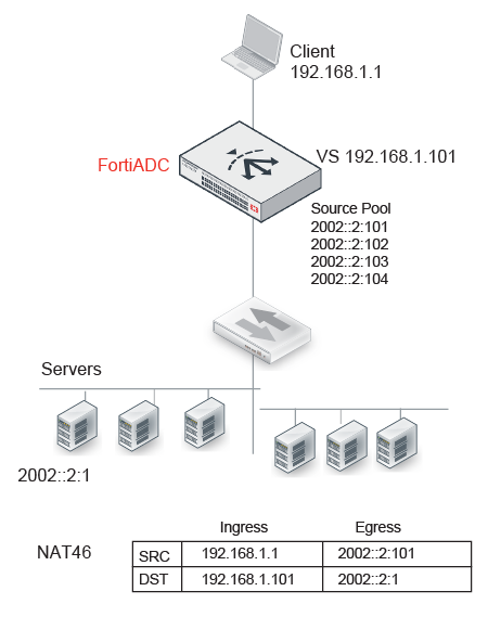

Example: NAT46 (Layer 4 virtual servers)
NAT46 (Layer 4 virtual servers) illustrates full NAT with NAT46. The IPv6 client connects to the virtual server IPv4 address. The source IP / destination IP pair in the packets received is SRC 192.168.1.1 / DST 192.168.1.101. The NAT module translates the source IP address to the next available IPv6 address in the source pool—in this example, 2002::2:1001. It translates the destination IP address to the IPv6 address of the real server selected by the load balancer—in this example, 2002::2:1.
The system maintains this NAT table and performs the inverse translation when it receives the server-to-client traffic.
| Features | Notes |
Profile |
Not Supported: FTP |
ICMP |
ICMP traffic is dropped. |

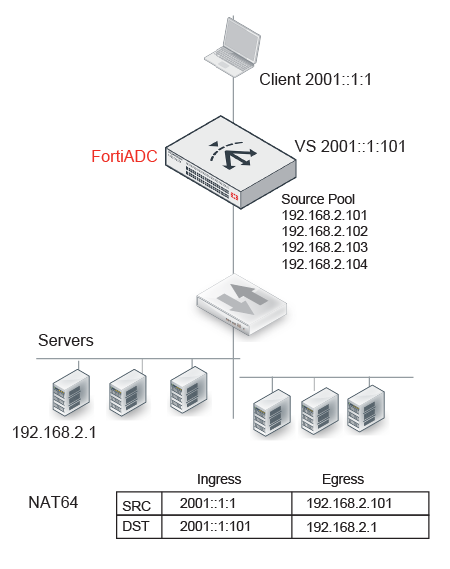

Example: NAT64 (Layer 4 virtual servers)
NAT64 (Layer 4 virtual servers) illustrates full NAT with NAT64. The IPv6 client connects to the virtual server IPv6 address. The source IP / destination IP pair in the packets received is SRC 2001::1:1 / DST 2001::1:101. The NAT module translates the source IP address to the next available IPv4 address in the source pool—in this example, 192.168.2.101. It translates the destination IP address to the IPv4 address of the real server selected by the load balancer—in this example, 192.168.2.1.
| Features | Notes |
Profiles |
ICMP |
Security |
Not Supported: IP Reputation, DoS protection, Security logs and reports |
