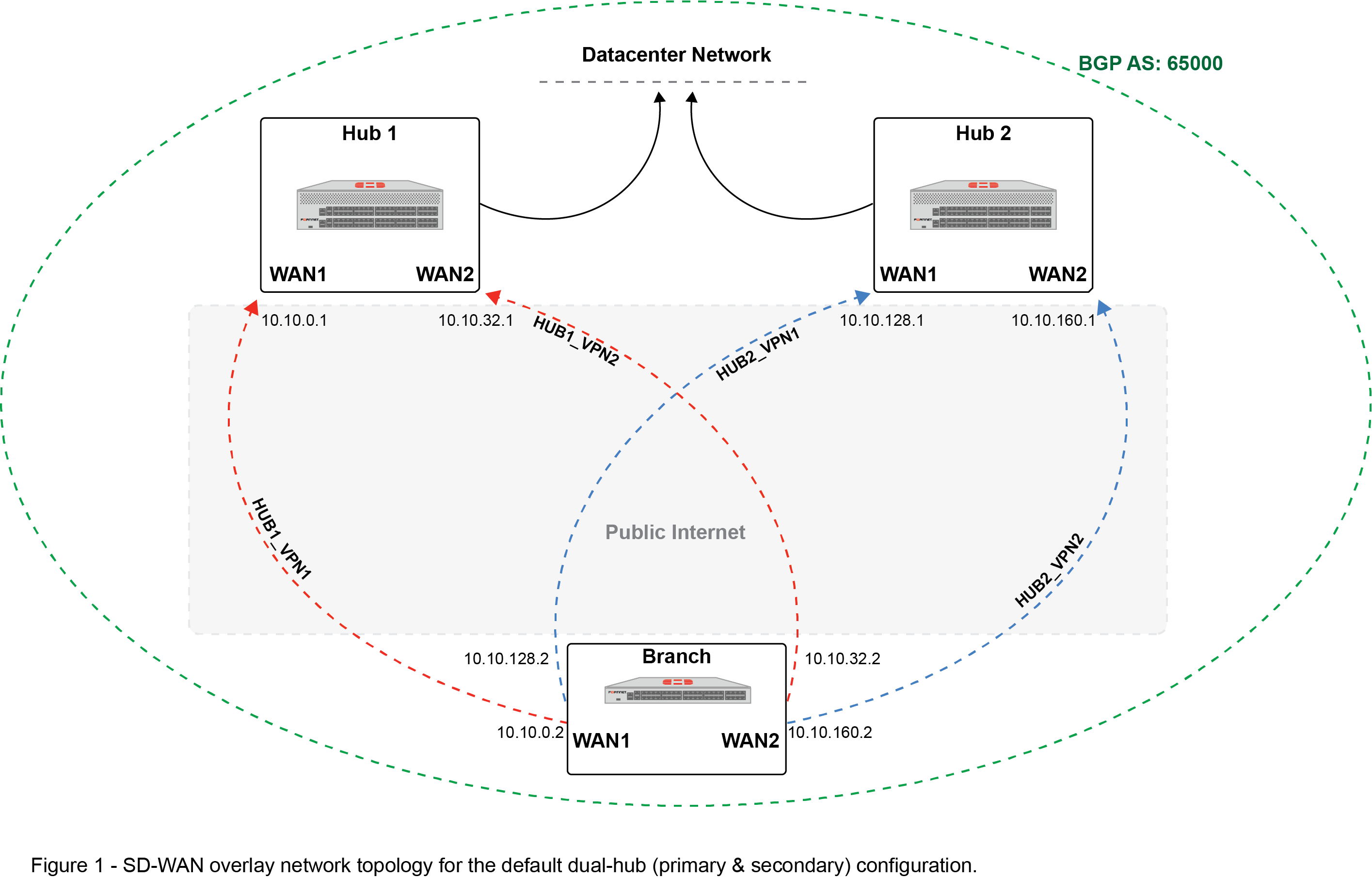

In dual-hub topologies, overlay subnets are assigned so that hub 1 receives the first half and hub 2 receives the second. The colors in the table above for "5 - 8 underlays" is an example of how the overlays are assigned when there are two hubs: Blue = Hub 1. Red = Hub 2.

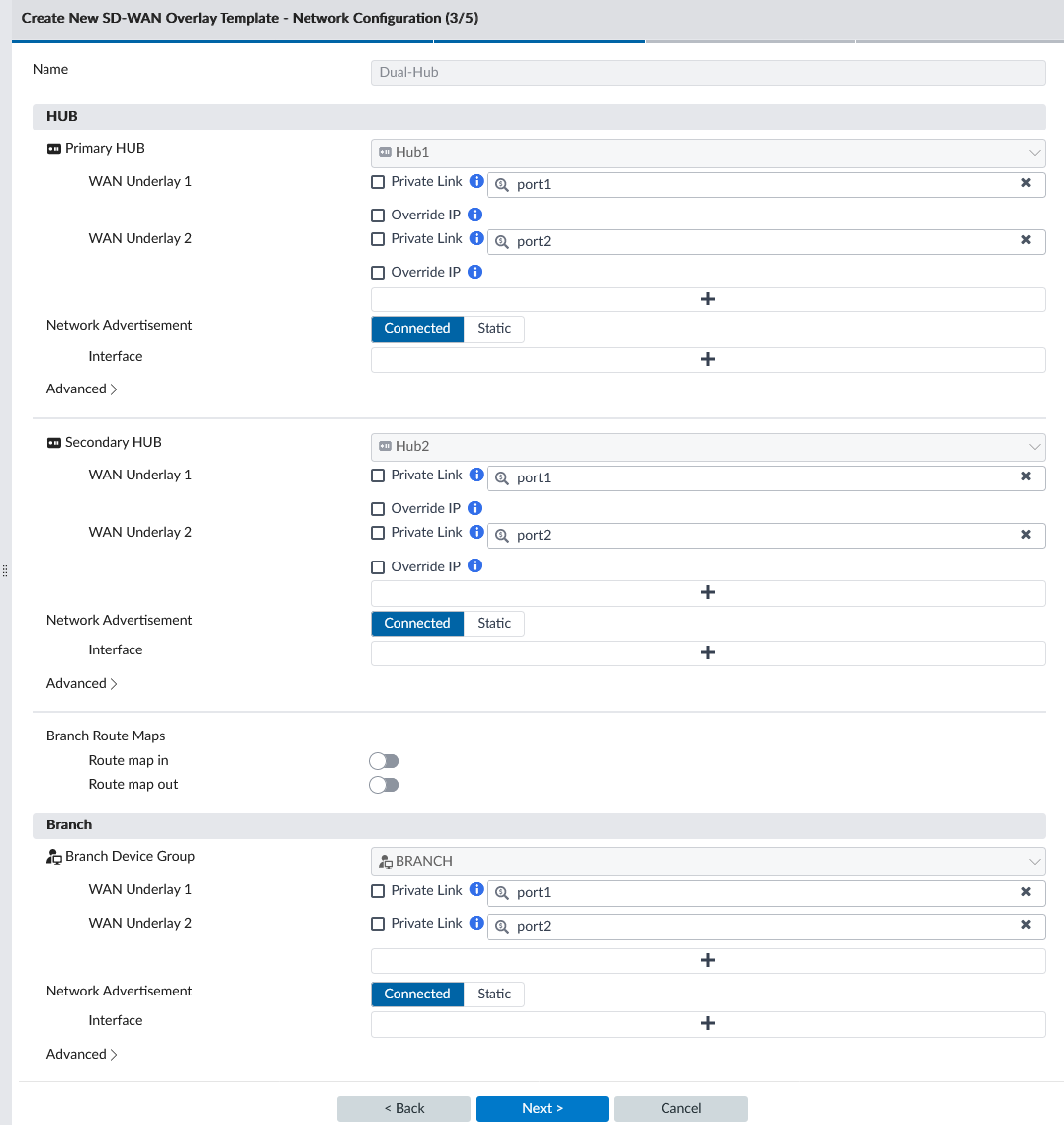

Examples
The wizard includes topologies for single-hub, dual-hub (primary & secondary), dual-hub (primary & primary), and multi-hub (3 or 4 hubs). Here you can find an example of how the IP overlay network is designed in a dual-hub (primary & secondary) and single-hub topology using the default overlay network.
Dual-hub (primary & secondary)
In this example, four underlays (two for the primary hub and two for the secondary hub) are configured in the default dual-hub (primary & secondary) topology.
With this configuration:
  • Hub 1 uses overlay subnet 1 (10.10.0.0/19) for HUB1_VPN1 and subnet 2 (10.10.32.0/19) for HUB1_VPN2.
  • Hub 2 uses overlay subnet 5 (10.10.128.0/19) for HUB2_VPN1 and subnet 6 (10.10.160.0/19) for HUB2_VPN2.
  • Subnets 3, 4, 7, and 8 are not used because the wizard has only been configured with four underlays.
The topology diagram below demonstrates how the overlay subnets are applied in this dual-hub scenario:

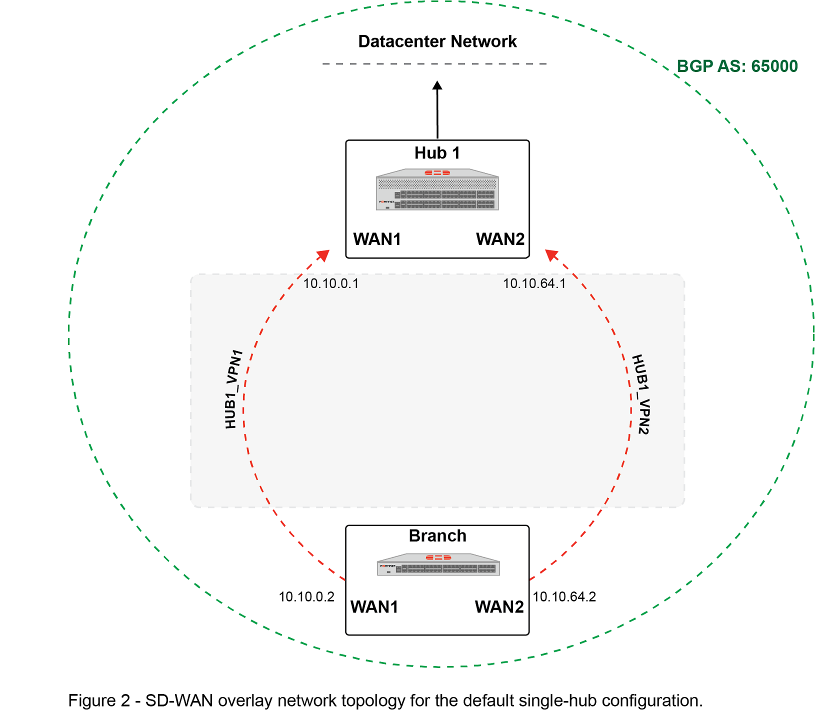

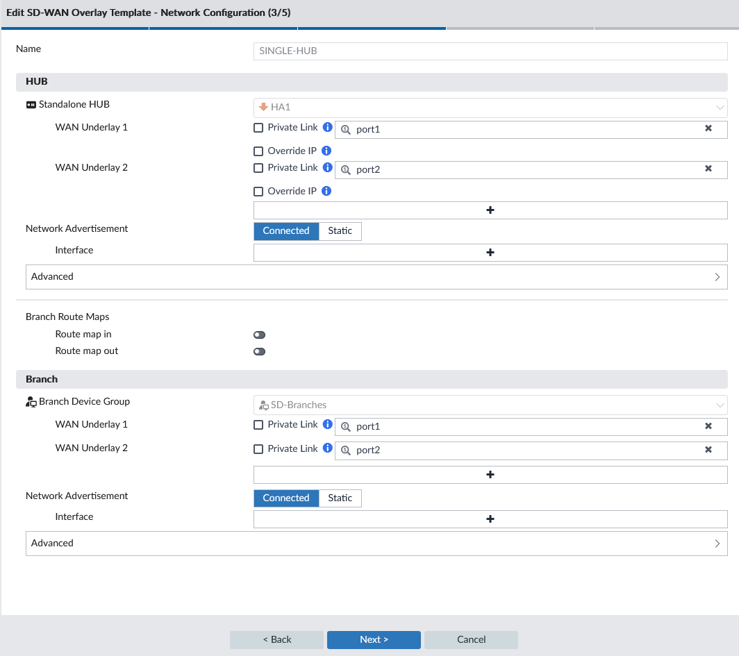

Single-hub
In single-hub topologies, at least four overlay networks are created by the wizard. If more than four WAN underlays are configured, the overlay network will be further subnetted to allow for additional overlay subnets to be created.
In this example, two physical WAN underlays are configured in this single-hub topology.
  • Hub 1 uses overlay subnet 1 (10.10.0.0/18) for HUB1_VPN1 and subnet 2 (10.10.64.0/18) for HUB1_VPN2.
  • Subnets 3 and 4 are not used because the wizard has only been configured with two underlays.
The topology diagram below demonstrates how the overlay subnets are applied in this single-hub scenario:
Single-hub
