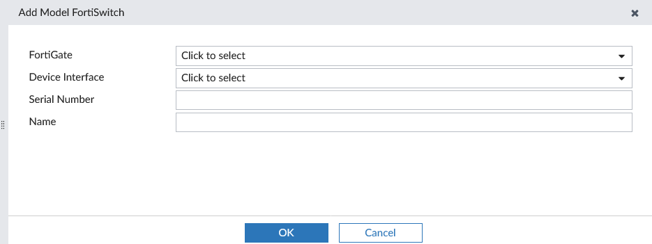

  1. Go to FortiSwitch Manager > Managed FortiSwitches.
  2. From the Create New dropdown, select FortiSwitch. The Add Model FortiSwitch pane is displayed.
  3. Configure the following settings, and click OK:
    FortiGate
    Select the FortiGate device or VDOM from the drop-down.
    Device Interface
    Select the port where the FortiSwitch will be connected.
    Serial Number
    Specify the FortiSwitch serial number.
    Name
    Specify a name.
    Enforce Firmware Version
    Toggle ON to enforce a firmware version and select the firmware version from the drop-down menu. Toggle OFF to disable this feature.
    Adding model devices using a wildcard SN
    FortiSwitch model devices can be added using wildcard serial numbers. The wildcard SN format is: PREFIX****000001
    • PREFIX: The first 6 digits of the device's serial number. The prefix must be valid.
    • *****: The wildcard characters.
    • 000001: The valid characters.
    For example: S108DV****000001.
    Tooltip
    Enforcing firmware versions
    Firmware version enforcement can be configured using a firmware template with the On Board type schedule. See Creating firmware templates.
    A model FortiSwitch is created and added to the managed FortiGate.
  4. Click Close to close the Add Model FortiSwitch pane.
  5. Configure the switch.
    Because this is a model device, FortiManager saves the changes to the FortiGate database.
  6. Connect FortiSwitch to FortiGate.
    The FortiSwitch settings are deployed to FortiSwitch. You can view the progress on the notification toolbar in FortiManager.
