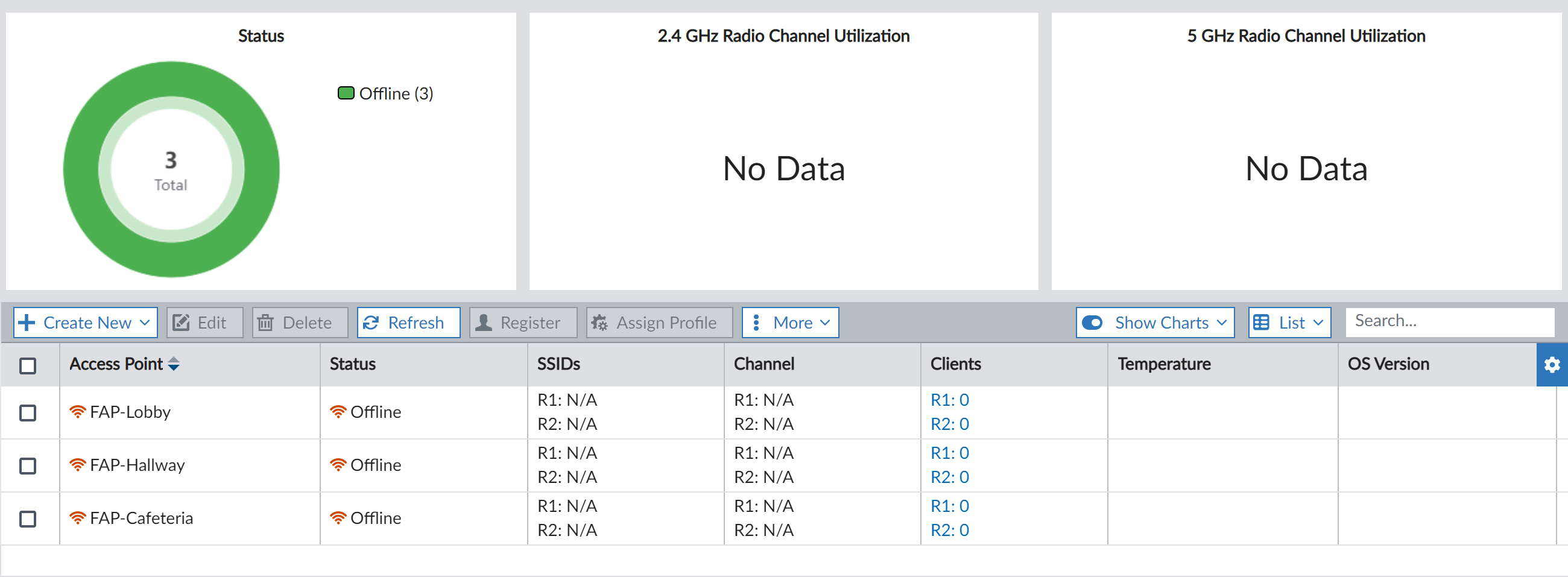

FortiAP devices can be managed from the content pane below the quick status bar. To view the managed FortiGates go to AP Manager > Devices & Groups > Managed FortiGates (#).
The following options are available from the toolbar and right-click menu:
Create New
Add an AP or an AP group.
The APs must be the same model to be grouped. See FortiAP groups.
Edit
Edit the selected AP.
Delete
Delete the selected AP.
Refresh
Refresh the AP list, or refresh the selected FortiAP devices.
Register
Register the selected FortiAP device to your FortiCloud account.
Assign Profile
Assign a profile from the list to the AP. Only applicable profiles will be listed. See Assigning profiles to FortiAP devices.
More
Authorize
Authorize an AP. See Authorizing and deauthorizing FortiAP devices.
This option is also available in the toolbar by selecting More.
Deauthorize
Deauthorize an AP. See Authorizing and deauthorizing FortiAP devices.
Upgrade
Upgrade the AP. The AP must already be authorized.
You can also select two or more AP devices of the same model and upgrade the devices at the same time.
Before upgrading FortiAP, go to FortiGuard > Firmware Images > Product: FortiAP and click the download icon to manually download the firmware images.
Restart
Restart the AP.
Diagnostics and Tools
View the device Summary, Performance, Clients, Interfering SSIDs, and Spectrum Analysis.
View the clients connected to the AP. See Connected clients.
View the spectrum analysis for managed APs. See Spectrum analysis for managed APs.
Export to Excel/CSV
Export the selected device details to an Excel or CSV file.
View Rogue APs
View the Rogue APs. See Rogue APs.
View Health Monitor
View the AP status, clients counts, and wireless interference. See Health Monitor.
Replace
Replace a FortiAP device. Selecting this option allows you to enter a new FortiAP Serial Number for the selected device. See Replacing APs.
LED Blink
Start LED blink on the selected FortiAP for the specified period of time.
This option is only available in the right-click menu.
Show on Google Map
Show the selected AP on Google Map. See Google map.
Show on Floor Map
Show the selected AP on the floor map. See Floor map.
Grouping
Move the selected FortiAP devices into a new group. The APs must be the same model to be grouped. See FortiAP groups.
Search
Enter a search string into the search field to search the AP list.
Column Settings
Click to select which columns to display or select Reset to Default to display the default columns.
The following information is available in the content pane:
FortiGate
The FortiGate unit that is managing the AP.
Access Point
The serial number of the AP.
SSIDs
The SSIDs associated with the AP.
Channel
The wireless radio channels that the access point uses.
Clients
The number of clients connected to the AP.
Select a value to open the View WiFi Clients window to view more details about the clients connected to that radio. See Connected clients.
Temperature
Device temperature information.
OS Version
The OS version on the FortiAP.
AP Profile
The AP Profile assigned to the device, if any.
Connected Via
The IP address of the AP.
Model
Channel Utlization
Comments
User entered comments.
Country/Region
The Country code that the FortiAP is using.
Join Time
The date and time that the FortiAP joined.
LLDP
The Link Layer Discovery Protocol
Operating TX Power
The transmit power of the wireless radios.
Serials #
The serial number of the device
WTP Mode
The Wireless Transaction Protocol (WTP) mode, or 0 if none.

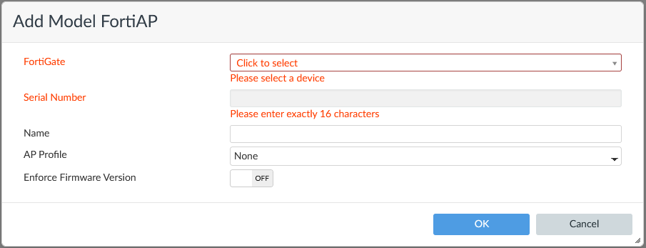

To add a FortiAP:
  1. From theCreate New dropdown, select Managed AP. The Add FortiAP dialog box opens.
  2. Enter the following information, then click OK to add the device:
    FortiGate
    Select the FortiGate that the AP will be added to from the dropdown list. If you have already selected a FortiGate in the tree menu, this field will contain that FortiGate.
    Serials Number
    Enter the device's serial number.
    Name
    Enter a name for the device.
    AP Profile
    Select an AP profile to apply to the device from the dropdown list. See FortiAP profiles.
    Enforce Firmware Version
    Toggle ON to enforce a firmware version and select the firmware version from the drop-down menu. Toggle OFF to disable this feature.
    Adding model devices using a wildcard SN
    FortiAP model devices can be added using wildcard serial numbers. The wildcard SN format is: PREFIX****000001
    • PREFIX: The first 6 digits of the device's serial number. The prefix must be valid.
    • *****: The wildcard characters.
    • 000001: The valid characters.
    For example: PS221E****000001.

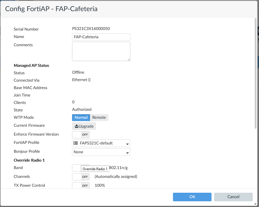

To edit FortiAP devices:
  1. In the tree menu, go to Device & Groups > Managed FortiGate (#), and select the FortiGate that contains the FortiAP device to be edited. Alternatively, you can select a device in a group, see FortiAP groups.
  2. Locate the FortiAP device in the list in the content pane, or refine the list by selecting an option from the quick status bar.
  3. Either select the FortiAP and click Edit from the toolbar, double-click on the FortiAP, or right-click on the FortiAP and select Edit. The Config FortiAP window opens.
  4. Edit the following options, then click Apply to apply your changes:
    Serial Number
    The device’s serial number. This field cannot be edited.
    Name
    The name of the AP.
    Comments
    Comments about the AP, such as its location or function.
    Managed AP Status
    Various information about the AP.
    Status
    The status of the AP, such as Connected, or Idle.
    Click Restart to restart the AP.
    Connected Via
    The method by which the device is connected to the controller.
    Base MAC Address
    The MAC address of the device.
    Join Time
    The time that the AP joined.
    Clients
    The number of clients currently connected to the AP.
    State
    The state of the AP, such as Authorized, or Discovered.
    Current
    The AP's current firmware version. Select Upgrade to upgrade the firmware to a newer version if you have one available.
    FortiAP Profile
    Select a profile from the dropdown list (see FortiAP profiles)
    Bonjour Profile
    Select a profile from the dropdown list (see Bonjour profiles)
    Override Radio
    Override the selected profiles settings.
    Band
    If applicable, select the wireless band, and select the wireless protocol from the dropdown list. The available options depend on the selected platform.
    In two radio devices, both radios cannot use the same band.
    Channels
    Select the channel or channels to include, or let them be automatically assigned. The available channels depend on the selected platform and band.
    TX Power Control
    Enable/disable automatic adjustment of transmit power.
    • Auto: Enter the TX power low and high values, in dBm.
    • Manual: Enter the TX power in the form of the percentage of the total available power.
    SSIDs
    Manually choose the SSIDs that APs using this profile will carry, or let them be selected automatically.
    Override AP Login Password
    Enable/disable overriding the login password:
    • Set: Set the AP login password.
    • Leave Unchanged: Leave the password unchanged.
    • Set Empty: Remove the password.
    Advanced Options
    Configure advanced options. For information, see the FortiOS CLI Reference.
    https://help.fortinet.com/cli/fos60hlp/60/index.htm.

SSIDs
Channel
Clients
Temperature
OS Version
AP Profile
Connected Via
Model
Channel Utlization
Comments
Country/Region
Join Time
LLDP
Operating TX Power
Serials #
WTP Mode
To add a FortiAP:
    FortiGate
    Serials Number
    Name
    AP Profile
    Serial Number
    Name
    The name of the AP.
    Comments
    Managed AP Status
    Status
    Connected Via
    Base MAC Address
    Join Time
    Clients
    State
    Current
    FortiAP Profile
    Bonjour Profile
    Override Radio
    Band
    Channels
    TX Power Control
    SSIDs
    Advanced Options
