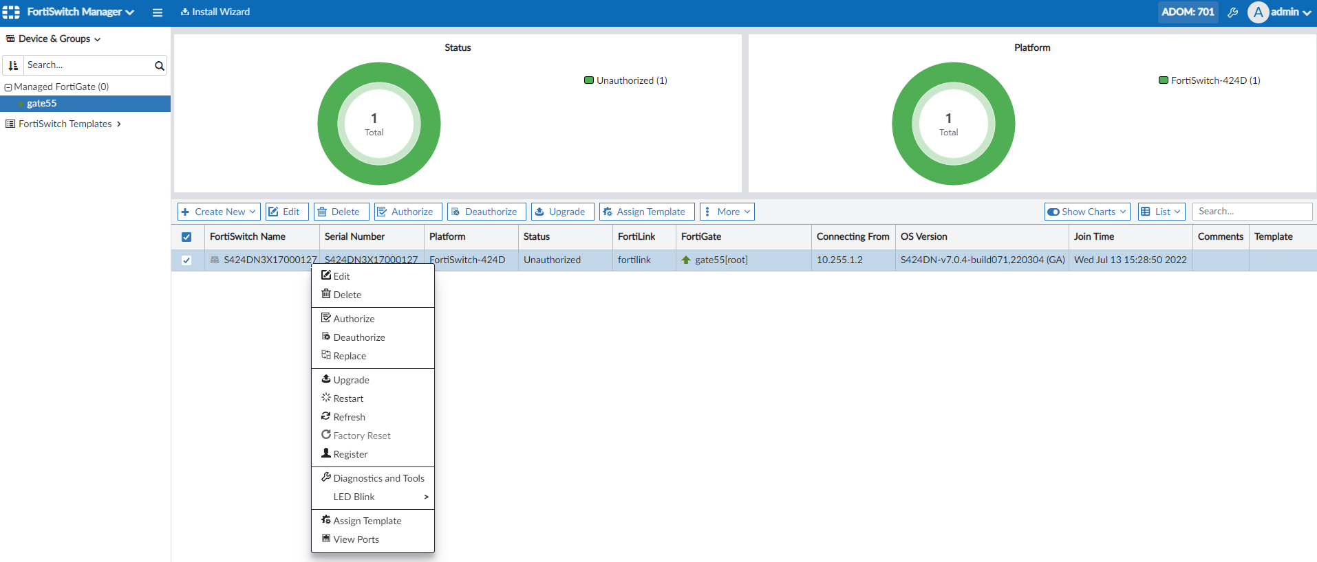

- Go to FortiSwitch Manager > Device & Groups, and select a managed FortiGate.
- Right-click on a FortiSwitch device in the table and click Deauthorize.
- When the device's status is Unauthorized, right-click on the same FortiSwitch device and click Replace.

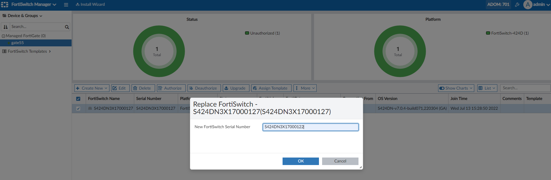

- Enter the new FortiSwitch serial number, and click OK.

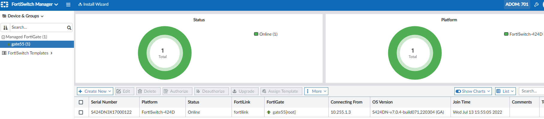

After the FortiSwitch has been replaced successfully, refresh the page and the new FortiSwitch is displayed as Unauthorized. - Authorize the FortiSwitch device, then connect the FortiSwitch to the FortiGate.
- Power on the FortiSwitch device. After a few minutes, the managed switch is displayed as Online.
