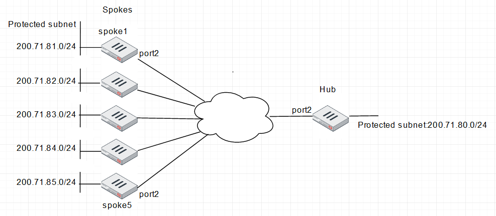

This document provide a sample configuration of hub and spoke (star topology) with VPN Manager and a device group.

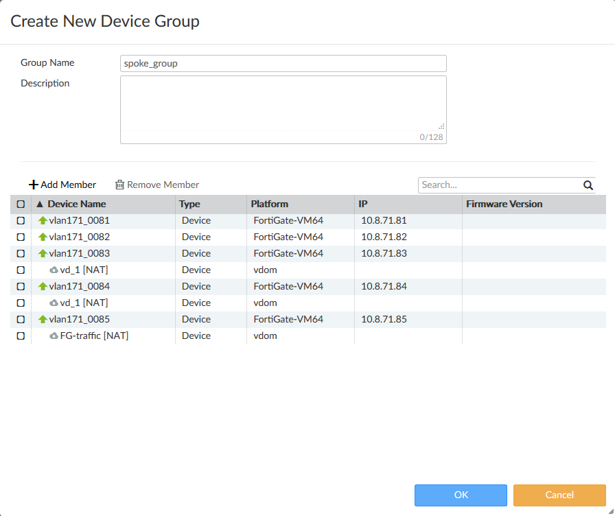

Creating device groups
To create device groups:
- Go to Device Manager > Device & Groups.
- From the Device Group menu, select Create New.
The Create New Device Group dialog box opens.
- In the Group Name box, type a name, such as spoke_group.
- Click Add Member, and add FortiGate units to the group.
In this example, we are adding 5 FortiGate units.
- Click OK to save the group.

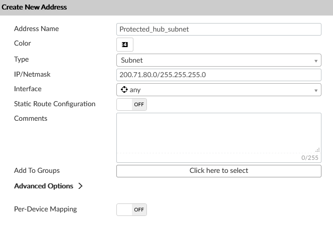

Creating protected subnet firewall addresses
Create protected subnet firewall addresses for hub and spoke devices. VPN Manager can use the protected subnet firewall address to create static routes on FortiGate units to allow traffic destined for the remote protected network to pass through the VPN tunnel.
To create protected subnet firewall addresses:
- Go to Policy & Objects > Object Configurations > Addresses.
- From the Create New menu, select Address.
The Create New Address pane opens.
- Create a protected subnet firewall address for the hub FortiGate, and click OK.

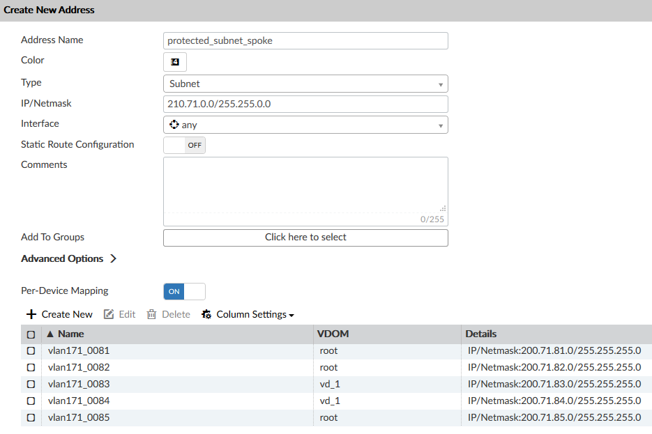

- Create a protected subnet firewall address with per-device mapping for spoke FortiGate units, and click OK.

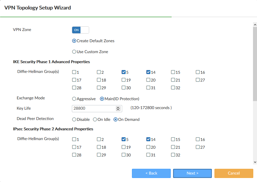

Creating VPN communities
To create a VPN community:

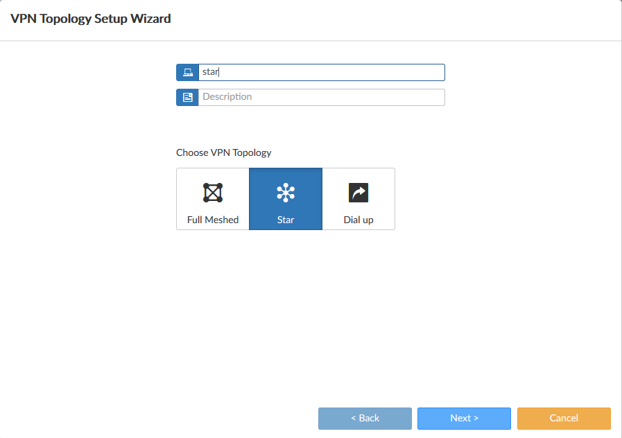

- Go to VPN Manager > IPsec VPN, and click Create New.
The VPN Topology Setup Wizard opens.
- In the Name box, type a name, such as star.
- Under Choose VPN Topology, select Star, and click Next.

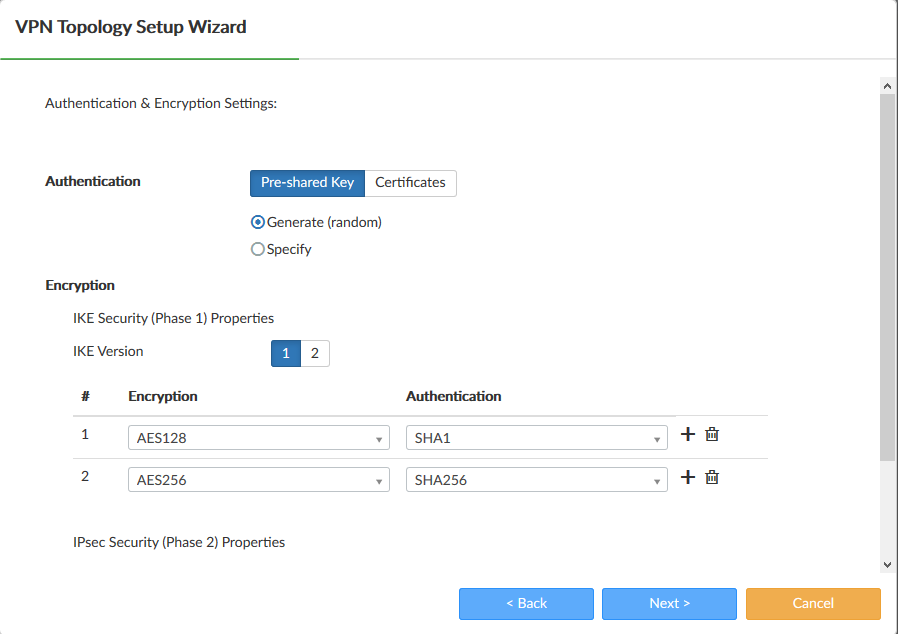

- Specify the Authentication & Encryption Settings, and click Next.
- Configure VPN Phase 1 and Phase 2 settings, and click Next.

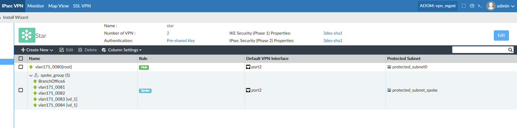

Adding spoke FortiGate units to the VPN community
To add spoke FortiGate units to the VPN community:
- Go to VPN Manager > IPsec VPN, and click the community that you created.
The community opens in the content pane.
- Click Create New > Managed Gateway.
The VPN Gateway Setup Wizard opens for the community.

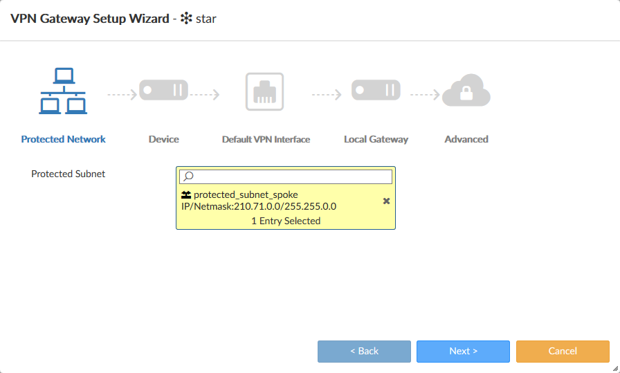

- Set the Protected Network options, and then click Next:
- Beside Protected Subnet, click Click here to select, and select the protected subnet.

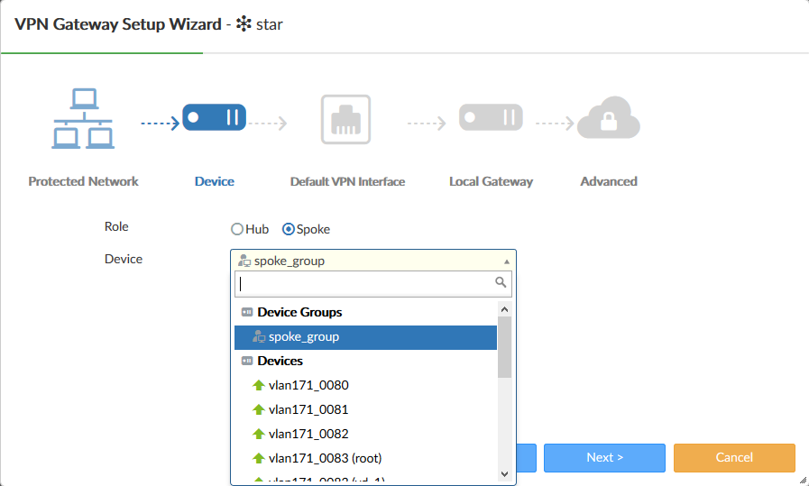

- Set the Device options, and then click Next:
- Beside Role, select Spoke.
- Beside Device, select the device group you created named spoke_group.

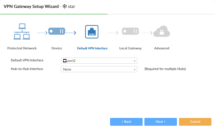

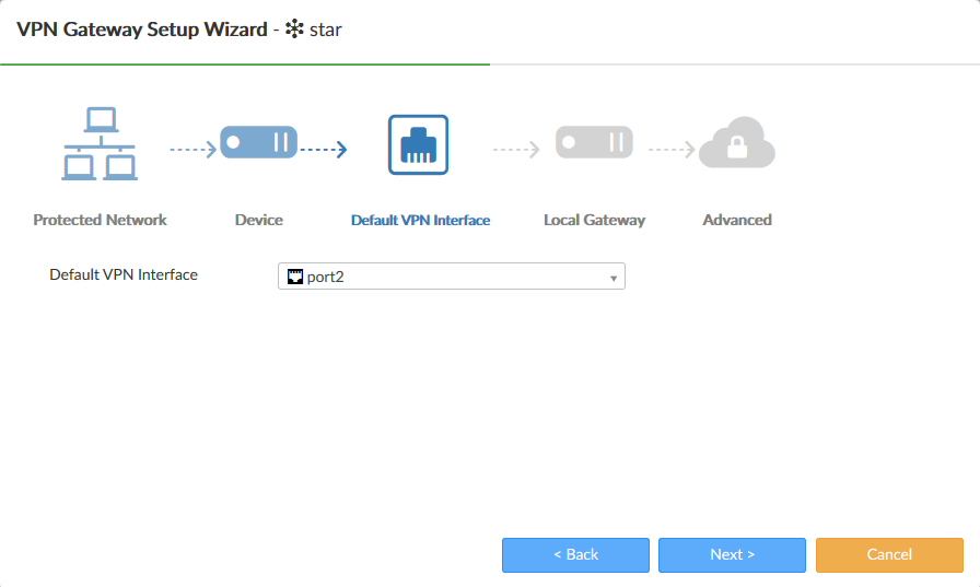

- Set the Default VPN Interface options, and click Next.
- Beside Default VPN Interface, select the interface for spokes, which is often the internet-facing interface.

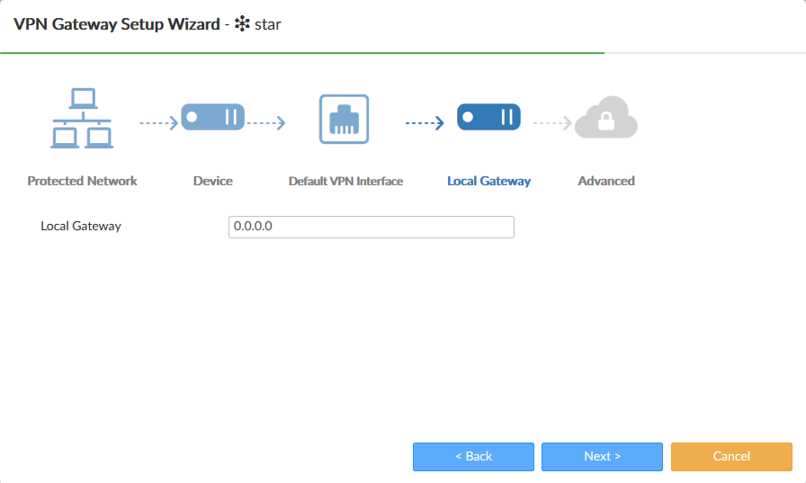

- Set the Local Gateway options, and click Next.
- Beside Local Gateway, type the IP address for the gateway.

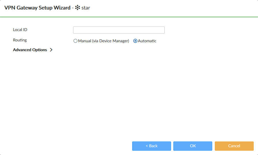

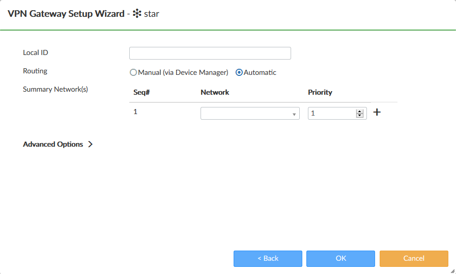

- Set the Advanced options, and click OK.
- Beside Routing, select Manual (via Device Manager) or Automatic.

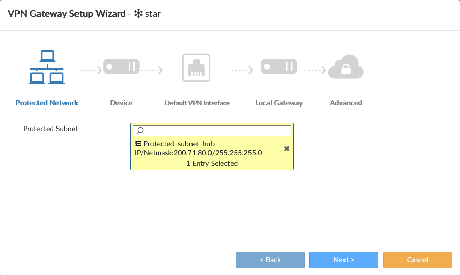

- Beside Default VPN Interface, select the interface for the hub, which is often the internet-facing interface.
The hub and spoke are created.

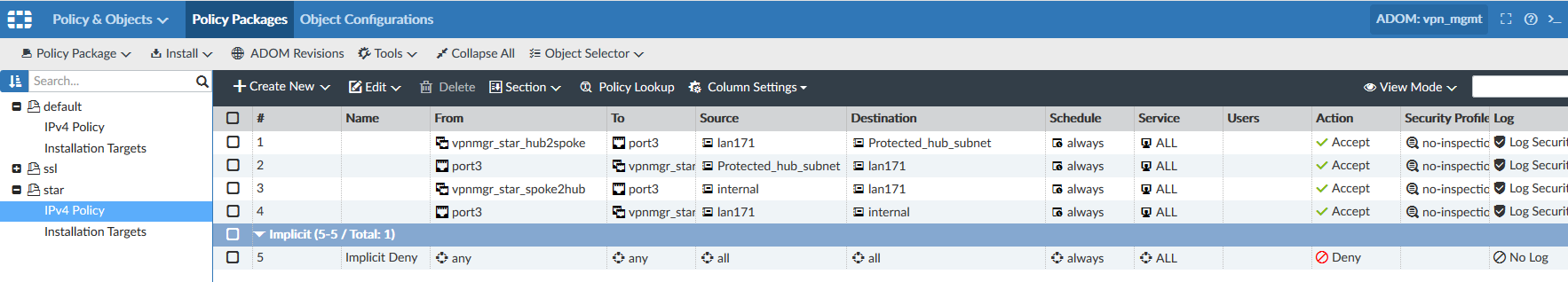

Installing firewall policies to hub and spoke devices
Create firewall policies for hub and spoke FortiGates, and then install the configurations by using the Install Wizard.
To install configurations to hub and spoke devices:
- Go to Policy & Object > Policy Packages.
- Create firewall policies for hub and spoke FortiGates.

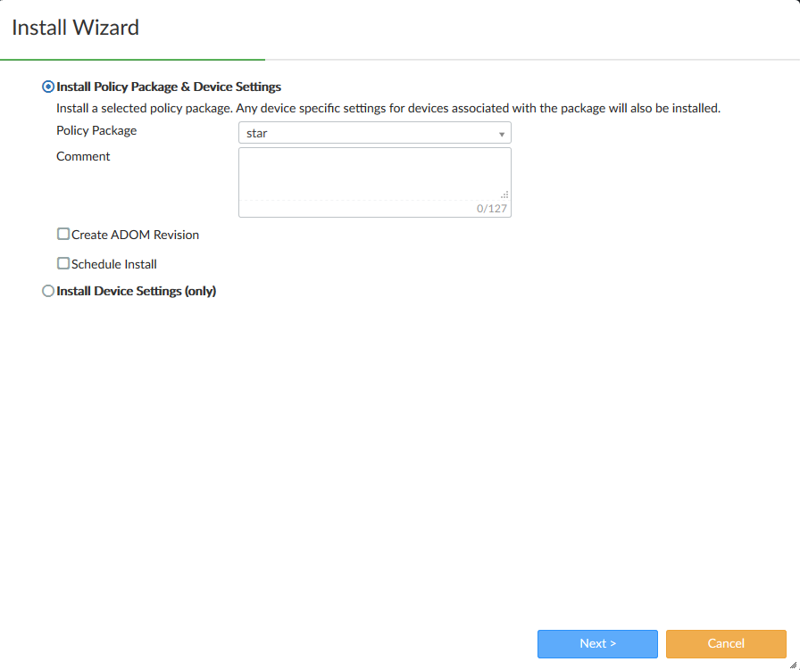

- From the Install menu, select Install Wizard.
- Select Install Policy Package & Device Settings, and then click Next.
- Complete the wizard to install the configurations.

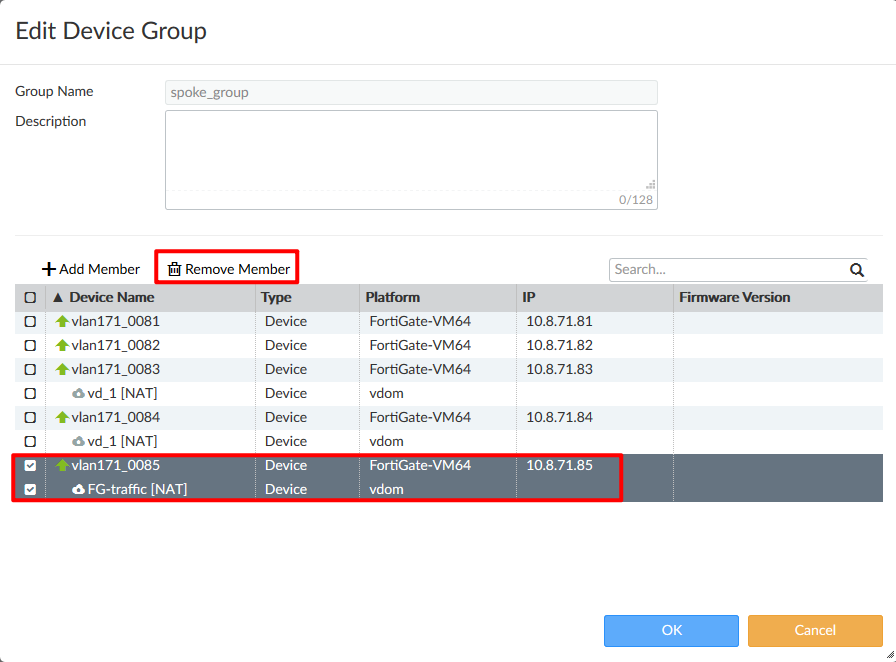

- Remove the device from the device group:
- In the tree menu, right-click the group name, and select Edit Group.
The Edit Device Group dialog box opens.
- Select a device, for example, vlan171_0085, and click Remove Member.
- Click OK to save the changes.

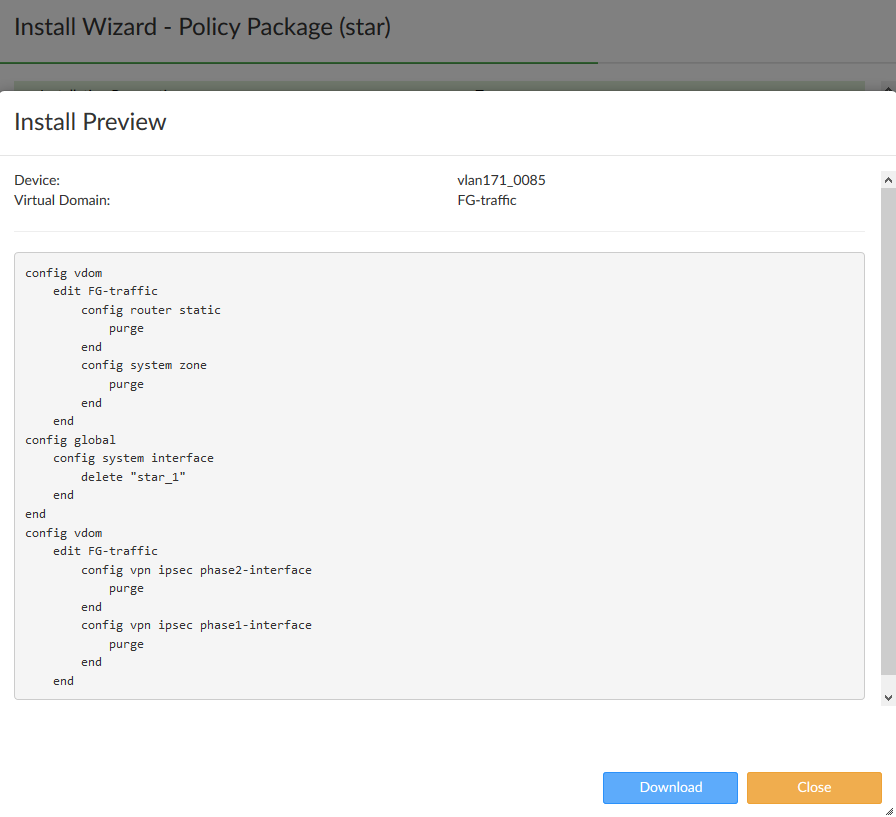

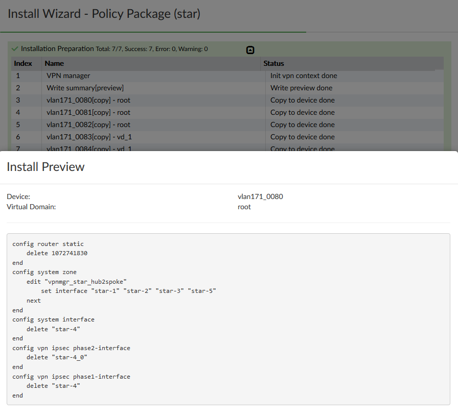

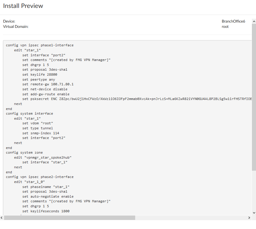

- Execute Policy package installation to purge VPN configuration from FortiGates.
Install preview page shows that FortiManager will purge the related configuration on the hub FortiGate.
The Install Preview page shows that FortiManager will delete related configurations on the spoke FortiGate named vlan181_0085.
Adding a spoke member to a VPN community
You can add a spoke member to a VPN community by adding the device to the device group, and then installing the configuration change to the FortiGates.
To add a new spoke member to a VPN community:
- Add a device to the device group:
- Click Add Member, select the device, for example BranchOffice6, and click Add.

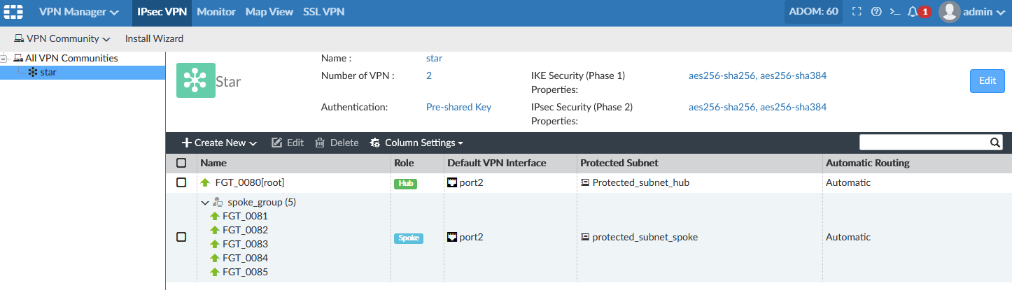

- Go to VPN manager community summary page, the new spoke member is displayed.
In the following example, the member named BranchOffice6 is displayed.
- Execute Policy package installation to push VPN config to HUB and newly added spoke devices.
For example, the Install Preview page shows that FortiManager will install IPsec VPN configuration to the new spoke member. In this example, the new spoke member is named BranchOffice6.
