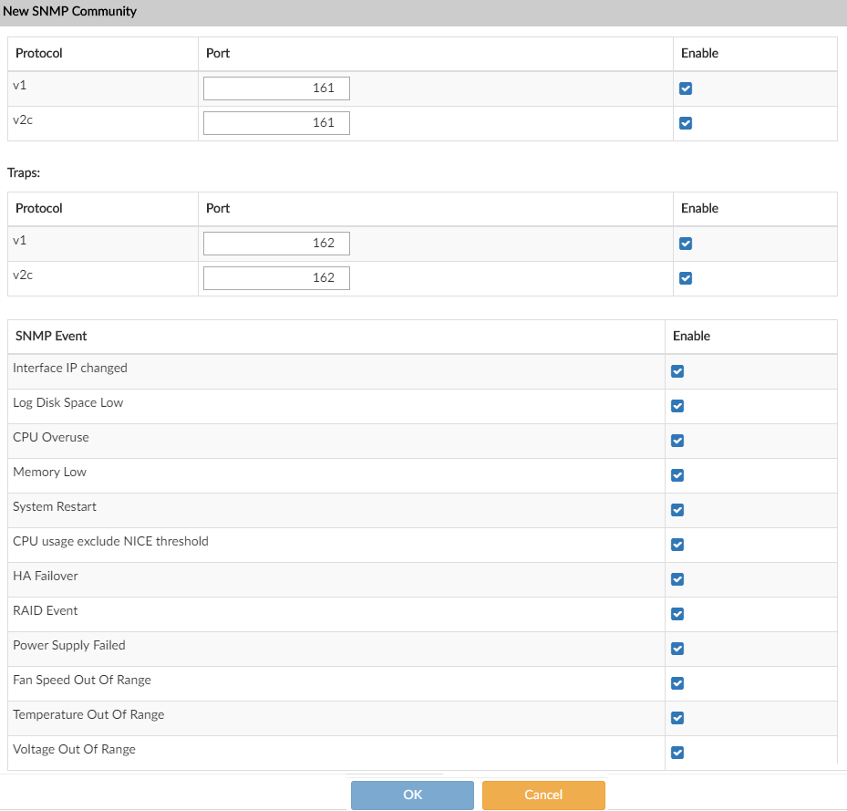

- In the SNMP v1/v2c section, click Create New in the toolbar. The New SNMP Community pane opens.
- Configure the following options, then click OK to create the community.

Queries
Enter the port number (161 by default) the FortiManager system uses to send v1 and v2c queries to the FortiManager in this community. Enable queries for each SNMP version that the FortiManager system uses.
Traps
Enter the Remote port number (162 by default) the FortiManager system uses to send v1 and v2c traps to the FortiManager in this community. Enable traps for each SNMP version that the FortiManager system uses.
SNMP Event
Enable the events that will cause SNMP traps to be sent to the community.
- Interface IP changed
- Log disk space low
- CPU Overuse
- Memory Low
- System Restart
- CPU usage exclude NICE threshold
- HA Failover
- RAID Event (only available for devices that support RAID)
- Power Supply Failed (only available on supported hardware devices)
- Fan Speed Out of Range
Temperature Out of Range
Voltage Out of Range
FortiAnalyzer feature set SNMP events:
- High licensed device quota
- High licensed log GB/day
- Log Alert
- Log Rate
- Data Rate
