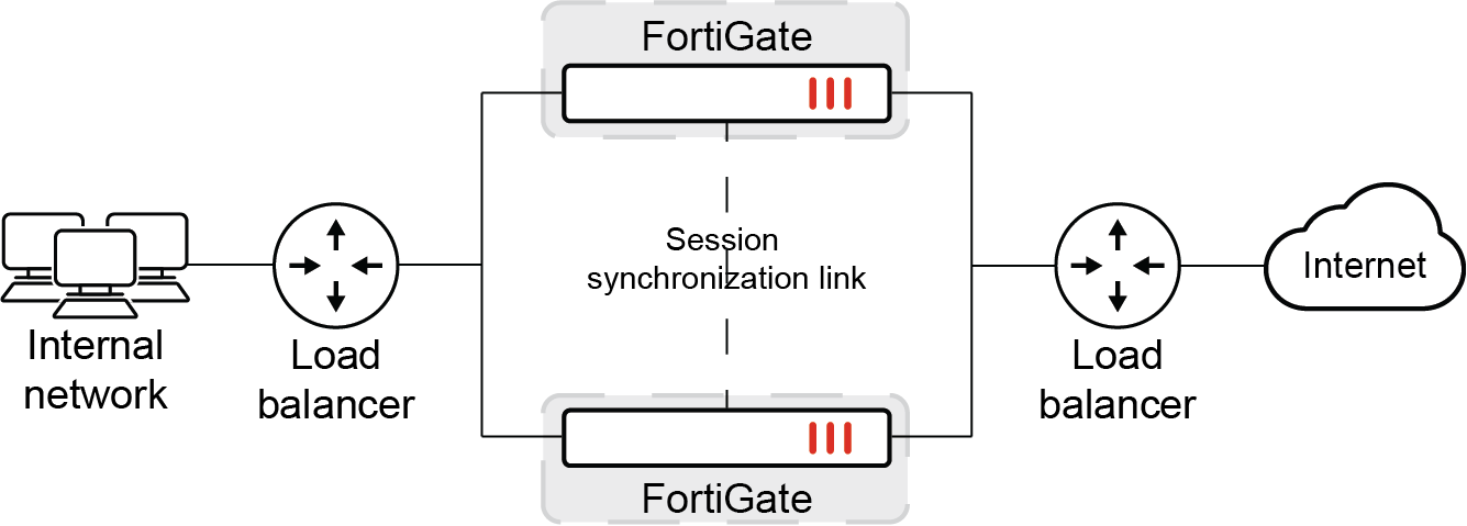

FGSP synchronizes firewall-authenticated users
FGSP synchronizes firewall-authenticated users between FGSP peers. If authenticated users sessions change to a different FGSP peer they do not have to re-authenticate. No special FGSP configuration is required to support this synchronization.
A firewall authenticated user is a user who has been authenticated by a user group that has been added to a firewall policy (see User groups.)
Example configuration
First FGSP peer configuration
This simple example includes setting up a basic FCSP configuration with two FGSP peers. The configuration uses local firewall users as the example authentication configuration.
