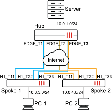

Packet duplication on hub devices can be configured to automatically activate when a spoke begins sending out-of-SLA remote health checks. Duplication continues until the hub once again receives in-SLA health checks from that spoke. The duplication is limited to the affected spoke's tunnels. For each original packet, the hub sends one duplicate per tunnel until either all tunnels have transmitted the same packet or the configured maximum (duplication-max-num) is reached.
In this example, the Hub has three dial-up tunnels to Spoke-1 and Spoke-2. On-demand duplication is configured on the Hub, and active health-check is configured on the spokes to detect the overlays' SLA.

On-demand duplication at the Hub using remote health-check
To configure the Hub:

To check the routes:
  1. On the Hub, check the subnets behind Spoke-1 (10.0.3.0/24) and Spoke-2 (10.0.4.0/24):

  5. Ping from the server to PC-1 and PC-2 and on the Hub, confirm that traffic goes on EDGE_T1 and no duplication occurs because the child tunnels of EDGE_T1 are in-SLA.
    1. PC-1:
      test@server:~$ ping 10.0.3.2
