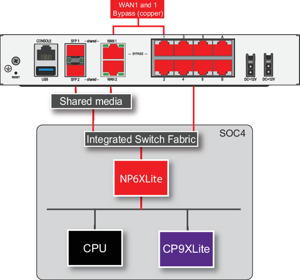

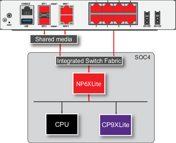

FortiGate 80F, 81F, and 80F Bypass fast path architecture
The FortiGate 80F, 81F, and 80F Bypass includes the SOC4 and uses the SOC4 CPU, NP6XLite processor, and CP9XLite processor. The SOC4 includes an integrated switch fabric (ISF) that connects all of the front panel network interfaces to the NP6XLite processor. All data traffic passes from the data interfaces through the ISF to the NP6XLite processor. All supported traffic passing between any two data interfaces can be offloaded by the NP6XLite processor. Data traffic processed by the CPU takes a dedicated data path through the ISF and the NP6XLite processor to the CPU.
Interfaces SFP1 and WAN1 and SFP2 and WAN2 are shared SFP or Ethernet interfaces. Only one of each of these interface pairs can be connected to a network. This allows you to, for example, connect SFP1 to an SFP switch and WAN2 to 10/100/1000BASE-T Copper switch.
On the FortiGate 80F Bypass model, the WAN1 and 1 interfaces form a copper bypass pair. The SFP1 interface is not part of the bypass pair. On the GUI and CLI the 1 interface is named internal1.
The FortiGate 80F and 81F features the following front panel interfaces:
  • Two 1GigE SFP interfaces (SFP1 and SFP2) connected to the SOC4.
  • Two 10/100/1000BASE-T Copper interfaces (WAN1, WAN2) connected to the SOC4.
  • Eight 10/100/1000BASE-T Copper (1-6, A, and B) connected to the SOC4. A and B are FortiLink interfaces.
