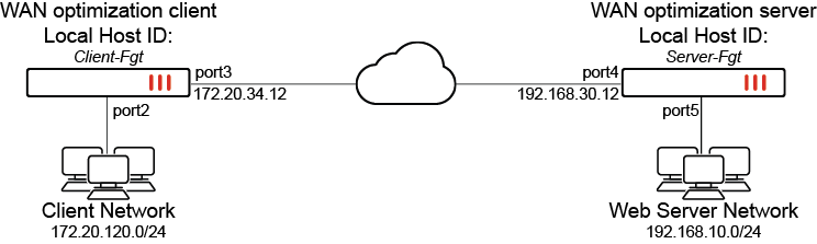

This example configuration includes a client-side FortiGate unit called Client-Fgt with a WAN IP address of 172.20.34.12. This unit is in front of a network with IP address 172.20.120.0. The server-side FortiGate unit is called Server-Fgt with a WAN IP address of 192.168.30.12. This unit is in front of a web server network with IP address 192.168.10.0.
This example customizes the default WAN optimization profile on the client-side FortiGate unit and adds it to the WAN optimization firewall policy. You can also create a new WAN optimization profile.
General configuration steps
This section breaks down the configuration for this example into smaller procedures:
  1. Configure the client-side FortiGate unit:
    • Add peers.
    • Configure the default WAN optimization profile to optimize HTTP traffic.
    • Add a manual WAN optimization firewall policy.
  2. Configure the server-side FortiGate unit:
    • Add peers.
    • Add a WAN optimization proxy policy.
Configuring manual WAN optimization from the GUI
Use the following steps to configure the example configuration from the GUI:
To configure the client-side FortiGate unit:
  1. Go to WAN Opt. & Cache > Peers and change the Host ID of the client-side FortiGate unit:
    1. Click Change. The Host ID pane opens.
    2. Enter a new Host ID:
      Host ID Client-Fgt
    3. Click OK.
  2. Create the server-side FortiGate unit peer:
    1. Select Create New. The New WAN Optimization Peer opens.
    2. Configure the following settings:
      Peer Host ID Server-Fgt
      IP address 192.168.30.12
    3. Click OK.
  3. Go to WAN Opt. & Cache > Profiles and edit the default profile:
    1. Select the default profile and click Edit.
    2. Under Protocol Options, edit HTTP.
    3. Set Status to Enable and click Apply.
    4. Click OK.
  4. Go to Policy & Objects > Firewall Policy to add a manual WAN optimization firewall policy to the client-side FortiGate unit that accepts traffic to be optimized:
    1. Click Create New.
    2. Enter a Name and configure the following settings:
      Incoming Interface port2
      Outgoing Interface port3
      Source all
      Destination all
      Schedule always
      Service ALL
      Action ACCEPT
    3. Set Inspection Mode to Proxy-based.
    4. Enable WAN Optimization and configure the following settings:
      WAN Optimization Manual
      Profiles default
      Peers Server-Fgt
    5. Click OK to save the policy.
