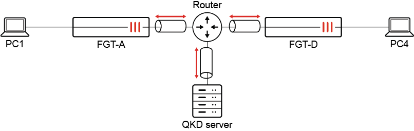

In this example, a quantum key distribution (QKD) system is deployed to perform central IPsec key management. The FortiGates installed as security gateways will terminate large amount of IPsec tunnels.

  1. Configure FGT-A:
    1. Configure the QKD profile:
      config vpn qkd
          edit "qkd_1"
              set server "172.16.200.83"
              set port 8989
              set id "FGT-A"
              set peer "qkd"
              set certificate "FGT_qkd1"
    2. Configure the IPsec phase 1 interface settings:
          edit "site1"
              set interface "wan1"
              set peertype any
              set net-device disable
              set proposal aes128-sha256 aes256-sha256 aes128-sha1 aes256-sha1
              set qkd allow
              set qkd-profile "qkd_1"
              set remote-gw 173.1.1.1
              set psksecret **********
    3. Configure the IPsec phase 2 interface settings:
          edit "site1"
              set phase1name "site1"
              set proposal aes128-sha1 aes256-sha1 aes128-sha256 aes256-sha256 aes128gcm aes256gcm chacha20poly1305
  2. Configure FGT-D:
      config vpn qkd
          edit "qkd_1"
              set port 8989
              set id "FGT-D"
              set peer "qkd"
              set certificate "FGT_qkd3"
          edit "site2"
              set interface "port25"
              set peertype any
              set qkd require
              set remote-gw 11.101.1.1
          edit "site2"
              set phase1name "site2"
To verify the configuration:
  1. Generate traffic between PC1 and PC4.
  2. Run diagnostics on FGT-A:
    1. Verify the IPsec phase 1 interface status:
      # diagnose vpn ike gateway list
      vd: root/0
      version: 1
      interface: wan1 17
      addr: 11.101.1.1:500 -> 173.1.1.1:500
      tun_id: 172.16.200.4/::172.16.200.4
      remote_location: 0.0.0.0
      network-id: 0
      transport: UDP
      created: 3s ago
      peer-id: 173.1.1.1
      peer-id-auth: no
      IKE SA: created 1/1  established 1/1  time 0/0/0 ms
      IPsec SA: created 1/1  established 1/1  time 30/30/30 ms
        id/spi: 21 ad7d995677250c7e/053f958ea7be66c8
        direction: initiator
        status: established 3-3s ago = 0ms
        proposal: aes128-sha256
        key: 5b198e1a431c20fb-c08135cf0c007704
        QKD: yes
        lifetime/rekey: 86400/86096
        DPD sent/recv: 00000000/00000000
        peer-id: 173.1.1.1
    2. Verify the IPsec phase 2 tunnel status:
      # diagnose vpn tunnel list
      list all ipsec tunnel in vd 0
      name=site1 ver=1 serial=2 11.101.1.1:0->173.1.1.1:0 tun_id=172.16.200.4 tun_id6=::172.16.200.4 dst_mtu=1500 dpd-link=on weight=1
      bound_if=17 lgwy=static/1 tun=intf mode=auto/1 encap=none/552 options[0228]=npu frag-rfc  run_state=0 role=primary accept_traffic=1 overlay_id=0
      proxyid_num=1 child_num=0 refcnt=4 ilast=12 olast=11 ad=/0
      stat: rxp=1 txp=2 rxb=84 txb=168
      dpd: mode=on-demand on=1 idle=20000ms retry=3 count=0 seqno=0
      natt: mode=none draft=0 interval=0 remote_port=0
      fec: egress=0 ingress=0
      proxyid=site1 proto=0 sa=1 ref=3 serial=2
        src: 0:0.0.0.0-255.255.255.255:0
        dst: 0:0.0.0.0-255.255.255.255:0
        SA:  ref=6 options=10226 type=00 soft=0 mtu=1438 expire=42883/0B replaywin=2048
             seqno=3 esn=0 replaywin_lastseq=00000002 qat=0 rekey=0 hash_search_len=1
        life: type=01 bytes=0/0 timeout=42897/43200
        dec: spi=b2af532f esp=aes key=16 c1d5d17e6bdecd5b145f672a5054cde1
             ah=sha1 key=20 084f1c0fee48994f59a125606f9c757838dc2421
        enc: spi=3d14392a esp=aes key=16 66277c8cf2bdbd2d12a9d829dde356ad
             ah=sha1 key=20 fdbaa42cca5c3a9bffb1cf0fc74ff29a643a2b9f
        dec:pkts/bytes=1/84, enc:pkts/bytes=2/304
        npu_flag=03 npu_rgwy=173.1.1.1 npu_lgwy=11.101.1.1 npu_selid=4 dec_npuid=2 enc_npuid=2
      The IPsec tunnel is up and traffic passes through.

      transport: UDP
      created: 3s ago
      peer-id: 173.1.1.1
      peer-id-auth: no
        QKD: yes
        peer-id: 173.1.1.1
    3. Verify the IKE debug messages:
      # diagnose debug application ike -1
      ike V=root:0:site1:site1: IPsec SA connect 17 11.101.1.1->173.1.1.1:0
      ike V=root:0:site1:site1: using existing connection
      ike V=root:0:site1:site1: config found
      ike V=root:0:site1:site1: IPsec SA connect 17 11.101.1.1->173.1.1.1:500 negotiating
      ike 0:site1:20:site1:22: QKD initiator request
      ike 0:site1:20:site1:22: QKD initiator key-id '4e0592fe-9568-11ee-97b8-5fb93000b0c2'
      ike V=root:0:site1:20:site1:22: add IPsec SA: SPIs=b2af532d/3d143928
      ike 0:site1:20:site1:22: IPsec SA dec spi b2af532d key 16:958EE561ABD2B6F0F4C6E042202F451E auth 20:4D694E6951ADB425A2A1C3261140957C9469A4DC
      ike 0:site1:20:site1:22: IPsec SA enc spi 3d143928 key 16:6016E26398B70E55A17EF73611B30028 auth 20:357880E885F3ED23092233737B9FD0573DCB0D08
      ike V=root:0:site1:20:site1:22: added IPsec SA: SPIs=b2af532d/3d143928
      ike V=root:0:site1:20:site1:22: sending SNMP tunnel UP trap
    4. Verify the statistics for qkd_1:
      # diagnose vpn ike qkd qkd_1
      client.count.fd: now 0  max 1  total 3
      client.count.fp: now 0  max 1  total 3
      client.count.mmap: now 2  max 2  total 9
      client.event: 4
      client.retry: 0
      client.cmd.request.initiator: 4
      client.cmd.request.responder: 0
      client.cmd.reply.initiator: 4
      client.cmd.reply.responder: 0
      server.boot.count: 3
      server.boot.last.time: 4295388395
      server.boot.last.ago: 247
      server.stop.budget: 0
      server.stop.error: 0
      server.stop.auth.count: 0
      server.cmd.reading: 7
      server.cmd.read: 4
      server.cmd.request.initiator: 4
      server.cmd.request.responder: 0
      server.cmd.reply.initiator: 4
      server.cmd.reply.responder: 0
      server.auth.request.sending.count: 4
      server.auth.request.sending.last.time: 4295389413
      server.auth.request.sending.last.ago: 237
      server.auth.request.sent.count: 4
      server.auth.request.sent.last.time: 4295389413
      server.auth.request.sent.last.ago: 237
      server.auth.reply.reading.count: 4
      server.auth.reply.reading.last.time: 4295389413
      server.auth.reply.reading.last.ago: 237
      server.auth.reply.read.count: 4
      server.auth.reply.read.last.time: 4295389413
      server.auth.reply.read.last.ago: 237
      server.dns.addrs:
      server.curl.get.count: 4
      server.curl.get.last.time: 4295389413
      server.curl.get.last.ago: 237
      server.curl.json.parse: 4
      server.curl.json.parsed: 4
