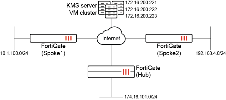

In this example, there is a topology with an ADVPN hub FortiGate and two spoke FortiGates. There is a cluster or three KMS server VMs (172.16.200.221, 172.16.200.222, and 172.16.200.223) that operates in round-robin mode. The testuser1_Cert certificate is issued by the KMS server, and the testuser1 user is defined on the KMS server. Authentication to the KMS server by the KMIP client requires both a certificate and a password.
The Hub FortiGate acting as the responder will try to locate keys on the KMS server first. If they do not exist, the FortiGate requests to create new keys on KMS server. The responder sends the keys’ names to the Spoke1 and Spoke2 FortiGates acting as the initiators using IKE messages, and these initiators locate and retrieve keys from KMS server using the keys’ names. The keylifeseconds parameter in phase 2 defines how often the FortiGate will try to synchronize local keys to those on the KMS server.
The keys are retrieved from the KMS server and used as IPsec SA keys in IPsec tunnels. The key format used is: [IDi/r]-[IDr/i]-[phase2name]-ENC/AUTH-[keyalg]-[keylen].
First, this example focuses on the Hub FortiGate and the IPsec VPN connection between the Spoke1 and Hub FortiGate. Second, this example focuses on the spoke-to-spoke tunnel, also known as a shortcut tunnel or shortcut, which is established when traffic flows between the Spoke1 and Spoke2 FortiGates.

    stat: rxp=21 txp=39 rxb=2644 txb=2389
    dpd: mode=on-idle on=1 idle=60000ms retry=3 count=0 seqno=1
    natt: mode=none draft=0 interval=0 remote_port=0
    fec: egress=0 ingress=0
    proxyid=hub proto=0 sa=1 ref=3 serial=1 ads
      src: 0:0.0.0.0-255.255.255.255:0
      dst: 0:0.0.0.0-255.255.255.255:0
      SA:  ref=6 options=826 type=00 soft=0 mtu=1438 expire=6673/0B replaywin=2048
           seqno=15 esn=0 replaywin_lastseq=00000002 qat=0 rekey=0 hash_search_len=1
      life: type=01 bytes=0/0 timeout=7191/7200
      dec: spi=628d1814 esp=aes key=16 5dad0d8d3568eab7c3f259349dc64039
           ah=sha1 key=20 e660f491b80b2cfdcdb0d737942bea2e853dac8d
      enc: spi=471dfe2e esp=aes key=16 1de4b8e8accaa792e0934fbd9f933a6a
           ah=sha1 key=20 1fa244d3971b4d4df59b8d7b3655a1b77f8e65af
      dec:pkts/bytes=22/2696, enc:pkts/bytes=59/4949
      npu_flag=03 npu_rgwy=172.16.200.1 npu_lgwy=172.16.200.4 npu_selid=e dec_npuid=1 enc_npuid=0
    name=hub_1 ver=2 serial=f 172.16.200.4:0->172.16.200.3:0 tun_id=10.10.10.3 tun_id6=::10.0.0.15 dst_mtu=1500 dpd-link=on weight=1
    bound_if=10 lgwy=static/1 tun=intf mode=dial_inst/3 encap=none/74408 options[122a8]=npu rgwy-chg frag-rfc  run_state=0 role=primary accept_traffic=1 overlay_id=0
    parent=hub index=1
    proxyid_num=1 child_num=0 refcnt=5 ilast=2 olast=2 ad=s/1
    stat: rxp=21 txp=43 rxb=2615 txb=2718
      SA:  ref=6 options=826 type=00 soft=0 mtu=1438 expire=6665/0B replaywin=2048
           seqno=17 esn=0 replaywin_lastseq=00000002 qat=0 rekey=0 hash_search_len=1
      life: type=01 bytes=0/0 timeout=7187/7200
      dec: spi=628d1813 esp=aes key=16 5fcca9194ced21b0a586a8fd7a27cbf7
           ah=sha1 key=20 6d6d9dc77d5af89f062927c4d4695d404df1ffe3
      enc: spi=8d568113 esp=aes key=16 2006f323b760238048fcd6f7783b0a04
           ah=sha1 key=20 bd6db68ee035088f35174b2b5c58a51fbbe3f5b5
      dec:pkts/bytes=22/2686, enc:pkts/bytes=65/5566
      npu_flag=03 npu_rgwy=172.16.200.3 npu_lgwy=172.16.200.4 npu_selid=d dec_npuid=1 enc_npuid=0
  2. Verify the KMS keys for the VPN tunnel between the Hub and Spoke1:
    Hub # get vpn ike  kms-keys
    vd: root/0
    addr: 172.16.200.4:500 -> 172.16.200.3:500
      phase2
      server: "KMS_server"
      spi: 628d1813
        enc
          keyname: "Spoke2-hub-hub-ENC-AES-16"
          key: 5fcca9194ced21b0a586a8fd7a27cbf7
        auth
          keyname: "Spoke2-hub-hub-AUTH-SHA1-20"
          key: 6d6d9dc77d5af89f062927c4d4695d404df1ffe3
      spi: 8d568113
        enc
          keyname: "hub-Spoke2-hub-ENC-AES-16"
          key: 2006f323b760238048fcd6f7783b0a04
        auth
          keyname: "hub-Spoke2-hub-AUTH-SHA1-20"
          key: bd6db68ee035088f35174b2b5c58a51fbbe3f5b5
    vd: root/0
    addr: 172.16.200.4:500 -> 172.16.200.1:500
      phase2
      spi: 628d1814
        enc
          keyname: "Spoke1-hub-hub-ENC-AES-16"
          key: 5dad0d8d3568eab7c3f259349dc64039
        auth
          keyname: "Spoke1-hub-hub-AUTH-SHA1-20"
          key: e660f491b80b2cfdcdb0d737942bea2e853dac8d
      spi: 471dfe2e
        enc
          keyname: "hub-Spoke1-hub-ENC-AES-16"
          key: 1de4b8e8accaa792e0934fbd9f933a6a
        auth
          keyname: "hub-Spoke1-hub-AUTH-SHA1-20"
          key: 1fa244d3971b4d4df59b8d7b3655a1b77f8e65af
  3. Verify the IKE and KMIP debug messages on both FortiGates:
    # diagnose debug application ike -1
    # diagnose debug application kmipd -1
    1. For the responder FortiGate, Hub:
      ike 0: comes 172.16.200.1:500->172.16.200.4:500,ifindex=10,vrf=0....
      ike 0: IKEv2 exchange=AUTH id=6e99ee7fd238b462/82e575f08b93f44c:00000001 len=708
      ike 0:hub:537: encrypted fragment 3 of 3 queued
      ike 0:hub:537: reassembled fragmented message
      ike 0:hub:537: responder received AUTH msg
      ike 0:hub:537: processing notify type INITIAL_CONTACT
      ike 0:hub:537: processing notify type INTERFACE_ADDR4
      ike 0:hub:537: INTERFACE-ADDR4 10.10.10.2
      ike 0:hub:537: processing notify type MESSAGE_ID_SYNC_SUPPORTED
      ike 0:hub:537: processing notify type KMS_SUPPORT
      ike 0:hub:hub: sending kmip locate request: id=4321 keyname=Spoke1-hub-hub-ENC-AES-16
      ike 0:hub:hub: sending kmip locate request: id=4322 keyname=hub-Spoke1-hub-ENC-AES-16
      ike 0:hub:hub: sending kmip locate request: id=4323 keyname=Spoke1-hub-hub-AUTH-SHA1-20
      ike 0:hub:hub: sending kmip locate request: id=4324 keyname=hub-Spoke1-hub-AUTH-SHA1-20
      ike 0:hub:hub: sending kmip create request: id=4328 keyname=hub-Spoke1-hub-AUTH-SHA1-20 keyalg=7 keylen=160
      kmip_tsk_resp_finalizer()-365: server-KMS_server, vfid-0, cur_total-4, batch_count-4
      kmip_free_tsk()-144: Freeing tsk pid=6487, job_id=4321, seq=4321
      kmip_free_tsk()-144: Freeing tsk pid=6487, job_id=4322, seq=4322
      kmip_free_tsk()-144: Freeing tsk pid=6487, job_id=4323, seq=4323
      kmip_free_tsk()-144: Freeing tsk pid=6487, job_id=4324, seq=4324
      kmipd_op_create_req_check()-35: New tsk for 'KMS_server', op-create, vfid-0, pid-6487, job_id-4325, name-'Spoke1-hub-hub-ENC-AES-16'
      kmip_new_tsk()-131: New tsk pid=6487, job_id=4325, seq=4325
      kmipd_op_create_req_check()-35: New tsk for 'KMS_server', op-create, vfid-0, pid-6487, job_id-4326, name-'hub-Spoke1-hub-ENC-AES-16'
      kmip_new_tsk()-131: New tsk pid=6487, job_id=4326, seq=4326
      kmipd_op_create_req_check()-35: New tsk for 'KMS_server', op-create, vfid-0, pid-6487, job_id-4327, name-'Spoke1-hub-hub-AUTH-SHA1-20'
      kmip_new_tsk()-131: New tsk pid=6487, job_id=4327, seq=4327
      kmipd_op_create_req_check()-35: New tsk for 'KMS_server', op-create, vfid-0, pid-6487, job_id-4328, name-'hub-Spoke1-hub-AUTH-SHA1-20'
      kmip_new_tsk()-131: New tsk pid=6487, job_id=4328, seq=4328
      kmip_send_reply()-32: Sending 28 data. Job_id-4332 ret-0
      ike KMIP response received: id=4332 ret=0
      ike 0:hub:hub processing kmip get-response
      ike 0:hub:hub recevied KMS keys 4/4
      ike 0:hub: adding new dynamic tunnel for 172.16.200.1:500
      ike 0:hub_0: tunnel created tun_id 10.10.10.2/::10.0.0.12 remote_location 0.0.0.0
      ike 0:hub_0: added new dynamic tunnel for 172.16.200.1:500
      ike 0:hub_0:539: established IKE SA 709d9a9eab5b5a48/01afbbcfa47c1459
      ike 0:hub_0:539: auto-discovery sender
      ike 0:hub_0:539: auto-discovery 1
      ike 0:hub_0:539: check peer route: if_addr4_rcvd=1, if_addr6_rcvd=0, mode_cfg=0
      ike 0:hub_0:539: update peer route 0.0.0.0 -> 10.10.10.2
      ike 0:hub_0:539: processing INITIAL-CONTACT
      ike 0:hub_0: flushing
      ike 0:hub_0: flushed
      ike 0:hub_0:539: processed INITIAL-CONTACT
      ike 0:hub_0:539: local cert, subject='hub', issuer='support'
      ike 0:hub_0:539: local CA cert, subject='support', issuer='support'
      ike 0:hub_0:539: add INTERFACE-ADDR4 10.10.10.1
      ike 0:hub_0:hub: added KMS_KEY payloads
      ike 0:hub_0:539:hub:1085: replay protection enabled
      ike 0:hub_0:539:hub:1085: set sa life soft seconds=7190.
      ike 0:hub_0:539:hub:1085: set sa life hard seconds=7200.
      ike 0:hub_0:539:hub:1085: IPsec SA selectors #src=1 #dst=1
      ike 0:hub_0:539:hub:1085: src 0 7 0:0.0.0.0-255.255.255.255:0
      ike 0:hub_0:539:hub:1085: dst 0 7 0:0.0.0.0-255.255.255.255:0
      ike 0:hub_0:539:hub:1085: add dynamic IPsec SA selectors
      ike 0:hub_0:539:hub:1085: added dynamic IPsec SA proxyids, new serial 1
      ike 0:hub_0:539:hub:1085: tunnel 2 of VDOM limit 0/0
      ike 0:hub_0:539:hub:1085: add IPsec SA: SPIs=628d180e/471dfe29
      ike 0:hub_0:539:hub:1085: IPsec SA dec spi 628d180e key 16:5DAD0D8D3568EAB7C3F259349DC64039 auth 20:E660F491B80B2CFDCDB0D737942BEA2E853DAC8D
      ike 0:hub_0:539:hub:1085: IPsec SA enc spi 471dfe29 key 16:1DE4B8E8ACCAA792E0934FBD9F933A6A auth 20:1FA244D3971B4D4DF59B8D7B3655A1B77F8E65AF
      ike 0:hub_0:539:hub:1085: added IPsec SA: SPIs=628d180e/471dfe29
      ike 0:hub_0: tunnel up event
      ike 0:hub_0:539:hub:1085: sending SNMP tunnel UP trap
    2. For the initiator FortiGate, Spoke1:
      ike 0:spoke1: schedule auto-negotiate
      ike 0:spoke1:spoke1: initiator received KMS_KEY: "Spoke1-hub-hub-ENC-AES-16" "hub-Spoke1-hub-ENC-AES-16" "Spoke1-hub-hub-AUTH-SHA1-20" "hub-Spoke1-hub-AUTH-SHA1-20"
      ike 0:spoke1:spoke1: sending kmip locate request: id=77 keyname=Spoke1-hub-hub-ENC-AES-16
      ike 0:spoke1:spoke1: sending kmip locate request: id=78 keyname=hub-Spoke1-hub-ENC-AES-16
      ike 0:spoke1:spoke1: sending kmip locate request: id=79 keyname=Spoke1-hub-hub-AUTH-SHA1-20
      ike 0:spoke1:spoke1: sending kmip locate request: id=80 keyname=hub-Spoke1-hub-AUTH-SHA1-20
      kmipd_op_locate_req_check()-48: New tsk for 'KMS_server', op-locate, vfid-0, pid-3341, job_id-78, name-'hub-Spoke1-hub-ENC-AES-16'
      kmip_new_tsk()-131: New tsk pid=3341, job_id=78, seq=78
      kmipd_op_locate_req_check()-48: New tsk for 'KMS_server', op-locate, vfid-0, pid-3341, job_id-79, name-'Spoke1-hub-hub-AUTH-SHA1-20'
      kmip_new_tsk()-131: New tsk pid=3341, job_id=79, seq=79
      kmipd_op_locate_req_check()-48: New tsk for 'KMS_server', op-locate, vfid-0, pid-3341, job_id-80, name-'hub-Spoke1-hub-AUTH-SHA1-20'
      kmip_new_tsk()-131: New tsk pid=3341, job_id=80, seq=80
      kmipd_op_locate_req_check()-48: New tsk for 'KMS_server', op-locate, vfid-0, pid-3341, job_id-77, name-'Spoke1-hub-hub-ENC-AES-16'
      kmip_new_tsk()-131: New tsk pid=3341, job_id=77, seq=77
      kmipd_op_get_req_check()-35: New tsk for 'KMS_server', op-get, vfid-0, pid-3341, job_id-81, keyid-'a98f50b20bfe4037a7c47283eef578e61b474bf3829f45beb4a6c972c31a5d63'
      kmip_new_tsk()-131: New tsk pid=3341, job_id=81, seq=81
      kmipd_op_get_req_check()-35: New tsk for 'KMS_server', op-get, vfid-0, pid-3341, job_id-82, keyid-'b4867ef7052b484faea2e7916b585bfc171e0981b843444097ee39d67fba30ea'
      kmip_new_tsk()-131: New tsk pid=3341, job_id=82, seq=82
      kmipd_op_get_req_check()-35: New tsk for 'KMS_server', op-get, vfid-0, pid-3341, job_id-83, keyid-'41d4e37c4a014811a78cd1e1053d6370edc62a5a975e46c8a8aeda3bf4d76061'
      kmip_new_tsk()-131: New tsk pid=3341, job_id=83, seq=83
      kmipd_op_get_req_check()-35: New tsk for 'KMS_server', op-get, vfid-0, pid-3341, job_id-84, keyid-'2ba130bff7174ba7a237d7ea53611121383b132cf18a4fd183890ca196296cb4'
      kmip_new_tsk()-131: New tsk pid=3341, job_id=84, seq=84
      ike 0:spoke1:spoke1 processing kmip get-response
      ike 0:spoke1:spoke1 recevied KMS keys 4/4
      ike 0:spoke1:536:spoke1:549: replay protection enabled
      ike 0:spoke1:536:spoke1:549: set sa life soft seconds=6901.
      ike 0:spoke1:536:spoke1:549: set sa life hard seconds=7200.
      ike 0:spoke1:536:spoke1:549: IPsec SA selectors #src=1 #dst=1
      ike 0:spoke1:536:spoke1:549: src 0 7 0:0.0.0.0-255.255.255.255:0
      ike 0:spoke1:536:spoke1:549: dst 0 7 0:0.0.0.0-255.255.255.255:0
      ike 0:spoke1:536:spoke1:549: add IPsec SA: SPIs=471dfe29/628d180e
      ike 0:spoke1:536:spoke1:549: IPsec SA dec spi 471dfe29 key 16:1DE4B8E8ACCAA792E0934FBD9F933A6A auth 20:1FA244D3971B4D4DF59B8D7B3655A1B77F8E65AF
      ike 0:spoke1:536:spoke1:549: IPsec SA enc spi 628d180e key 16:5DAD0D8D3568EAB7C3F259349DC64039 auth 20:E660F491B80B2CFDCDB0D737942BEA2E853DAC8D
      ike 0:spoke1:536:spoke1:549: added IPsec SA: SPIs=471dfe29/628d180e
      ike 0:spoke1:536:spoke1:549: sending SNMP tunnel UP trap
To verify the IPsec configuration and tunnel between the Spoke1 and Spoke2 FortiGates:
  1. Verify the tunnel state on Spoke1:
    Spoke1 # diagnose vpn tunnel list
    list all ipsec tunnel in vd 0
    name=spoke1 ver=2 serial=1 172.16.200.1:0->172.16.200.4:0 tun_id=172.16.200.4 tun_id6=::172.16.200.4 dst_mtu=1500 dpd-link=on weight=1
    bound_if=19 lgwy=static/1 tun=intf mode=auto/1 encap=none/552 options[0228]=npu frag-rfc  run_state=0 role=primary accept_traffic=1 overlay_id=0 proxyid_num=1 child_num=1 refcnt=5 ilast=35 olast=35 ad=r/2
    stat: rxp=1 txp=11 rxb=71 txb=699
    dpd: mode=on-demand on=1 idle=20000ms retry=3 count=0 seqno=5
    proxyid=spoke1 proto=0 sa=1 ref=3 serial=2 adr
      SA:  ref=6 options=12026 type=00 soft=0 mtu=1438 expire=6621/0B replaywin=2048
           seqno=c esn=0 replaywin_lastseq=00000002 qat=0 rekey=0 hash_search_len=1
      life: type=01 bytes=0/0 timeout=6903/7200
      dec: spi=471dfe2e esp=aes key=16 1de4b8e8accaa792e0934fbd9f933a6a
      enc: spi=628d1814 esp=aes key=16 5dad0d8d3568eab7c3f259349dc64039
      dec:pkts/bytes=2/142, enc:pkts/bytes=22/2131
      npu_flag=03 npu_rgwy=172.16.200.4 npu_lgwy=172.16.200.1 npu_selid=1 dec_npuid=2 enc_npuid=2
    run_tally=0
    name=spoke1_0 ver=2 serial=4 172.16.200.1:0->172.16.200.3:0 tun_id=172.16.200.3 tun_id6=::172.16.200.3 dst_mtu=1500 dpd-link=on weight=1
    bound_if=19 lgwy=static/1 tun=intf mode=dial_inst/3 encap=none/66216 options[102a8]=npu rgwy-chg frag-rfc  run_state=0 role=primary accept_traffic=1 overlay_id=0 parent=spoke1 index=0
    proxyid_num=1 child_num=0 refcnt=5 ilast=10 olast=10 ad=r/2
    stat: rxp=1 txp=5 rxb=84 txb=420
    dpd: mode=on-demand on=1 idle=20000ms retry=3 count=0 seqno=1
    proxyid=spoke1 proto=0 sa=1 ref=3 serial=1 adr
      SA:  ref=6 options=12026 type=00 soft=0 mtu=1438 expire=6947/0B replaywin=2048
           seqno=6 esn=0 replaywin_lastseq=00000402 qat=0 rekey=0 hash_search_len=1
      life: type=01 bytes=0/0 timeout=7190/7200
      dec: spi=471dfe2f esp=aes key=16 a6d6a25cd986860bcc502d58f32e99de
           ah=sha1 key=20 07d712156eaca28439fbe944e3a8c9af4c45166a
      enc: spi=8d568114 esp=aes key=16 b01c534b11792b856c1b95c78c4cad91
           ah=sha1 key=20 fe6a82177db6911b3203d1306969e5ddec8fd039
      dec:pkts/bytes=2/168, enc:pkts/bytes=10/1180
      npu_flag=03 npu_rgwy=172.16.200.3 npu_lgwy=172.16.200.1 npu_selid=4 dec_npuid=2 enc_npuid=2
  2. Verify the KMS keys for the VPN tunnel between Spoke1 and Spoke2:
    Spoke1 # get vpn ike kms-keys
    vd: root/0
    addr: 172.16.200.1:500 -> 172.16.200.4:500
      phase2
      spi: 628d1814
        enc
        auth
      spi: 471dfe2e
        enc
        auth
    vd: root/0
    addr: 172.16.200.1:500 -> 172.16.200.3:500
      phase2
      spi: 8d568114
        enc
          keyname: "Spoke1-Spoke2-spoke2-ENC-AES-16"
          key: b01c534b11792b856c1b95c78c4cad91
        auth
          keyname: "Spoke1-Spoke2-spoke2-AUTH-SHA1-20"
          key: fe6a82177db6911b3203d1306969e5ddec8fd039
      spi: 471dfe2f
        enc
          keyname: "Spoke2-Spoke1-spoke2-ENC-AES-16"
          key: a6d6a25cd986860bcc502d58f32e99de
        auth
          keyname: "Spoke2-Spoke1-spoke2-AUTH-SHA1-20"

  3. Verify the FortiGate (KMIP client) connection to the KMS server:
    Spoke1 # execute kmip locate KMS_server hub-Spoke1-hub-AUTH-SHA1-20
    Locating key 'hub-Spoke1-hub-AUTH-SHA1-20', jobid=1935521133
    Ret=0, jobid=1935521133
            Key ID: 2ba130bff7174ba7a237d7ea53611121383b132cf18a4fd183890ca196296cb4
  4. Verify the IKE and KMIP debug messages on Spoke1 to confirm that when the KMS server is down during IPsec rekey, IPsec tunnel does not go down:
    Spoke1 # diagnose debug application ike -1
    Spoke1 # diagnose debug application kmipd -1
    ike 0:spoke1:543:580 rekey in progress for SPI 471dfe32
    ike 0:spoke1:543: sent IKE msg (CREATE_CHILD): 172.16.200.1:500->172.16.200.4:500, len=416, vrf=0, id=627aee1c2562d5e5/31d6fccbac9dae7b:00000003
    ike 0:spoke1:543: sent IKE msg (RETRANSMIT_CREATE_CHILD): 172.16.200.1:500->172.16.200.4:500, len=416, vrf=0, id=627aee1c2562d5e5/31d6fccbac9dae7b:00000003
    ike 0: comes 172.16.200.4:500->172.16.200.1:500,ifindex=19,vrf=0....
    ike 0: IKEv2 exchange=CREATE_CHILD_RESPONSE id=627aee1c2562d5e5/31d6fccbac9dae7b:00000003 len=192
    ike 0:spoke1:543: received create-child response
    ike 0:spoke1:543: initiator received CREATE_CHILD msg
    ike 0:spoke1:543:spoke1:580: found child SA SPI 471dfe34 state=3
    ike 0:spoke1:543: processing notify type KMS_KEYS_REUSE
    ike 0:spoke1:543:spoke1:580: IPsec SA dec spi 471dfe34 key 16:1DE4B8E8ACCAA792E0934FBD9F933A6A auth 20:1FA244D3971B4D4DF59B8D7B3655A1B77F8E65AF
    ike 0:spoke1:543:spoke1:580: IPsec SA enc spi 628d181b key 16:5DAD0D8D3568EAB7C3F259349DC64039 auth 20:E660F491B80B2CFDCDB0D737942BEA2E853DAC8D
    ike 0:spoke1:543:spoke1:580: added IPsec SA: SPIs=471dfe34/628d181b
    ike 0:spoke1:543:spoke1:580: scheduling rekeyed SPI 471dfe32 for deletion
    ike 0:spoke1:543:spoke1:580: rekey in progress, old SPI 471dfe32
    ike 0:spoke1_0:spoke1: sending kmip locate request: id=166 keyname=FGT80FTK22056585-FG200E4Q17904575-spoke2-ENC-AES-16
    ike 0:spoke1_0:spoke1: sending kmip locate request: id=167 keyname=FG200E4Q17904575-FGT80FTK22056585-spoke2-AUTH-SHA1-20
    ike 0:spoke1_0:spoke1: sending kmip locate request: id=168 keyname=FGT80FTK22056585-FG200E4Q17904575-spoke2-AUTH-SHA1-20
    __kmip_conn_connect()-489: Failed to connect KMIP server 'KMS_server', vfid-0, addr-172.16.200.221:5696
    __kmip_conn_connect()-489: Failed to connect KMIP server 'KMS_server', vfid-0, addr-172.16.200.222:5696
    __kmip_conn_connect()-489: Failed to connect KMIP server 'KMS_server', vfid-0, addr-172.16.200.223:5696
    __kmip_conn_pick_one_addr()-212: No more host to try.
    __kmip_conn_schedule_next_retry()-169: server-KMS_server, st=0, vfid-0
    ike 0:spoke1_0:spoke1: kmip req expired: id=165
    ike 0:spoke1_0:544:spoke1:581: KMS: rekey using old child_sa keys.
    ike 0:spoke1_0:544:spoke1:581: replay protection enabled
    ike 0:spoke1_0:544:spoke1:581: set sa life soft seconds=111.
    ike 0:spoke1_0:544:spoke1:581: set sa life hard seconds=120.
    ike 0:spoke1_0:544:spoke1:581: IPsec SA selectors #src=1 #dst=1
    ike 0:spoke1_0:544:spoke1:581: src 0 4 0:0.0.0.0/0.0.0.0:0
    ike 0:spoke1_0:544:spoke1:581: dst 0 4 0:0.0.0.0/0.0.0.0:0
    ike 0:spoke1_0:544:spoke1:581: add dynamic IPsec SA selectors
    ike 0:spoke1_0:544:spoke1:581: added dynamic IPsec SA proxyids, existing serial 1
    ike 0:spoke1_0:544:spoke1:581: add IPsec SA: SPIs=471dfe35/8d56811c
