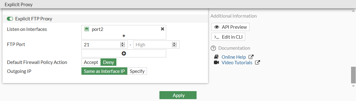

To configure explicit FTP proxy in the GUI:
  1. Enable and configure explicit FTP proxy:
    1. Go to Network > Explicit Proxy.
    2. Enable Explicit FTP Proxy.
    3. Select port2 as the Listen on Interfaces and set the HTTP Port to 21.
    4. Configure the Default Firewall Policy Action as needed.
    5. Click Apply.

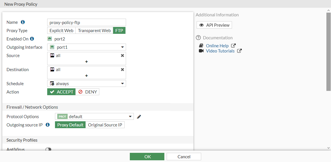

  2. Create an explicit FTP proxy policy:
    1. Go to Policy & Objects > Proxy Policy.
    2. Click Create New.
    3. Set Proxy Type to FTP and Outgoing Interface to port1.
    4. Also set Source and Destination to all, Schedule to always, and Action to ACCEPT.
    5. Click OK to create the policy.
    This example creates a basic policy. If required, security profiles can be enabled.

To configure explicit FTP proxy in the CLI:
    config ftp-proxy explicit
        set status enable
        set incoming-port 21
    config firewall proxy-policy
        edit 4
            set name "proxy-policy-ftp"
            set proxy ftp
            set dstintf "port1"
            set srcaddr "all"
            set dstaddr "all"

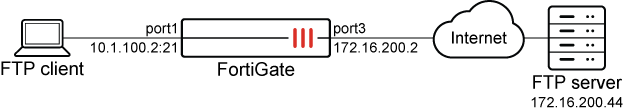

In this example, a client that only supports active mode FTP connects to a remote FTP server through the explicit FTP proxy to download a text file (test1.txt). The explicit FTP proxy converts the active FTP connection to a passive connection between the explicit FTP proxy and the FTP server.
To configure passive mode for FTP server data sessions:
