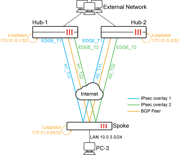

This example includes one spoke and two hubs:
  • The spoke has two overlays to Hub-1 and Hub-2 respectively.
  • BGP neighbors between the spoke and hubs are over loopback IP addresses
  • SD-WAN is configured on the spoke.

      The routes with MEDs are advertised to a router on the external network that establishes a BGP neighbor relationship with Hub-1 and Hub-2. When sending traffic destined for 10.0.3.0/24, the router on the external network will prefer to send traffic to the hub with the lower MED.

Example
To configure and test the example:
  1. Configure Hub-1:
    The Hub-2 configuration is identical except for the router-id, which reflects the different loopback IP address.

  2. Configure the spoke:
    1. Configure SD-WAN:
      config system sdwan
          set status enable
          config zone
              edit "overlay"
          config members
              edit 4
                  set interface "H1_T11"
                  set zone "overlay"
                  set source 172.31.0.65
                  set priority-in-sla 50
                  set priority-out-sla 100
              edit 5
                  set interface "H1_T22"
                  set zone "overlay"
                  set priority-in-sla 70
                  set priority-out-sla 120
              edit 7
                  set interface "H2_T11"
                  set zone "overlay"
                  set priority-in-sla 60
                  set priority-out-sla 110
              edit 8
                  set interface "H2_T22"
                  set zone "overlay"
                  set priority-in-sla 80
                  set priority-out-sla 130
          config health-check
              edit "HUB"
                  set server "172.31.100.100"
                  set embed-measured-health enable
                  set sla-id-redistribute 1
                  set sla-fail-log-period 10
                  set sla-pass-log-period 10
                  set members 4 5 7 8
                  config sla
                          set link-cost-factor latency
                          set latency-threshold 100
          config neighbor
              edit "172.31.0.1"
                  set member 4 5
                  set route-metric priority
                  set health-check "HUB"
              edit "172.31.0.2"
                  set member 7 8
    2. Configure BGP:
      config router bgp
          set as 65001
          set router-id 172.31.0.65
          config neighbor
              edit "172.31.0.1"
                  set remote-as 65001
                  set update-source "Loopback0"
              edit "172.31.0.2"
                  set remote-as 65001
          config network
                  set prefix 10.0.3.0 255.255.255.0
