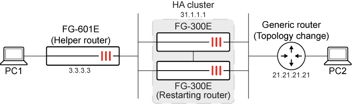

In this example, a restarting router (one of the FG-300Es in the HA cluster) informs its neighbors using grace LSAs before restarting its OSPF process. When the helper router (the FG-601E) receives the grace LSAs, it enters helper mode to help with the graceful restart until the graceful period expires. It will act as though there are no changes on the restarting router (FG-300E). A generic router simulates a topology change during the restart event.
If restart-on-topology-change is enabled on the restarting router, it will not exit the graceful restart mode even when a topology change is detected.
If restart-on-topology-change is disabled on the restarting router, it will exit graceful restart mode when a topology change is detected.
To configure the restarting router:

When restart-on-topology-change is enabled and there is a topology change during the HA OSPF graceful restart, the graceful restart will continue. The routes on the helper router (FG-601E) are still there and no traffic will drop.

When restart-on-topology-change is disabled and there is a topology change during the HA OSPF graceful restart, the graceful restart will exit. The routes on the helper router (FG-601E) are lost and traffic will drop.

No routes are lost:
# get router info routing-table ospf
Routing table for VRF=0
O       21.21.21.21/32 [110/300] via 172.16.200.31, port1, 00:04:42
O       31.1.1.1/32 [110/200] via 172.16.200.31, port1, 01:01:59
O       100.21.1.0/24 [110/200] via 172.16.200.31, port1, 00:04:42
