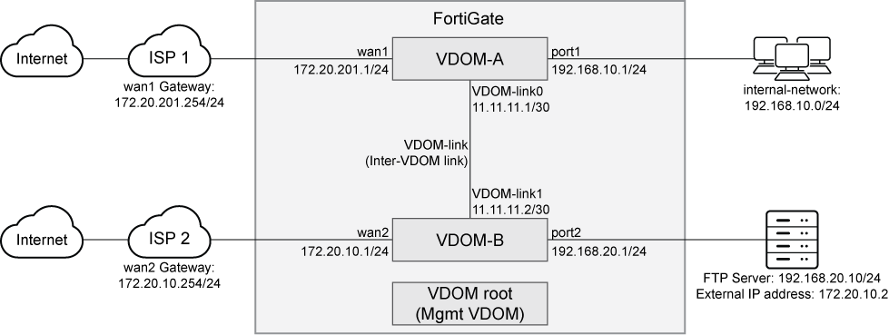

This example shows how to configure a FortiGate unit to use inter-VDOM routing to route traffic between an internal network and FTP server that are each behind separate VDOMs. See Inter-VDOM routing for more information.
The following example shows how to configure per-VDOM settings, such as operation mode, routing, and firewall policies, in a network that includes the following VDOMs:
  • VDOM-A: allows the internal network to access the Internet.
  • VDOM-B: allows external connections to an FTP server.
  • root: the management VDOM.
You can use VDOMs in either NAT or transparent mode on the same FortiGate. By default, VDOMs operate in NAT mode. In this example, both VDOM-A and VDOM-B use NAT mode. An inter-VDOM link is created and inter-VDOM routes configured to allow users on the internal network to access the FTP server.
This is an example of the partial-mesh VDOMs configuration since only VDOM-A is connected to VDOM-B but neither of those VDOMs are connected to the root VDOM. See Topologies for details.
This example assumes that the interfaces of the FortiGate have already been configured with the IP addresses depicted in the preceding diagram.

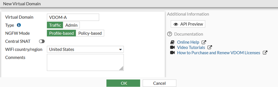

To create the VDOMs in the GUI:
  1. In the Global VDOM, go to System > VDOM.
    Click Create New.
  2. In the Virtual Domain field, enter VDOM-A.
  3. If required, set the NGFW Mode. If the NGFW Mode is Profile-based, Central SNAT can be enabled.
  4. Click OK to create the VDOM.
  5. Repeat the above steps for VDOM-B.

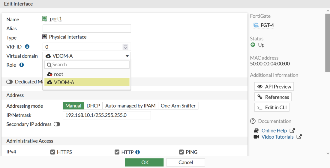

To assign interfaces to VDOMs in the GUI:
  1. In the Global VDOM, go to Network > Interfaces.
  2. Select port1 and click Edit.
  3. From the Virtual domain list, select VDOM-A.
  4. Click OK.
  5. Repeat the preceding steps to assign port2 to VDOM-B.
  6. Repeat the preceding steps to assign wan1 to VDOM-A.
  7. Repeat the preceding steps to assign wan2 to VDOM-B.

Configure the VDOM link
The VDOM link allows connections from VDOM-A to VDOM-B. The VDOM link interface configured in this step will be used for inter-VDOM routing.
This step requires you to connect to the global VDOM using a global administrator account.
To add the VDOM link in the GUI:
  2. Create New > VDOM link.
  3. Enter the following information:
    Name VDOM-link
    Interface 0
    Virtual Domain VDOM-A
    IP/Netmask
    11.11.11.1/255.255.255.252
    Interface 1
    Virtual Domain
    VDOM-B
    IP/Netmask
    11.11.11.2/255.255.255.252
  4. Click OK.
    Click Create New.
  4. Click OK.

                    set allow-routing enable
                    set subnet 192.168.20.10 255.255.255.255
  3. Add the firewall policy to VDOM-B:
    config vdom
        edit VDOM-B
            config firewall policy
                    set name "Access-server"
                    set srcintf "wan2"
                    set dstintf "port2"
                    set srcaddr "all"
                    set dstaddr "FTP-server-VIP"
                    set service "FTP"
                    set nat enable
  4. Add the static route on VDOM-A:
    config vdom
        edit VDOM-A
            config router static
                edit 0
                    set device VDOM-link0
                    set dstaddr FTP-server
                    set gateway 11.11.11.2
  5. Configure the firewall addresses on VDOM-B:
    config vdom
        edit VDOM-B
            config firewall address
                edit internal-network
                    set associated-interface VDOM-link1
                    set subnet 192.168.10.0 255.255.255.0
  6. Add the static route on VDOM-B:
    config vdom
        edit VDOM-B
                edit 0
                    set device VDOM-link1
                    set dstaddr internal-network
                    set gateway 11.11.11.1
  7. Add the security policy on VDOM-A:
    config vdom
        edit VDOM-A
                edit 0
                    set name Access-FTP-server
                    set srcintf port1
                    set dstintf VDOM-link0
                    set srcaddr internal-network
                    set schedule always
                    set service FTP
  8. Add the firewall policy on VDOM-B:
    config vdom
        edit VDOM-B
                edit 0
                    set name Internal-server-access
                    set srcintf VDOM-link1
                    set dstintf port2
                    set schedule always
                    set service FTP
