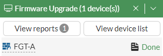

  1. After a successful upgrade, log in to the GUI, and view the Firmware Upgrade monitor in the bottom-right corner. The following buttons are available:
    • View reports <number>
      The <number> indicates how many FortiGates have an available firmware upgrade report.
    • View device list

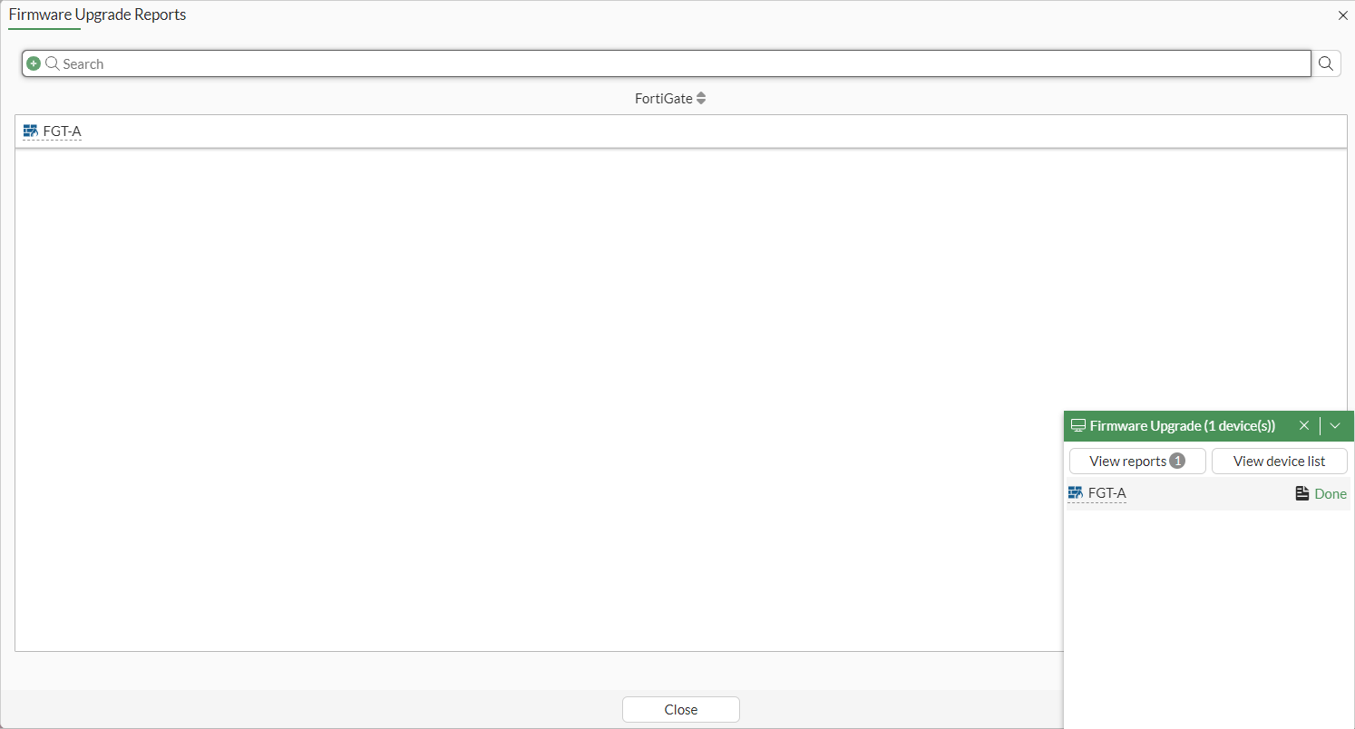

  2. Click the View reports <number> button or the document icon beside Done. A Firmware Upgrade Reports pane opens to show the list of FortiGates with an available firmware upgrade report:

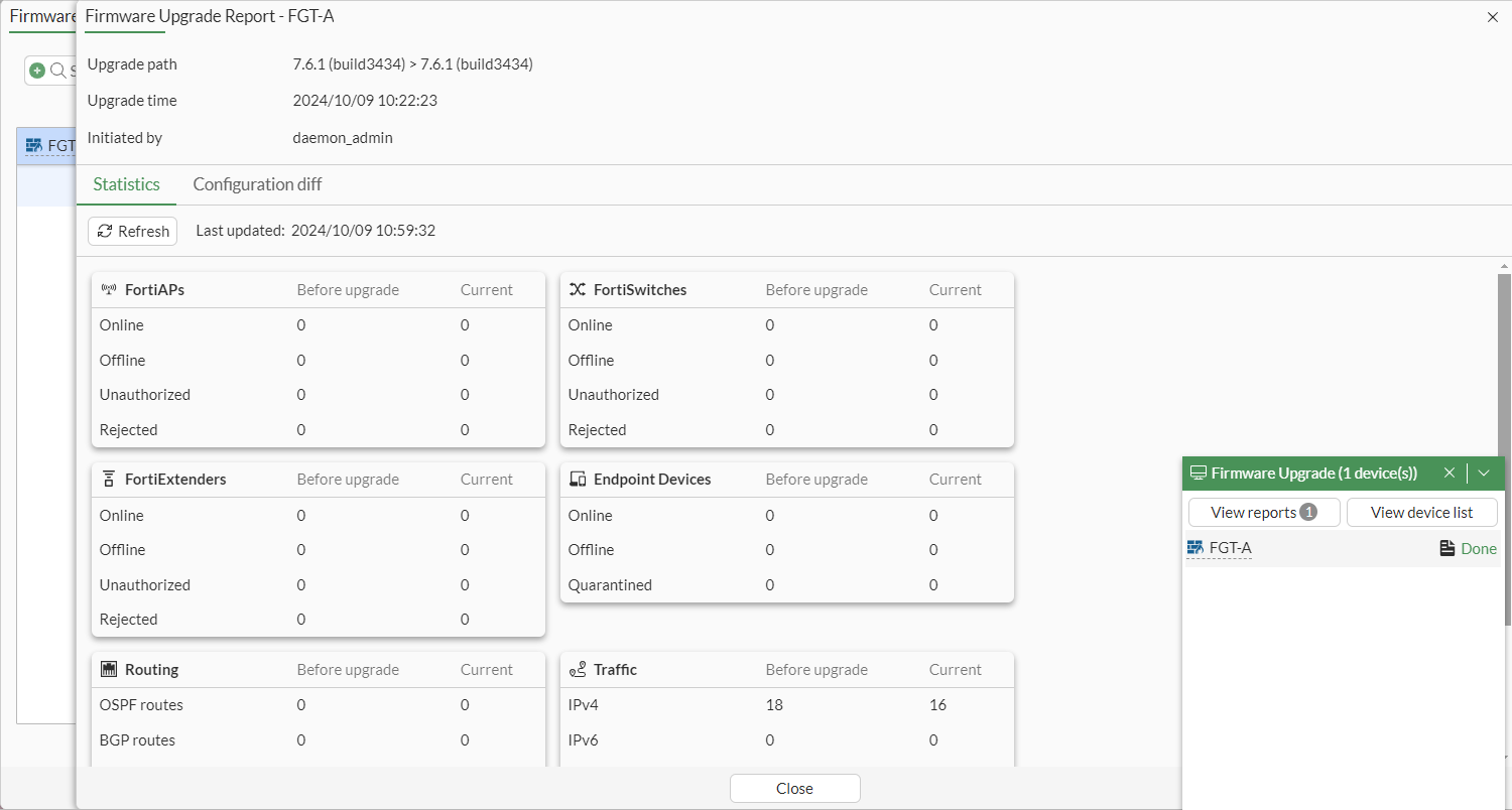

  3. Double-click a FortiGate to display its firmware upgrade report. The firmware upgrade report contains the following tabs: Statistics and Configuration diff.
    • The Statistics tab displays general information at the top about Upgrade path, Upgrade time, and Initiated by.
      Below the general section are categories of information from before and after the upgrade. The categories of information depend on whether the FortiGate is part of a Security Fabric.
      In this example, the FortiGate is not part of a Security Fabric, and the following categories of information are displayed: FortiAPs, FortiSwitches, FortiExtenders, Endpoint Devices, Routing, Traffic, Connectivity, and Resources.
    • Click Refresh to retrieve the latest current statistics.

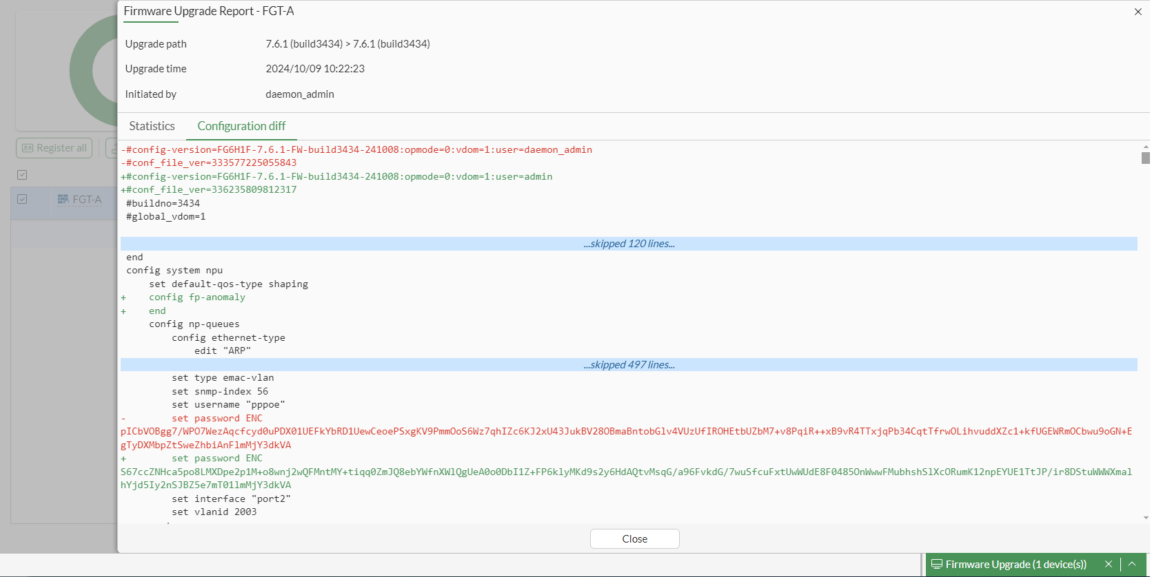

    • Click the Configuration diff tab to display a comparison of the current (green) and previous (red) configurations.

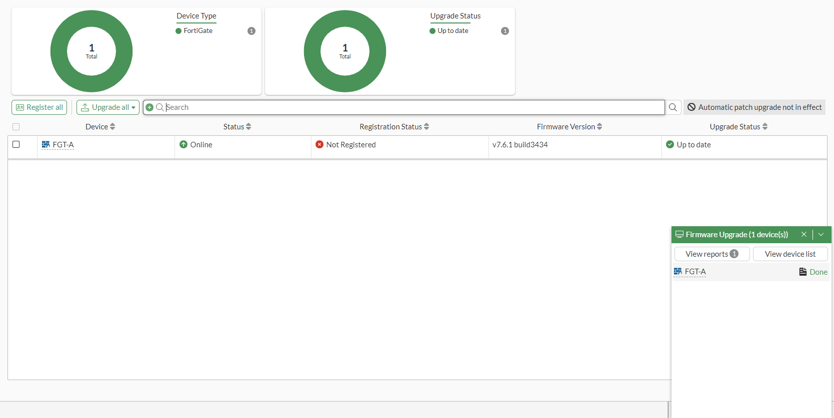

  4. In the Firmware Upgrade monitor, click View device list to display the Firmware & Registration pane.
