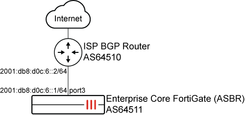

In this example, Enterprise Core FortiGate peers with the ISP BGP Router over eBGP to receive a default route.
Topology
The following topology is used for this example:
Please note that the IPv6 addresses used in this example are for illustrative purposes only and should not be used in your environment.
The 2001:db8::/32 prefix is a special IPv6 prefix designated for use in documentation examples. See RFC 3849 for more information.
Please note that the Autonomous System Numbers (ASN) used in this example are reserved for documentation use only and should not be used in your environment. See RFC 5398 for more information.
