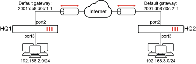

In this example, two private networks with IPv4 addressing communicate securely over IPv6 infrastructure.
The following topology is used for this example:
  • Port2 connects to the IPv6 public network and port3 connects to the IPv4 local network.
  • HQ1 port2 IPv6 address is 2001:db8:d0c:1::e and port3 IPv4 address is 192.168.2.1.
  • HQ2 port2 IPv6 address is 2001:db8:d0c:2::e and port3 IPv4 address is 192.168.3.1.
Please note that the IPv6 addresses used in this example are for illustrative purposes only and should not be used in your environment.
The 2001:db8::/32 prefix is a special IPv6 prefix designated for use in documentation examples. See RFC 3849 for more information.

Site-to-site IPv4 over IPv6 VPN example
To configure the example in the GUI:
  1. Configure the HQ1 FortiGate.
    1. Configure the IPv6 address on port2 and IPv4 address on port3:
      1. Go to Network > Interfaces and edit port2.
      2. Set IPv6 addressing mode to Manual and enter the IPv6 Address/Prefix.
        IPv6 Address/Prefix 2001:db8:d0c:1::e/64
      3. Click OK.
      4. Go to Network > Interfaces and edit port3.
      5. Set Addressing mode to Manual and enter the IP/Netmask.
        IP/Netmask 192.168.2.1/24
    2. Configure IPsec settings:
      1. Go to VPN > IPsec Wizard and enter a VPN name.
      2. Set Template type to Custom.
      3. Click Next.
      4. Configure the following Network settings:
        IP Version IPv6
        Remote Gateway Static IP Address
        IP Address 2001:db8:d0c:2::e
