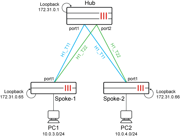

When ADVPN 2.0 was introduced, path management between spokes was enhanced to enable each spoke to learn the links from other spokes and use the information to more efficiently build shortcuts. When applied to a service rule that utilizes SLA mode with load-balancing, SD-WAN attempts to build all possible shortcuts using priority members in the service rule and overlays learned from the peer spoke. All created shortcuts use unique underlay paths. Once shortcuts are created on all distinct underlay paths, user traffic is load-balanced between in-SLA shortcuts, rather than between in-SLA shortcuts and parents.
Example
In this example with one hub and two spokes, each spoke has one underlay link, and the hub has two underlay links. For redundancy, each spoke builds two overlays to hub:
In a service rule named Corporate-H1 on Spoke-1, both H1_T11 and H1_T22 are named as priority members for this load-balancing rule. Likewise, Spoke-2 has two overlay paths to the hub. Instead of creating 2x2 shortcut paths based on the overlays, this enhancement identifies the single unique underlay path over port1 and creates a shortcut on this path.
This section reviews the following settings to demonstrate how the ADVPN 2.0 enhancement works:

  2. Initiate a ping from PC1 to PC2 to match SLA load-balance service 1 on Spoke-1. This initiates the shortcut path negotiations.
    Instead of triggering all four possible shortcuts on all four overlay paths:
    • local H1_T11 -- remote H1_T11
    • local H1_T11 -- remote H1_T22
    • local H1_T22 -- remote H1_T11
    • local H1_T22 -- remote H1_T22
    Only one shortcut is triggered on the distinct underlay path between two spokes:
    • local port1 -- remote port1

Example shortcut over distinct underlay path using ADVPN 2.0
Example
    On spoke-1:
    A bigger gid value (33554434) is assigned to the shortcut, resulting in this path being the preferred for service rule 1.
