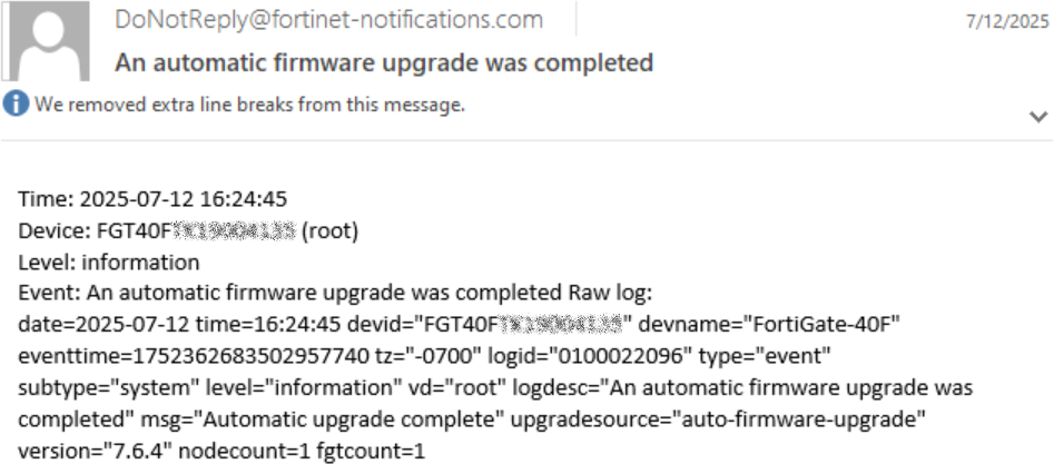

Upgrade logs IDs have been added to distinguish between automatic and manual upgrades, and email alerts include detailed status updates. Logs are triggered when auto-upgrade is enabled or disabled, a new firmware is detected, and when the upgrade completes or fails. After disabling auto-upgrade and performing an update, the login GUI prompts users to manually confirm their auto-upgrade preference.
New log IDs:
  • Log ID 22096: Auto-upgrade completed successfully
    date=2026-02-04 time=16:26:00 id=7603170842209419270 itime="2026-02-04 16:26:01" euid=3 epid=3 dsteuid=3 dstepid=3 logflag=0 logver=800000123 logid=0100022096 type="event" subtype="system" level="information" msg="Automatic upgrade complete" logdesc="An automatic firmware upgrade was completed" version="8.0.0" eventtime=1770251160711843738 tz="-0800" nodecount=1 fgtcount=1 upgradesource="auto-firmware-upgrade" devid="FGVM<serial number>" vd="root" csf="csf_97_vdom" dtime="2026-02-04 16:26:00" itime_t=1770251161 devname="FGT-97-vdom-209"

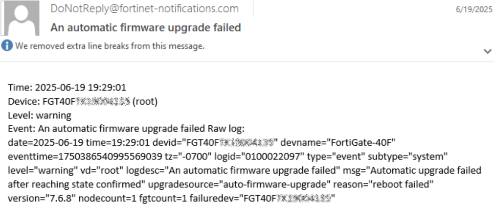

  • Log ID 22097: Auto-upgrade failed
    date=2025-07-12 time=18:12:58 eventtime=1752369177089407840 tz="-0700" logid="0100022097" type="event" subtype="system" level="warning" vd="root" logdesc="An automatic firmware upgrade failed" msg="Automatic upgrade failed after reaching state confirmed" upgradesource="auto-firmware-upgrade" reason="firmware changed" version="7.6.7" nodecount=1 fgtcount=1 failuredev="FGT40F0000000000"

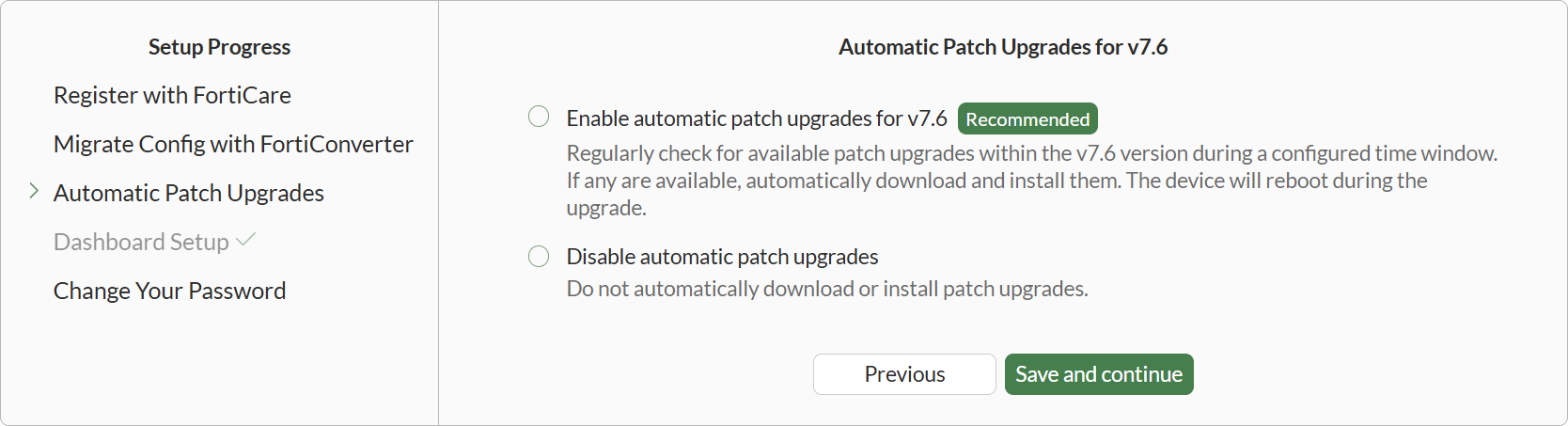

Login prompt:
  • When auto-upgrade is disabled, no option is preselected in the setup wizard and Enable is marked as recommended. Enable or Disable must be selected to proceed.
  • When auto-upgrade is enabled, Enable is pre-selected.

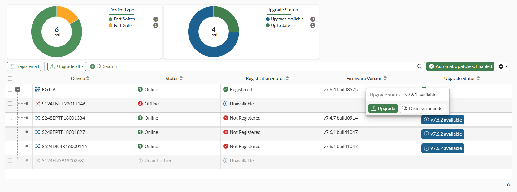

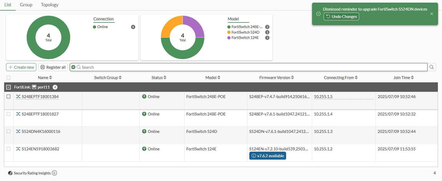

To dismiss extension device upgrade notifications in the GUI:
  1. Go to System > Firmware & Registration.
    The recommended upgrade notifications are shown in the Upgrade Status column.

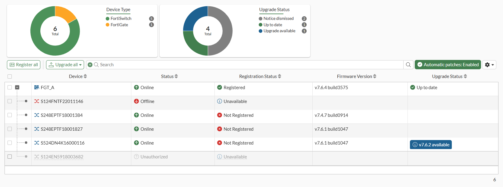

  2. Hover over a notification and click Dismiss reminder to remove the notification.
    The page refreshes and the notification is no longer displayed.

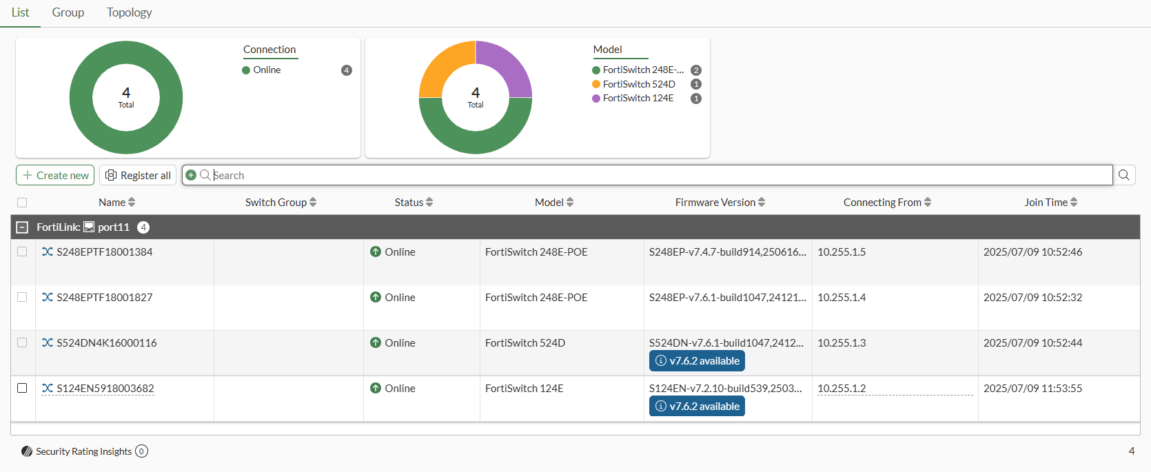

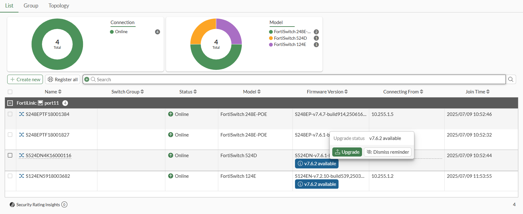

  3. Go to WiFi & Switch Controller > Managed FortiSwitches.
    The notification is also no longer displayed on the page.
  4. Hover over a notification on this page and click Dismiss reminder to remove the notification.
