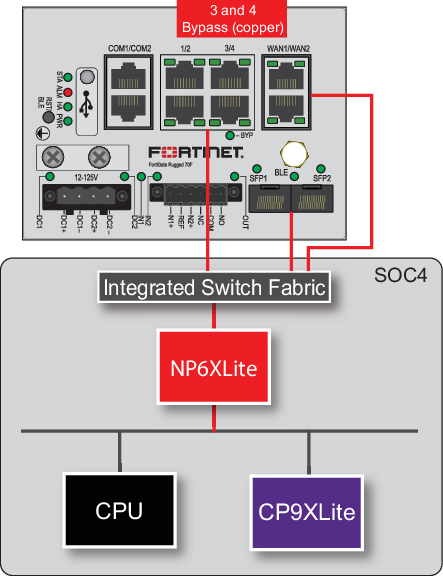

FortiGate Rugged 70F fast path architecture
The FortiGate Rugged 70F includes the SOC4 and uses the SOC4 CPU, NP6XLite processor, and CP9XLite processor. The SOC4 includes an integrated switch fabric (ISF) that connects all of the front panel network interfaces to the NP6XLite processor. All data traffic passes from the data interfaces through the ISF to the NP6XLite processor. All supported traffic passing between any two data interfaces can be offloaded by the NP6XLite processor. Data traffic processed by the CPU takes a dedicated data path through the ISF and the NP6XLite processor to the CPU.
The FortiGate Rugged 70F includes the SOC4 and uses the SOC4 CPU, NP6XLite processor, and CP9XLite processor. The SOC4 ISF connects all of the FortiGate Rugged 70F front panel data interfaces to the NP6XLite processor.
The 3 and 4 interfaces form a copper bypass pair. On the GUI and CLI these interfaces are is named lan3 and lan4.

Bypass interfaces (3 and 4)
The FortiGate Rugged 70F includes a bypass interface pair, 3 and 4, that provides fail open support. When a FortiGate Rugged 70F experiences a hardware failure or loses power, or when bypass mode is enabled, the bypass interface pair operates in bypass mode. In bypass mode, 3 and 4 are directly connected. Traffic can pass between 3 and 4 bypassing the FortiOS firewall and the NP6XLite processor, but continuing to provide network connectivity.
In bypass mode, the bypass pair acts like a patch cable, failing open and allowing all traffic to pass through. Traffic on the bypass interface that is using VLANs or other network extensions can only continue flowing if the connected network equipment is configured for these features.
The FortiGate Rugged 70F will continue to operate in bypass mode until the failed FortiGate Rugged 70F is replaced, power is restored, or bypass mode is disabled. If power is restored or bypass mode is disabled, the FortiGate Rugged 70F resumes operating as a FortiGate device without interrupting traffic flow. Replacing a failed FortiGate Rugged 70F disrupts traffic as a technician physically replaces the failed FortiGate Rugged 70F with a new one.
