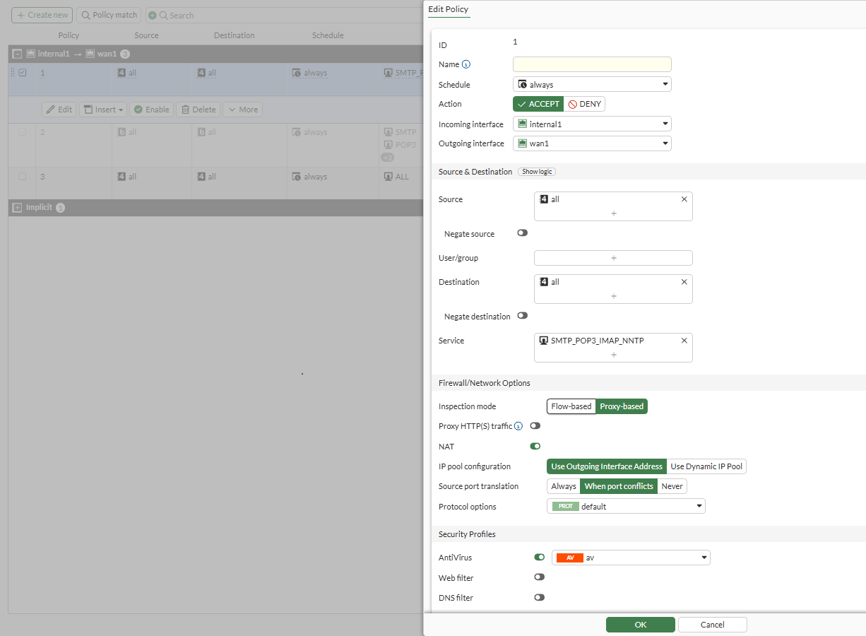

The following screen shot shows a firewall policy correctly configured with email/NNTP services, proxy-based inspection mode, and a proxy UTM profile:
  • Service is set to SMTP_POP3_IMAP_NNTP.
  • Inspection mode is set to Proxy-based.
  • Protocol Options is set to the default profile.
  • Under Security Profiles, AntiVirus is enabled, and the av profile is selected.
  • SSL Inspection is set to the deep-inspection profile.
Conclusion: Because the Service defined contains only mail protocols, this configuration is accepted.

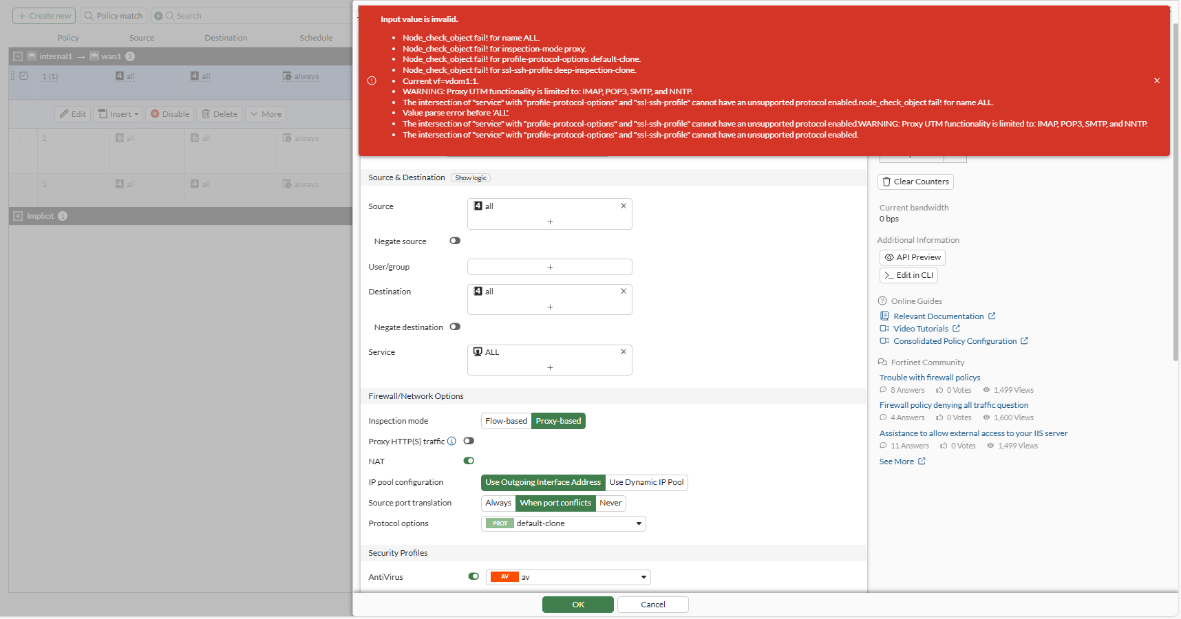

The following GUI example shows the warning message that displays with an unsupported firewall policy configuration:
  • Service is set to ALL.
    The ALL setting includes ports, such as 80 and 443, that are used for protocols other than the supported email protocols of SMTP, POP3, IMAP, and NNTP.
  • Protocol Options is set to the default-clone profile, which inspects HTTP.
  • SSL Inspection is set to the deep-inspection-clone profile, which inspects HTTP.
Conclusion: Between the Service selected, the Protocol Options, and SSL Inspection profile, all three include inspection on non-mail protocols.

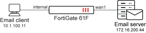

In this example, a firewall policy is configured to scan email traffic sent from an email client through FortiGate to an email server. The firewall policy is configured with a proxy-based inspection mode and mail services and profiles. The FortiGate 61F has less than 2 GB RAM.
