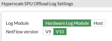

From the GUI:
  1. Go to Log & Report > Hyperscale SPU Offload Log Settings.
  2. Set Log Module to:
    • Hardware Log Module to use NP7 processors for hardware logging.
    • Host to use the CPU for hardware logging. If you select Host you cannot change the NetFlow version.
  3. If Log Module is set to Hardware Log Module you can select the Netflow version to V9 or V10.
  4. Select Apply to save your changes.
