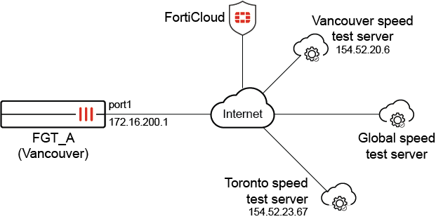

Example 1: executing a speed test without specifying the interface, server, and mode
Geographically, the Vancouver server (154.52.20.6) has the smallest latency (around 7 ms) to FGT_A, so it will be automatically selected for the speed test because the latency 7 ms to 154.52.20.6 is less than the default latency-threshold of 60 ms. Meanwhile, four TCP connections will be initiated to perform the test since the default multiple-tcp-stream is 4.

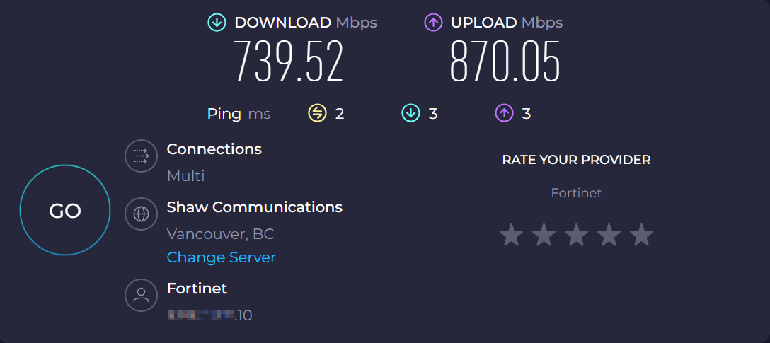

Example 5: executing multiple speed tests with TCP and UDP connections
A speed test is executed to the closest server using 64 TCP connections and another speed test is executed using one UDP connection. The results can be checked with a third-party platform (such as Ookla), which returns comparable results.
