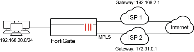

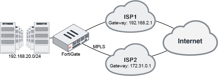

In this example, SD-WAN neighbors that are not bound to primary and secondary roles are configured.
The FortiGate has multiple SD-WAN links and has formed BGP neighbors with both ISPs.
ISP1 is used primarily for outbound traffic, and has an SD-WAN service rule using the lowest cost algorithm applied to it. When SLAs for ISP1 are not met, it will fail over to the MPLS line.
Inbound traffic is allowed by both WAN links, with each WAN advertising a community string when SLAs are met. When SLAs are not met, the WAN links advertise a different community string.
This example uses two SD-WAN links. The topology can be expanded to include more links as needed.
