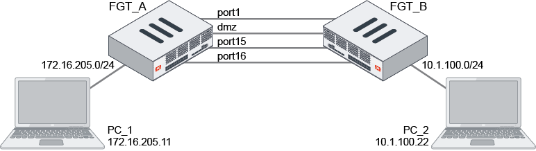

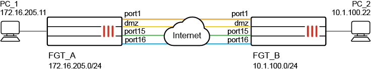

In this example, four SD-WAN members in two zones are configured. The remote PC (PC_2 - 10.1.100.22) is accessible on port15 and port16, even though there are valid routes for all of the SD-WAN members. A single SD-WAN service rule is configured that allows traffic to balanced between all four of the members, but only chooses between port15 and port16 for the specific 10.1.100.22 address.
A performance SLA health check is configured to monitor 10.1.100.2. An SD-WAN service rule in Lowest Cost (SLA) mode is configured to select the best interface to steer the traffic. In the rule, the method of selecting a member if more than one meets the SLA (tie-break) is configured to select members that meet the SLA and match the longest prefix in the routing table (fib-best-match). If there are multiple ECMP routes with the same destination, the FortiGate will take the longest (or best) match in the routing table, and choose from those interface members.
