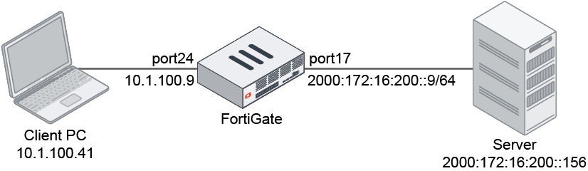

In this example, a client PC is using IPv4 and an IPv4 VIP to access a server that is using IPv6. The FortiGate uses NAT46 to translate the request from IPv4 to IPv6 using the virtual interface naf.root. An ippool6 is applied so that the request is SNATed to the ippool6 address (2000:172:16:101::1 - 2000:172:16:101::1).

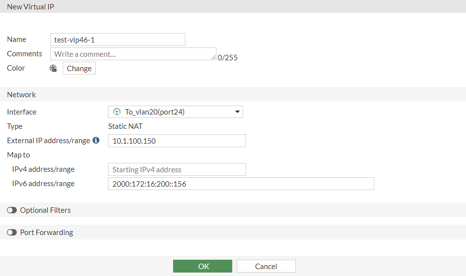

- Configure the VIP:
- Go to Policy & Objects > Virtual IPs and select the Virtual IP tab.
- Click Create new.
- Enter the following:
Name
test-vip46-1
Interface
To_vlan20
Type
Static NAT
External IP address/range
10.1.100.150
Map to IPv6 address/range
2000:172:16:200::156
- Click OK.

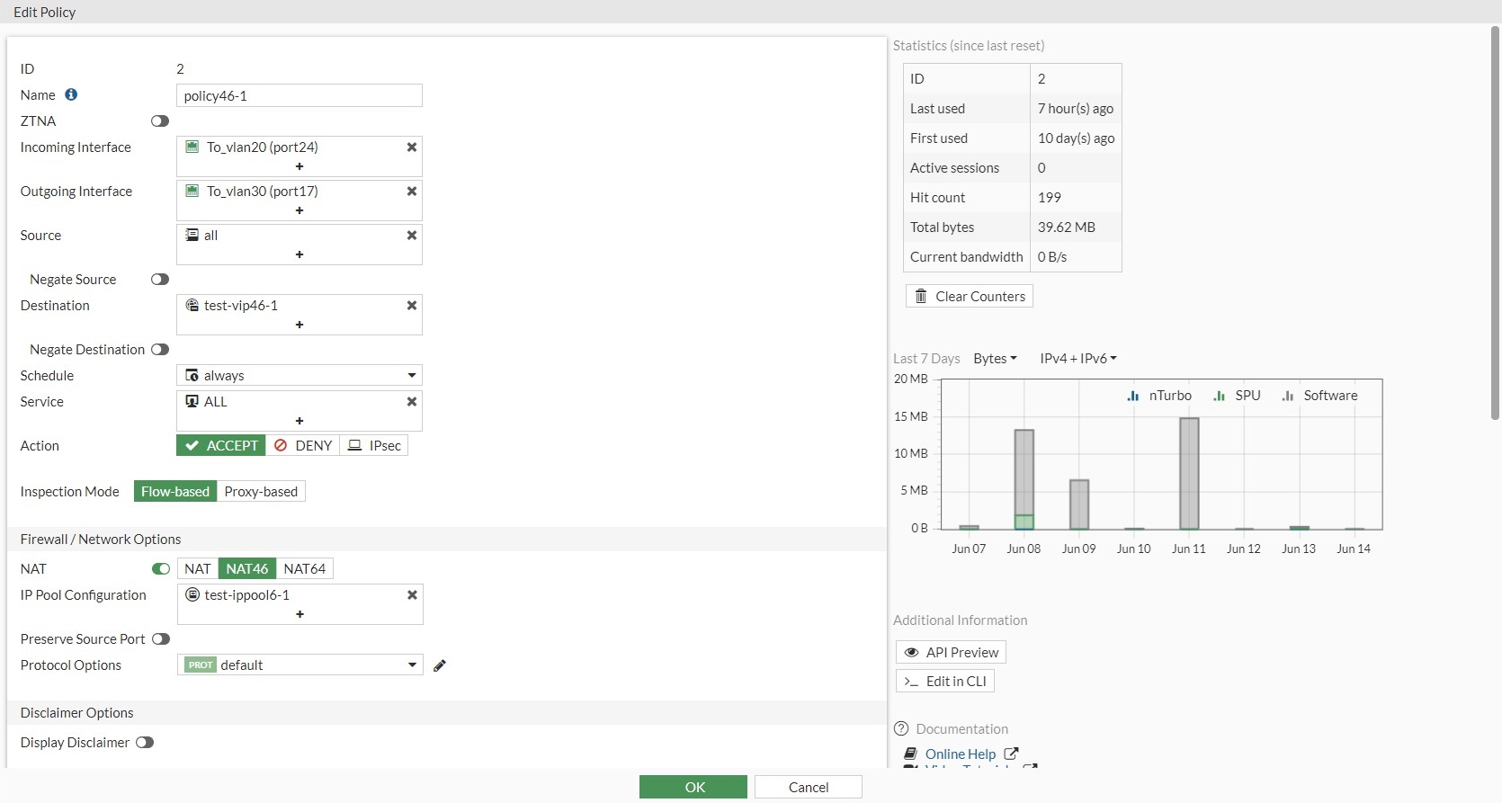

- Configure the firewall policy:
- Go to Policy & Objects > Firewall Policy and click Create New or edit an existing policy.
Name
policy46-1
Incoming Interface
To_vlan20
Outgoing Interface
To_vlan30
Source
all
Destination
test-vip46-1
Schedule
always
Service
ALL
Action
ACCEPT
NAT
NAT46
IP Pool Configuration
test-ippool6-1
- Configure the other settings as needed.
- Click OK.

config firewall vip edit "test-vip46-1" set extip 10.1.100.150 set nat44 disable set nat46 enable set extintf "port24" set arp-reply enable set ipv6-mappedip 2000:172:16:200::156 next end - Configure the IPv6 pool:

config firewall policy edit 2 set name "policy46-1" set srcintf "port24" set dstintf "port17" set action accept set nat46 enable set srcaddr "all" set dstaddr "test-vip46-1" set srcaddr6 "all" set dstaddr6 "all" set schedule "always" set service "ALL" set logtraffic all set auto-asic-offload disable set ippool enable set poolname6 "test-ippool6-1" next end

The IPv4 session is between the incoming physical interface port24 and naf.root. The IPv6 session is between the naf.root and the outgoing physical interface port17.

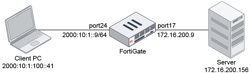

In this example, a client PC is using IPv6 and an IPv6 VIP to access a server that is using IPv4. The FortiGate uses NAT64 to translate the request from IPv6 to IPv4 using the virtual interface naf.root. An ippool is applied so that the request is SNATed to the ippool address (172.16.101.2 - 172.16.101.3).
An embedded VIP64 object is used in this configuration so a specific IPv4 mapped IP does not need to be set. The lower 32 bits of the external IPv6 address are used to map to the IPv4 address. Only an IPv6 prefix is defined. In this example, the IPv6 prefix is 2001:10:1:100::, so the IPv6 address 2001:10:1:100::ac10:c89c will be translated to 172.16.200.156.

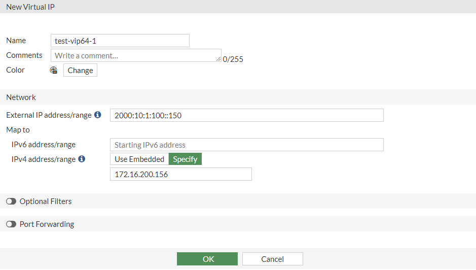

- Go to Policy & Objects > Virtual IPs and select the IPv6 Virtual IP tab.
- Click Create new.
Name
test-vip64-1
2000:10:1:100::150
Map to IPv4 address/range
Specify: 172.16.200.156
- Click OK.

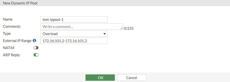

- Configure the IP pool:
- Go to Policy & Objects > IP Pools and select the IP Pool tab.
- Click Create new.
Name
test-ippool4-1
Type
Overload
172.16.101.2-172.16.101.3
NAT64
Enable
- Click OK.

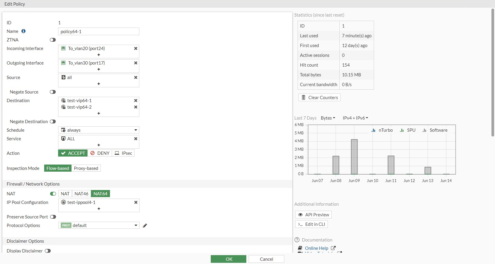

Name
policy64-1
Incoming Interface
To_vlan20
Outgoing Interface
To_vlan30
Source
all
Destination
test-vip64-1
test-vip64-2
Schedule
always
Service
ALL
Action
ACCEPT
NAT
NAT64
test-ippool4-1
- Click OK.

config firewall vip6 edit "test-vip64-1" set extip 2000:10:1:100::150 set nat66 disable set nat64 enable set ipv4-mappedip 172.16.200.156 next end - Configure the VIP with the embedded IPv4 address enabled:

config firewall ippool edit "test-ippool4-1" set startip 172.16.101.2 set endip 172.16.101.3 set nat64 enable set add-nat64-route enable next end - Configure the firewall policy:
config firewall policy edit 1 set name "policy64-1" set srcintf "port24" set dstintf "port17" set action accept set nat64 enable set srcaddr "all" set dstaddr "all" set srcaddr6 "all" set dstaddr6 "test-vip64-1" "test-vip64-2" set schedule "always" set service "ALL" set logtraffic all set auto-asic-offload disable set ippool enable set poolname "test-ippool4-1" next end
