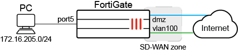

Example for application category
In this example, traffic steering is applied to traffic detected as video/audio (category ID 5) or email (category ID 21) and applies the lowest cost (SLA) strategy to this traffic. When costs are tied, the priority goes to member 1, dmz.

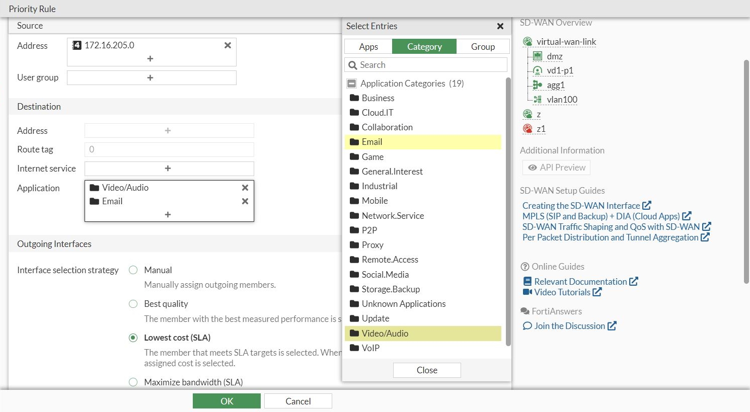

To configure application categories as an SD-WAN rule destination in the GUI:
Enable the feature visibility:
Go to System > Feature Visibility.
In the Additional Features section, enable Application Detection Based SD-WAN.
Click Apply.
To enable GUI visibility of application detection based SD-WAN in the CLI:
config system global set gui-app-detection-sdwan enable end -
Configure the SD-WAN members:
Go to Network > SD-WAN, select the SD-WAN Zones tab, and click Create New > SD-WAN Member.
Set the Interface to dmz, and set the Gateway to 172.16.208.2.
Click OK.
Repeat these steps to create another member for the vlan100 interface with gateway 172.16.206.2.
Configure the performance SLA (health check):
Go to Network > SD-WAN, and select the Performance SLAs tab, and click Create New.
Configure the following settings:
Name
1
Protocol
DNS
Server
8.8.8.8
SLA Target
Enable
Click OK.
Configure the SD-WAN rule to use the video/audio and email application categories:
Go to Network > SD-WAN, select the SD-WAN Rules tab, and click Create New.
In the Destination section, click the + in the Application field.
Click Category, and select Video/Audio and Email.
Configure the other settings as needed.
Click OK.

To configure application categories as an SD-WAN rule destination in the CLI:
- Configure the SD-WAN settings:
config system sdwan set status enable config zone edit "virtual-wan-link" next end config members edit 1 set interface "dmz" set gateway 172.16.208.2 next edit 2 set interface "vlan100" set gateway 172.16.206.2 next end config health-check edit "1" set server "8.8.8.8" set protocol dns set members 0 config sla edit 1 next end next end end - Configure the SD-WAN rule to use application categories 5 and 21:
config system sdwan config service edit 1 set name "1" set mode sla set src "172.16.205.0" set internet-service enable set internet-service-app-ctrl-category 5 21 config sla edit "1" set id 1 next end set priority-members 1 2 next end end - Configure the firewall policy:
config firewall policy edit 1 set srcintf "port5" set dstintf "virtual-wan-link" set action accept set srcaddr 172.16.205.0 set dstaddr "all" set schedule "always" set service "ALL" set utm-status enable set ssl-ssh-profile "certificate-inspection" set application-list "g-default" next end
To test the configuration:
- Verify that the traffic is sent over dmz:
# diagnose firewall proute list list route policy info(vf=root): id=2133590017(0x7f2c0001) vwl_service=1(1) vwl_mbr_seq=1 2 dscp_tag=0xff 0xff flags=0x0 tos=0x00 tos_mask=0x00 protocol=0 sport=0-65535 iif=0 dport=1-65535 path(2) oif=5(dmz) oif=95(vlan100) source(1): 172.16.205.0-172.16.205.255 destination wildcard(1): 0.0.0.0/0.0.0.0 internet service(2): (null)(0,5,0,0,0) (null)(0,21,0,0,0) hit_count=469 last_used=2021-12-15 15:06:05
- View some videos and emails on the PC, then verify the detected application details for each category:
# diagnose sys sdwan internet-service-app-ctrl-category-list 5 YouTube(31077 4294838537): 142.250.217.110 6 443 Wed Dec 15 15:39:50 2021 YouTube(31077 4294838537): 173.194.152.89 6 443 Wed Dec 15 15:37:20 2021 YouTube(31077 4294838537): 173.194.152.170 6 443 Wed Dec 15 15:37:37 2021 YouTube(31077 4294838537): 209.52.146.205 6 443 Wed Dec 15 15:37:19 2021
# diagnose sys sdwan internet-service-app-ctrl-category-list 21 Gmail(15817 4294836957): 172.217.14.197 6 443 Wed Dec 15 15:39:47 2021
- Verify that the captured email traffic is sent over dmz:
# diagnose sniffer packet any 'host 172.217.14.197' 4 interfaces=[any] filters=[host 172.217.14.197] 5.079814 dmz out 172.16.205.100.60592 -> 172.217.14.197.443: psh 2961561240 ack 2277134591
- Edit the SD-WAN rule so that dmz has a higher cost and vlan100 is preferred.
- Verify that the traffic is now sent over vlan100:
# diagnose firewall proute list list route policy info(vf=root): id=2134048769(0x7f330001) vwl_service=1(1) vwl_mbr_seq=2 1 dscp_tag=0xff 0xff flags=0x0 tos=0x00 tos_mask=0x00 protocol=0 sport=0-65535 iif=0 dport=1-65535 path(2) oif=95(vlan100) oif=5(dmz) source(1): 172.16.205.0-172.16.205.255 destination wildcard(1): 0.0.0.0/0.0.0.0 internet service(2): (null)(0,5,0,0,0) (null)(0,21,0,0,0) hit_count=635 last_used=2021-12-15 15:55:43
# diagnose sniffer packet any 'host 172.217.14.197' 4 interfaces=[any] filters=[host 172.217.14.197] 304.625168 vlan100 in 172.16.205.100.60592 -> 172.217.14.197.443: psh 2961572711 ack 2277139565
