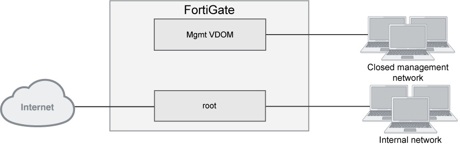

Management VDOM
By default, the management VDOM is root. The management VDOM can be manually assigned from the GUI or the CLI.
To assign the management VDOM in the GUI:
  1. In the Global VDOM, go to System > VDOM.
  2. Select the VDOM you want to assign as the management VDOM.
  3. Click Switch Management.
  4. Click OK.
To assign the management VDOM in the CLI:
config global
    config system global
        set management-vdom <vdom>
Only one management VDOM can exist at a time. It is strongly recommended that the management VDOM have Internet access otherwise management-related services, such as FortiGuard updates and queries, will not work.

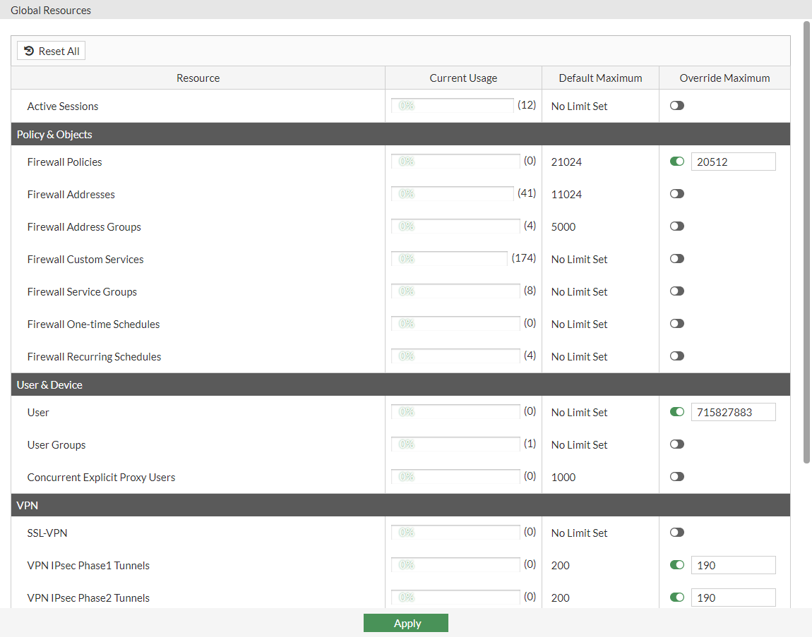

Global and per-VDOM resources
Global resources apply to resources that are shared by the whole FortiGate, while per-VDOM resources are specific to each VDOM.
To configure global resources:
  1. In the Global VDOM, go to System > Global Resources.
  2. Enable the resource's override in the Override Maximum column, then enter the override value.
  3. Click Apply.
    To reset all of the override values, click Reset All.

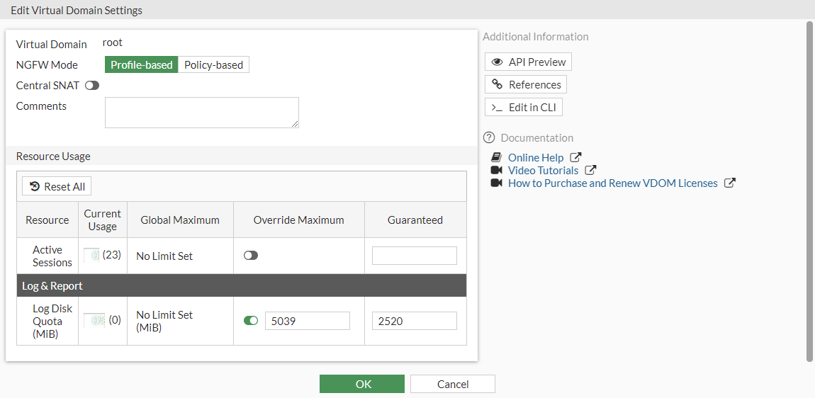

To configure per-VDOM resources:
  2. Select the VDOM whose resources need to be configured and click Edit.
  3. Enable the resource's override in the Override Maximum column, then enter the override value.
  4. Optionally, enter a value in the Guaranteed column.
  5. Click OK.

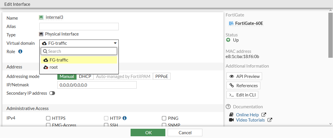

Assign interfaces to a VDOM
An interface can only be assigned to one of the VDOMs. An interface cannot be moved if it is referenced in an existing configuration.
Tooltip
In the GUI, the interface list Ref. column shows if the interface is referenced in an existing configuration, and allows you to quickly access and edit those references.
To assign an interface to a VDOM in the GUI:
  1. In the Global VDOM, go to Network > Interfaces.
  2. Select the interface that will be assigned to a VDOM and click Edit.
  3. Select the VDOM that the interface will be assigned to from the Virtual Domain list.
  4. Click OK.
To assign an interface to a VDOM using the CLI:
config global
    config system interface
        edit <interface>
            set vdom <VDOM_name>

Allow FortiGuard services and updates to initiate from a traffic VDOM
In multi VDOM mode, users can choose from which VDOM FortiGuard services and updates are initiated from, instead of being locked to the management VDOM. This allows deployment scenarios where the management VDOM resides in a closed management network.
When the management VDOM resides in a closed network, it does not have internet access. FortiGuard services (FortiGuard updates, web filters, DNS proxy, DDNS, and so on) must be configured in a VDOM with Internet access in order to work. Therefore, in the example above, change the FortiGuard settings to initiate from the root VDOM.
To configure FortiGuard services on a traffic VDOM:
  1. Set up a traffic VDOM for FortiGuard services:
    config global
        config system fortiguard
            set vdom "root"
  2. Ensure the traffic VDOM has the correct gateway to reach the internet:
    config vdom
        edit root
            config router static
                    set gateway 172.16.200.254
                    set device "wan1"
  3. Configure the DNS servers to ensure the FortiGuard services can resolve the server name through the traffic VDOM:
    config vdom
        edit root
            config system vdom-dns
                set vdom-dns enable
                set primary 208.91.112.53
                set secondary 208.91.112.52
