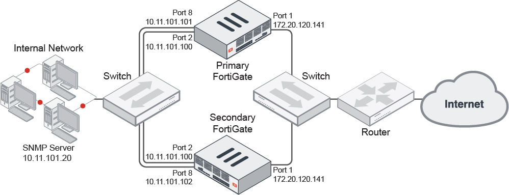

The configuration examples below will use the following topology:
Two FortiGate units are already operating in a cluster. On each unit, port8 is connected to the internal network through a switch and configured as an out-of-band reserved management interface.

Administrative access and default route for HA management interface
To configure the primary unit's reserved management interface, configure an IP address and management access on port8. Then, configure the necessary HA settings to enable the HA reserved management interface and its route. To configure the secondary unit's reserved management interface, access the unit's CLI through the primary unit, and configure an IP address, management access on port8, and the necessary HA settings. Configuration changes to the reserved management interface are not synchronized to other cluster units.
To configure the primary unit reserved management interface to allow HTTPS, SSH, and ICMP access:
From a computer on the internal network, connect to the CLI at 10.11.101.100 on port2.
Change the port8 IP address and management access:
config system interface edit port8 set ip 10.11.101.101/24 set allowaccess https ping ssh next end
Configure the HA settings for the HA reserved management interface by defining a default route to route to the gateway 10.11.101.2:
config system ha set ha-mgmt-status enable config ha-mgmt-interfaces edit 1 set interface port8 set gateway 10.11.101.2 next end end
You can now log into the primary unit's GUI by browsing to https://10.11.101.101. You can also log into the primary unit's CLI by using an SSH client to connect to 10.11.101.101.
To configure secondary unit reserved management interfaces to allow HTTPS, SSH, and ICMP access:
From a computer on the internal network, connect to the primary unit's CLI.
Connect to the secondary unit with the following command:
execute ha manage <unit id> <username> <password>
config system interface edit port8 set ip 10.11.101.102/24 set allowaccess https ping ssh next end
exit
You can now log into the secondary unit's GUI by browsing to https://10.11.101.102. You can also log into the secondary unit's CLI by using an SSH client to connect to 10.11.101.102.
