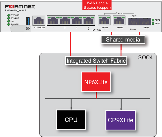

FortiGate Rugged 60F fast path architecture
The FortiGate Rugged 60F includes the SOC4 and uses the SOC4 CPU, NP6XLite processor, and CP9XLite processor. The SOC4 includes an integrated switch fabric (ISF) that connects all of the front panel network interfaces to the NP6XLite processor. All data traffic passes from the data interfaces through the ISF to the NP6XLite processor. All supported traffic passing between any two data interfaces can be offloaded by the NP6XLite processor. Data traffic processed by the CPU takes a dedicated data path through the ISF and the NP6XLite processor to the CPU.
Interfaces SFP1 and WAN1 and SFP2 and WAN2 are shared SFP or Ethernet interfaces. Only one of each of these interface pairs can be connected to a network. This allows you to, for example, connect SFP1 to an SFP switch and WAN2 to 10/100/1000BASE-T Copper switch.
The WAN1 and 4 interfaces form a copper bypass pair. The SFP1 interface is not part of the bypass pair. On the GUI and CLI the 4 interface is named internal4.
The FortiGate Rugged 60F features the following front panel interfaces:
- Four 10/100/1000BASE-T Copper (1-4) connected to the SOC4.
- Two 10/100/1000BASE-T Copper (WAN1 and WAN2) connected to the SOC4.
- Two 1GigE SFP interfaces (SFP1 and SFP2) connected to the SOC4.
The SOC4 ISF allows you to use the command config system virtual-switch to create a virtual hardware switch that can include any front panel interface connected to the SOC4.

You can use the command diagnose npu np6xlite port-list to display the FortiGate Rugged 60F NP6XLite configuration.
Chip XAUI Ports Max Cross-chip
Speed offloading
np6xlite_0
6 wan1 1000M NO
2 wan2 1000M NO
14 internal1 1000M NO
15 internal2 1000M NO
16 internal3 1000M NO
17 internal4 1000M NO
Bypass interfaces (WAN1 and 4)
